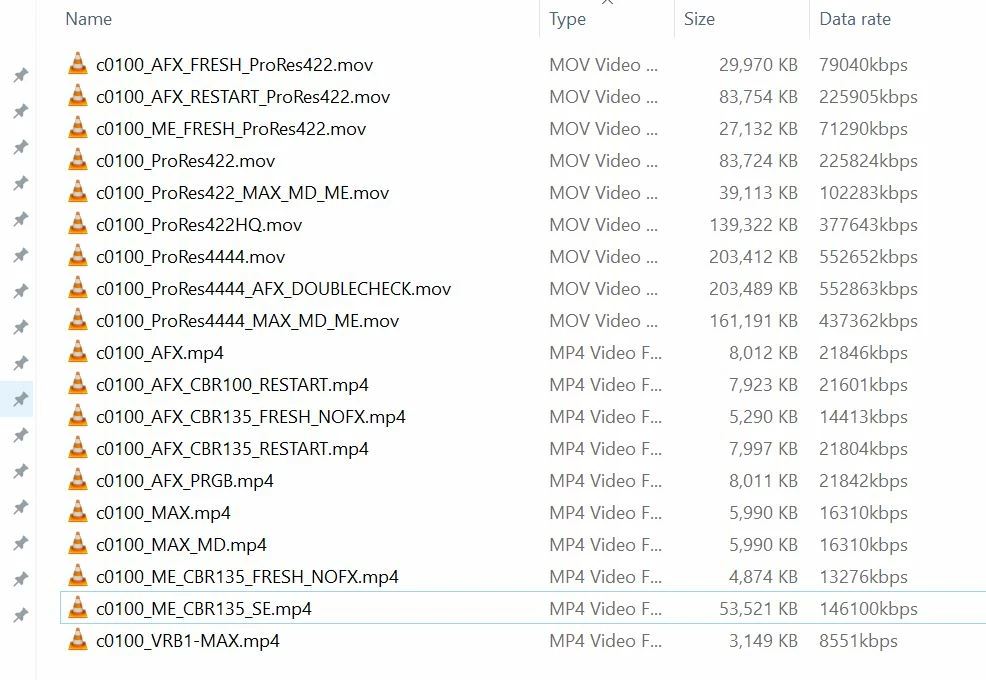

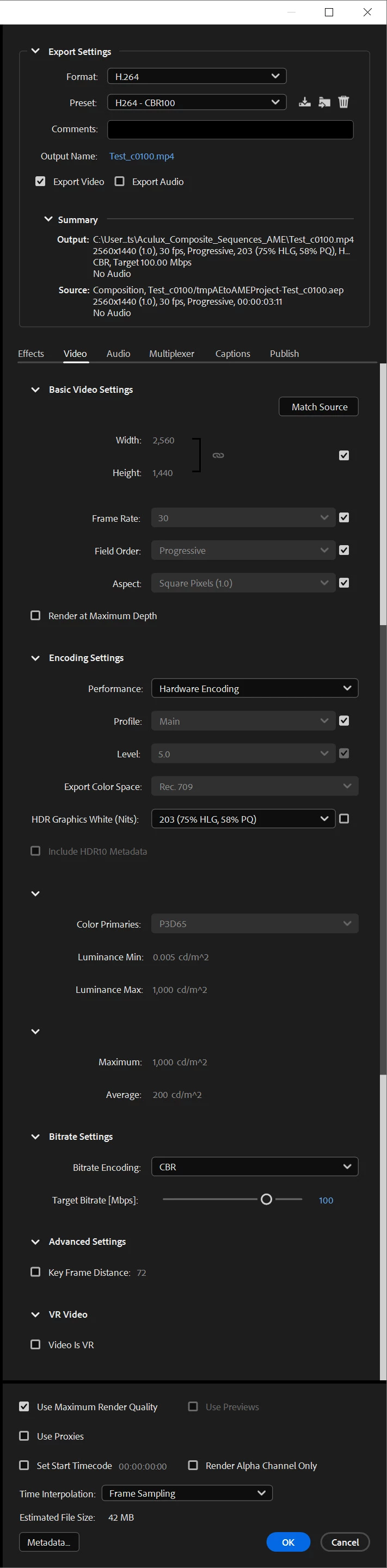

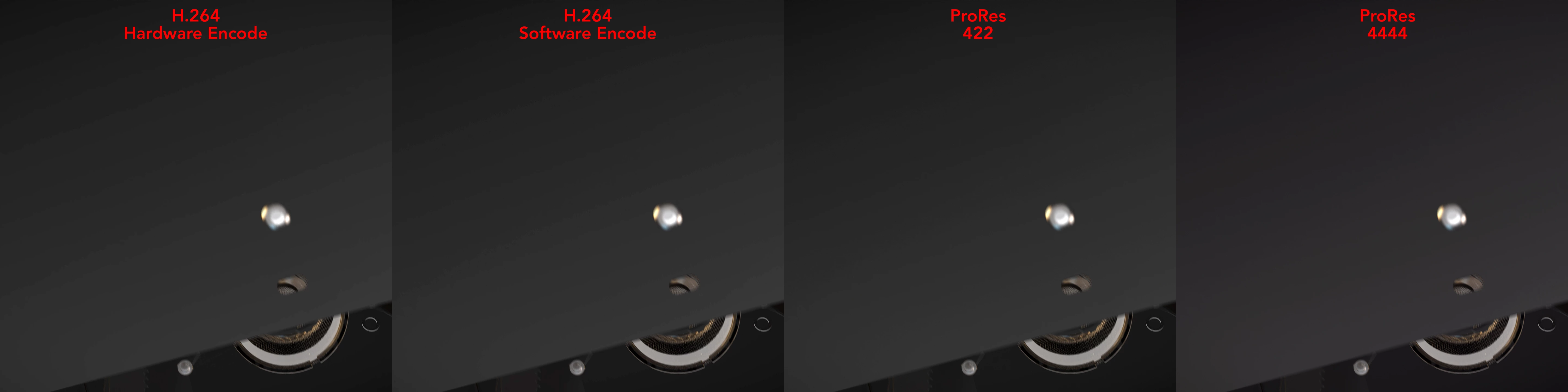

Here's a few comparison images. One shows my different test exports, their file sizes, and theie data (bit) rates. One shows the different compression banding issues (or lack there of) between each file type. One is of my Media Encoder settings at 100mbps. Why I think there is a software bug is notice the estimated file export size (42MBs), but then when it exports it comes out at about 8MBs and only 21mbps.
