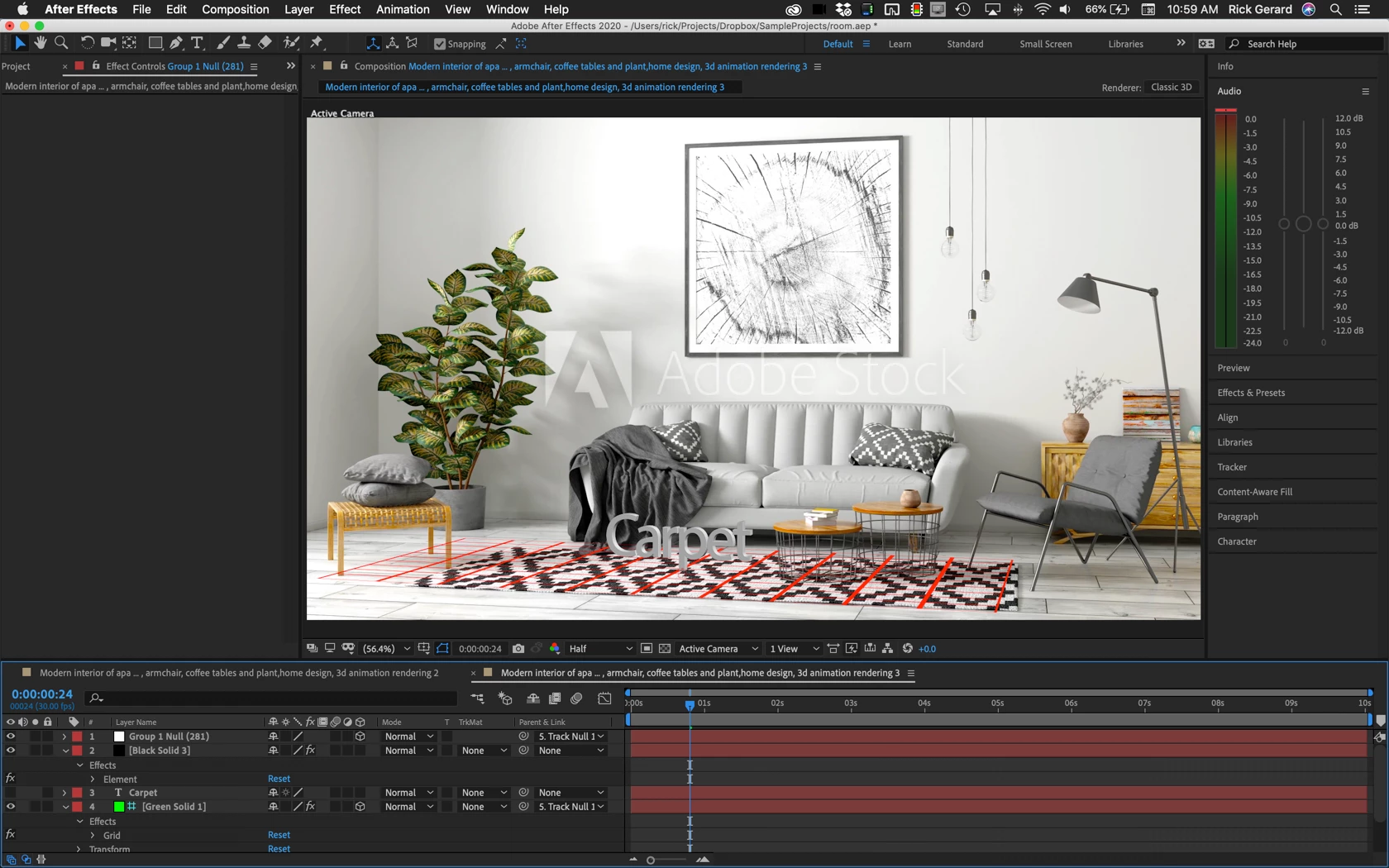

Hello, When I track a solid (made with element 3D) works great and I can make it "sticks" to the floor, wall etc... when I try to do it with text, the text moves and don´t stick to the ground not even with "Orient World" script.
I did exactly the some process that I did with a solid, what am I missing here ?

As I expected, the workflow for attaching the Group 1 null to the Track Null with expressions and by manipulating the X rotation was wrong. The descender of the P also needed to be lined up with zero in Y because of the optical illusion created by the descender sticking through the virtual floor.
Using Shift + Parent to line up the Group 1 null instead of expressions and rotating the X-axis of the null to 90º, then adjusting the size of the text and positioning the text with the descender of the p at zero in Y will fix the problem.
I checked your track by adding a solid and adding a grid and the camera track was good, but you didn't set an origin and ground plane. That would have made things a lot easier. Without a reference solid it was very difficult to see the errors in orienting the Group 1 null to the Tracker layer. Shift + Parent is the only workflow that will always work and it takes less time than any other method. The expression idea is pretty terrible and was probably suggested by an amateur in a tutorial somewhere.
You already have the footage so here is the fixed AEP file.

I downloaded your comp. I can't tell anything about the accuracy of the track without the footage, but I do see that there are no reference solids in the comp, just nulls. It is incredibly difficult to judge the accuracy of the Camera Track or tell if you have selected a viable surface if all you have is nulls because you can't see them in a preview. I always use Create Solid instead of Create Null, and I always set an origin and ground plane. Rather than trying to explain things in a post I took a few minutes and used your project to try and analyze the project to see why the text layers did not seem to stick to the surfaces in your scene. I hope this helps. One day soon I will do a complete tutorial on the most direct workflow between After Effects and Element 3D and C4D Lite.
The two problems I suspect but cannot see because the footage file is missing are the improper placement of the baseline of the text layer, and the expressions - not shown in the tutorial, that tie the Group 1 null to the Tracker null. Using an expression for position and orientation does not allow you to reposition the Group 1 null, which adjusts the position of the text object.
