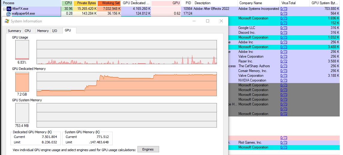

so After Effects is not performing very well on my PC. Sometimes its so bad that my PC Frezzes and i have to power reset it. I ran some checks and the Problem is that when After Effects is open my VRAM Usage Jumps from 300 mb in use to 7,8 GB in use. I check and it looks like After Effects is using almost all of my VRAM on my GPU. That causes the System to Frezze.

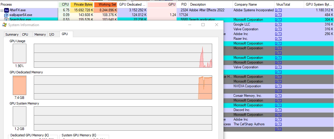

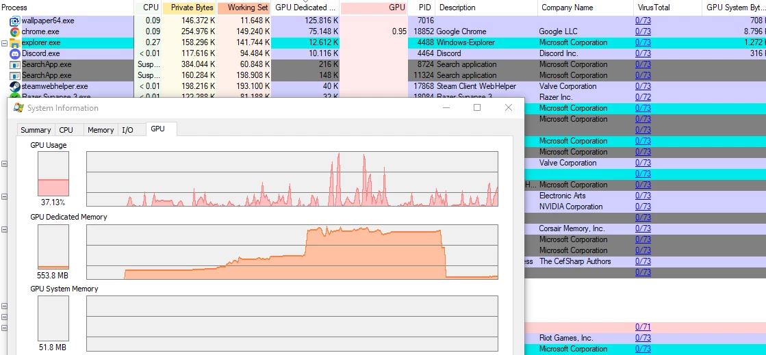

Here are to Screenshots of the Problem
Without After Effts

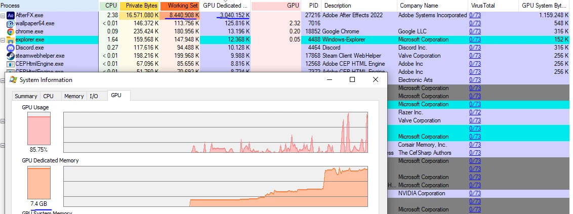

May 17, 2022 12:45 PM UTC
Hi Nishu,
I use the newest Version (22.4) from the Creative Cloud App
Here is a screenshot with Multi Frame Rendering disabled
