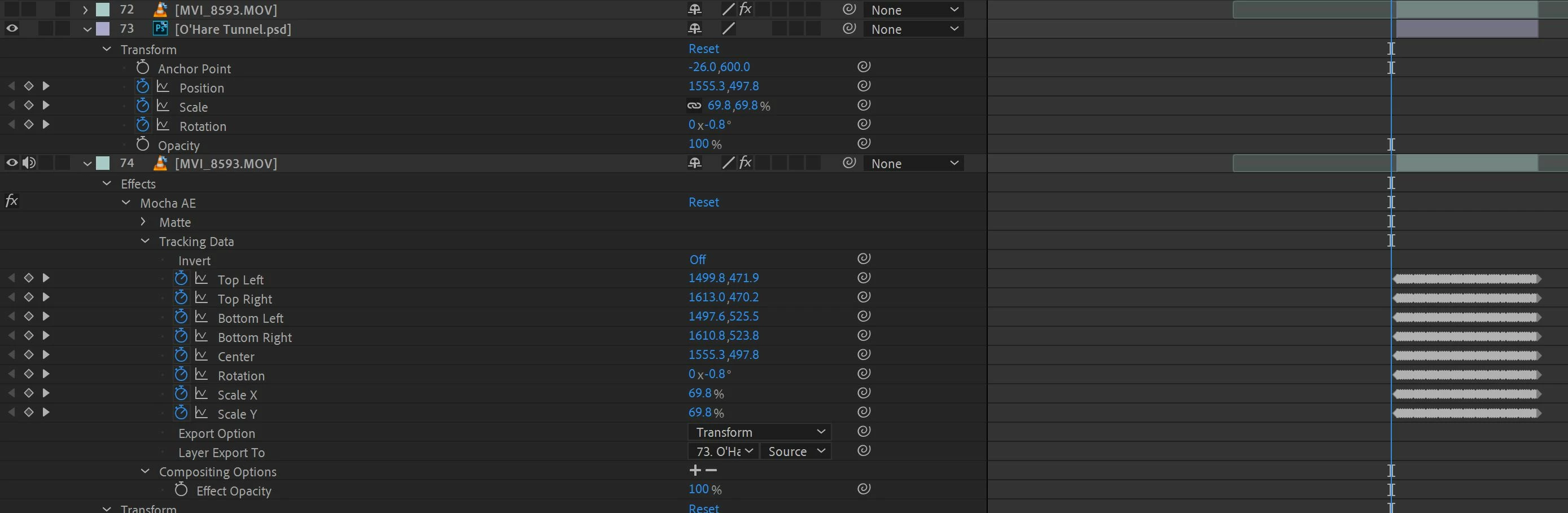

I am using Mocha AE with AE 2020 ver 17.0.2.  I am trying to use Mocha to track data.  I have used the plugin and created the tracking data. I have used the Cog and selected the tracking data and see the Tracking Data under my Layer. However I am unable to get the data into a Image, null or solid layer. I have tried to use the Export Option to Transform or Corner Pin to my selected layer but no data ever gets to the layer. There are no tracking pointing, just a single set of values for the transform parameters. What am I doing wrong?

You will have to do the secondary part of applying the track. Step one is pick what track to use. The second step is to apply the tracking data to the section you need to apply it to.
How to use our Mocha tracking data:
  1. Let's review the workflow to use our Mocha tracking data:We select the Chosen Layers to pick which Mocha layer we want to convert to AE. To choose a layer to create tracking data from, click the 'Create Track Data' button in the Tracking Data section of the plugin.Then choose either the name or the cog of the layer you want to read tracking data from in the dialog that appears. You can only choose one layer at a time. You can then see the output of its surface back in the After Effects interface. Each point in the Tracking Data section is a point from the layer surface that automatically updates when you modify it inside Mocha.
  2. Create Tracking data. Once you click 'OK', the plugin will generate keyframes to populate the tracking parameters in the plugin. You can then use this data to copy to other layers, or link via expressions, without needing to export from the Mocha GUI. You can use any of these keyframes once they're created, so you can copy/paste the data or you can use expressions to apply them to other layers in your composition.
  3. Apply tracking data to a layer or a Null, use the dropdown menu to select an export option at the bottom of the Tracking Data section:- You can either use a Corner Pin to apply onto a any layer, (which is a standard corner pin effect), a Corner Pin that Supports Motion Blur (A corner pin distortion with separate scale, rotation and position.), or a Transform: (Scale, position and rotation like you would use to paste on a null).  Clicking 'Apply Export' then applies the tracking data to the specified layer. Anytime you are using a corner pin, your target layer must be the same size and the same frame rate and aspect ratio, as the comp and layer you are tracking in Mocha AE or your data will be distorted based on the difference.
So in short: Click create track data, select your desired layer, click OK, use the dropdown menu to select and export and the target layer, and click apply export. Really easy. And applying shapes is just as easy.
Please let me know if you have any more questions and I will be happy to help you.
