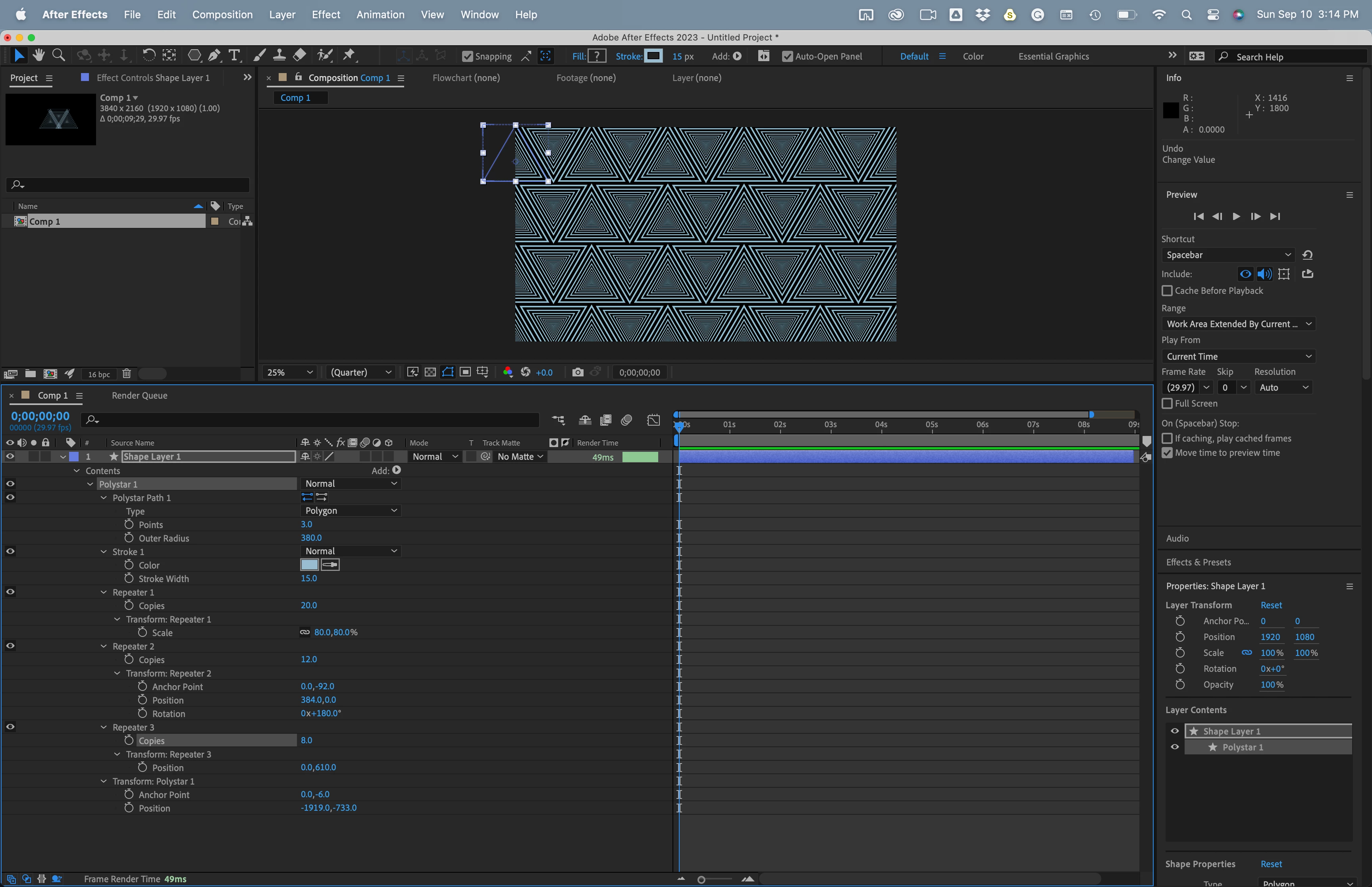

I am wondering why you are using a mask and Rep Tile on a shape layer. Just adding two additional repeaters will give you complete control over the repeating pattern, and it will render faster.

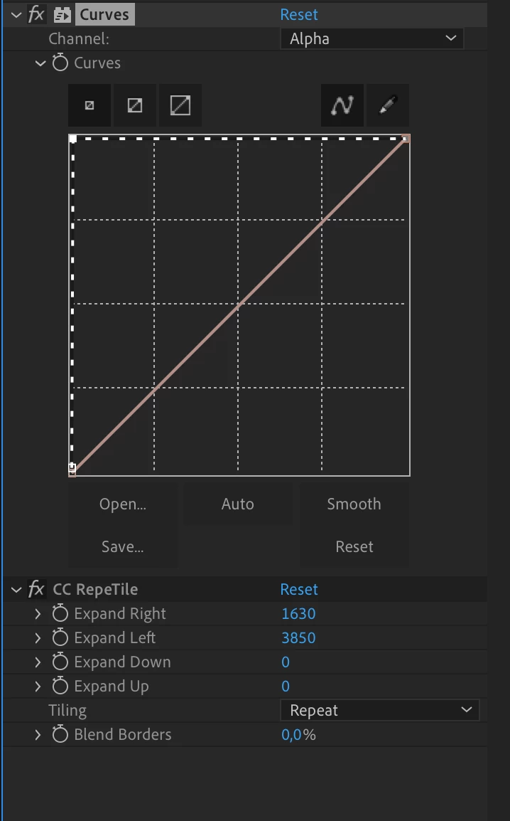

Apply Curves effect above the Repe Tile effects and set the Alpha chanel
like this:
