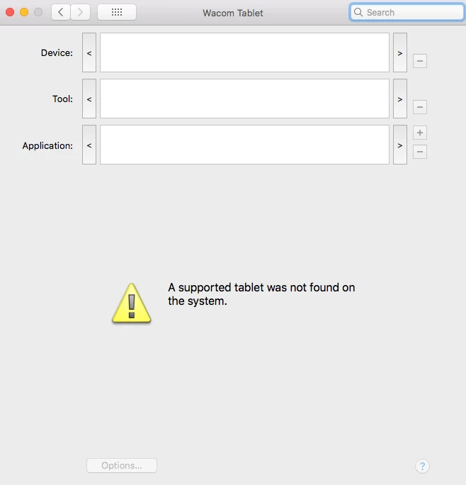

shimi1622
November 28, 2017
Weird stuff - This resolved to issue for my friend but not for me.
When I install this driver my wacom won't work at all.
On the wacom setting it says "A supported tablet was not found on the system"

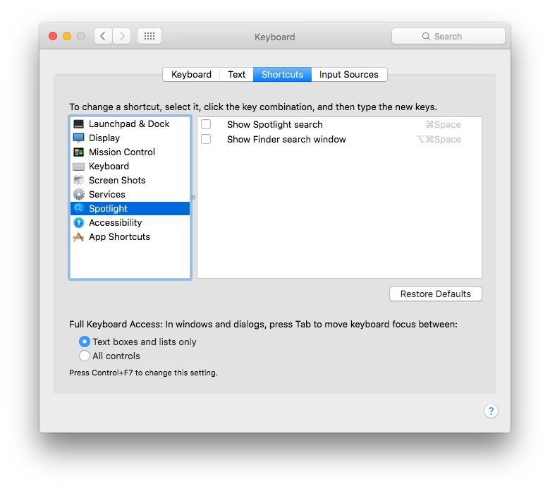

And, probably completely unrelated... I turned off the Keyboard shortcuts for Spotlight in the system prefs, but this was more because I use the same shortcut in Illustrator to zoom and El-Capt kept on opening Spotlight.
