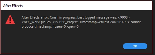

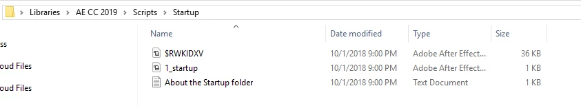

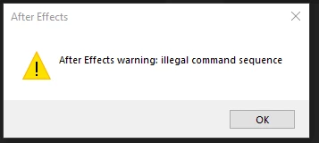

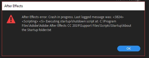

The Crash occurs after the splash screen. I get messages about offending items in the script startup folder. When I remove those items it runs down the line from one to the other until I get a "can not produce timestamp" error. Then it says illegal command sequence and crashes. Occasionally, when I remove these items AE will start successfully and I am able to work. A couple of times it's worked with no intervention as well.
I've checked for updates, rebooted, and removed offending files before launching.
1.
2.
3.
4. items noted in the crash report:
