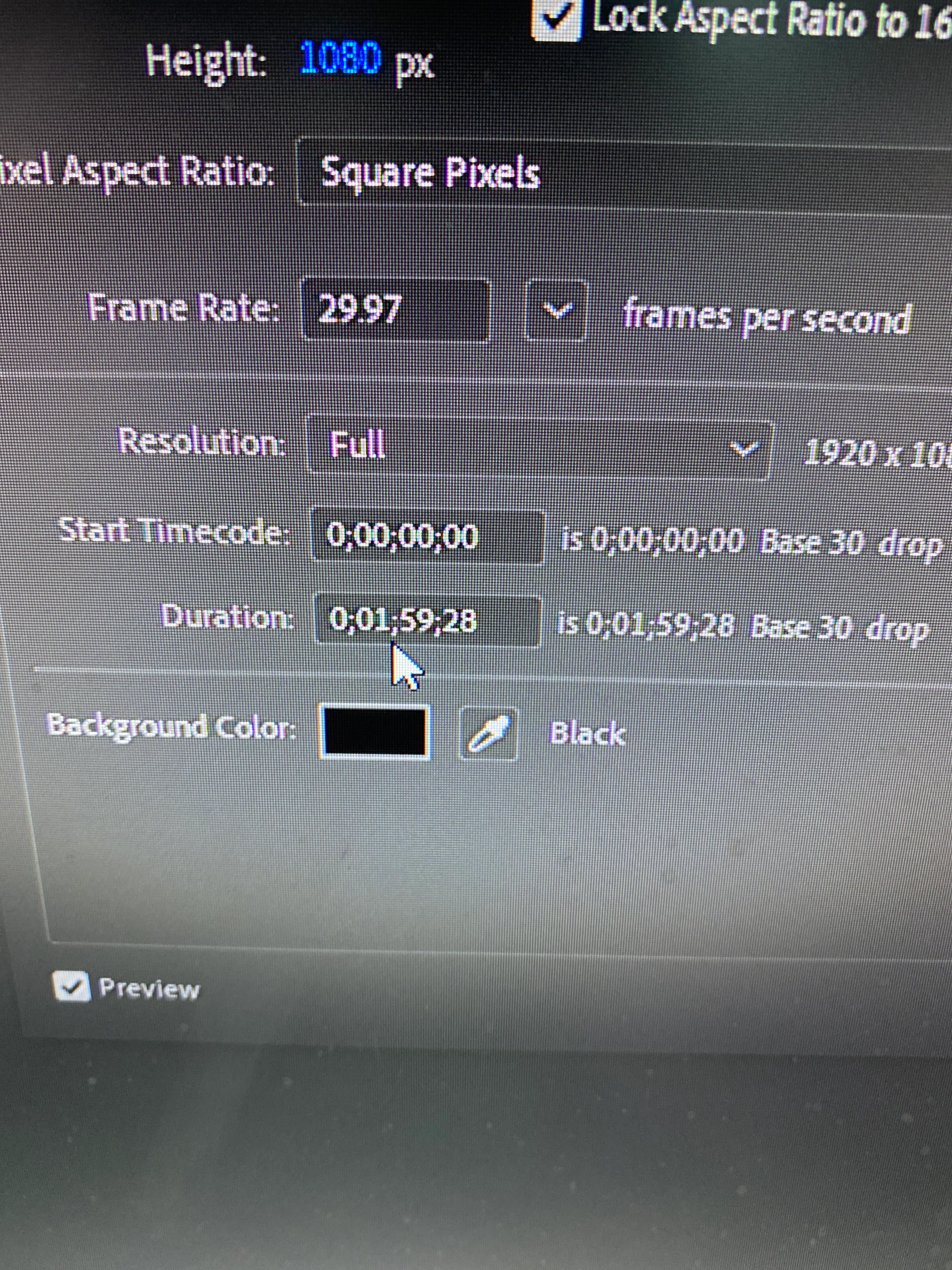

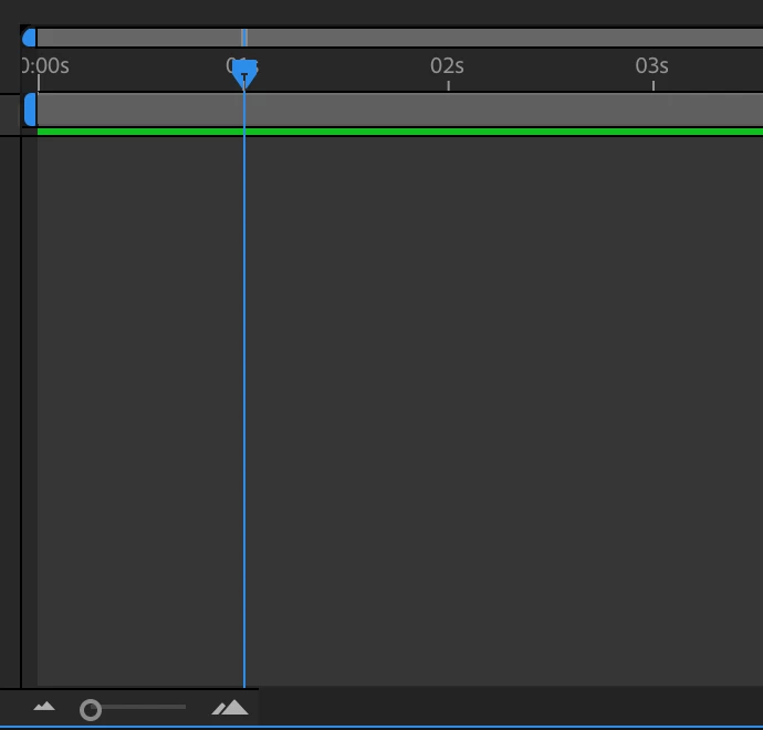

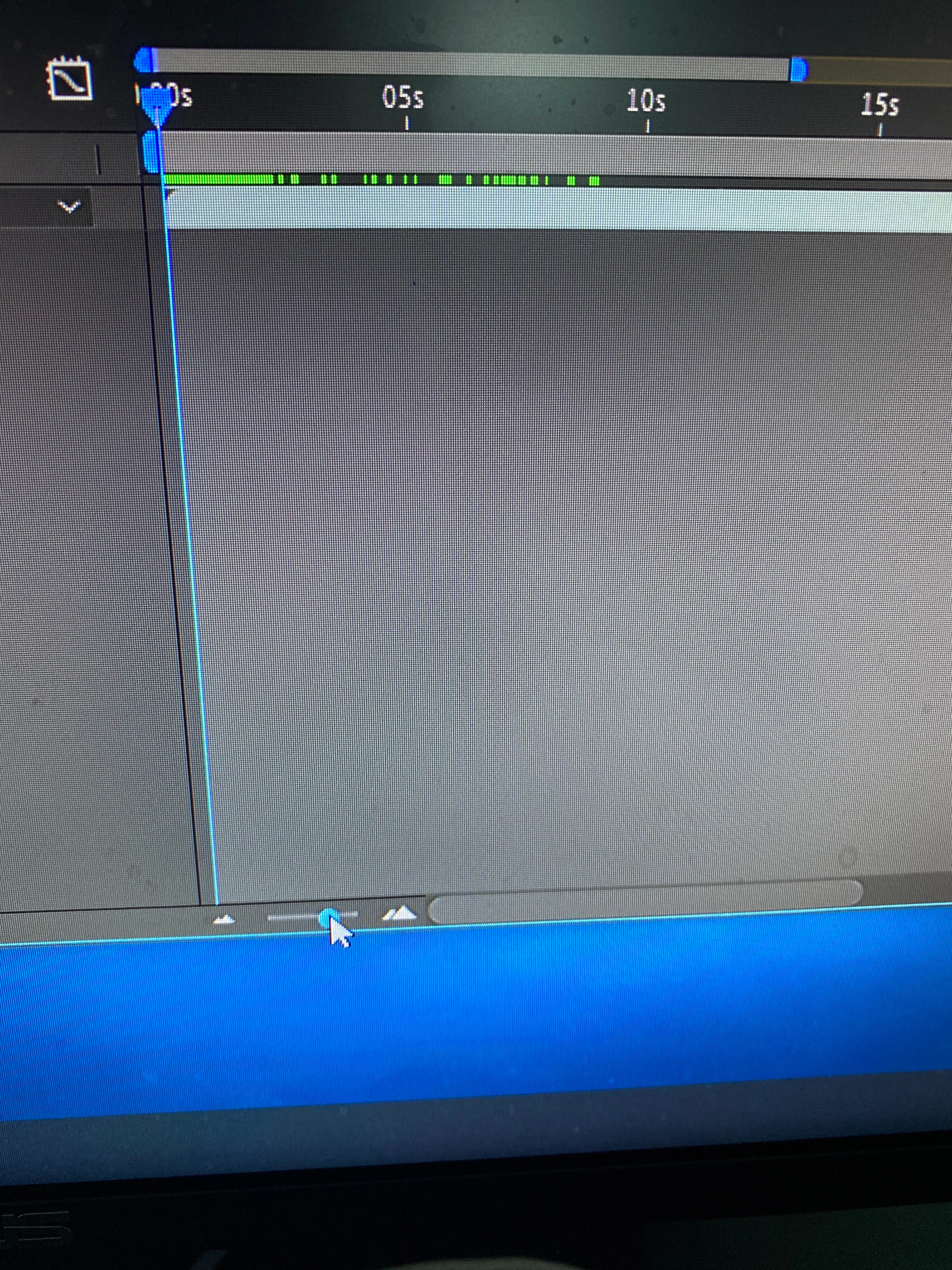

In composition settings go to duration. You have to set the duration of your project to how ever many minutes you want the project to be(make sure it's minutes not seconds!) if the project is under 12 seconds it will show frames only. Second,
you have to click on the zoom in feature at the bottom of the timeline box and ZOOM OUT! If you're zoomed in it will show frames even if project length is correct. This will fix your problem 100%.
