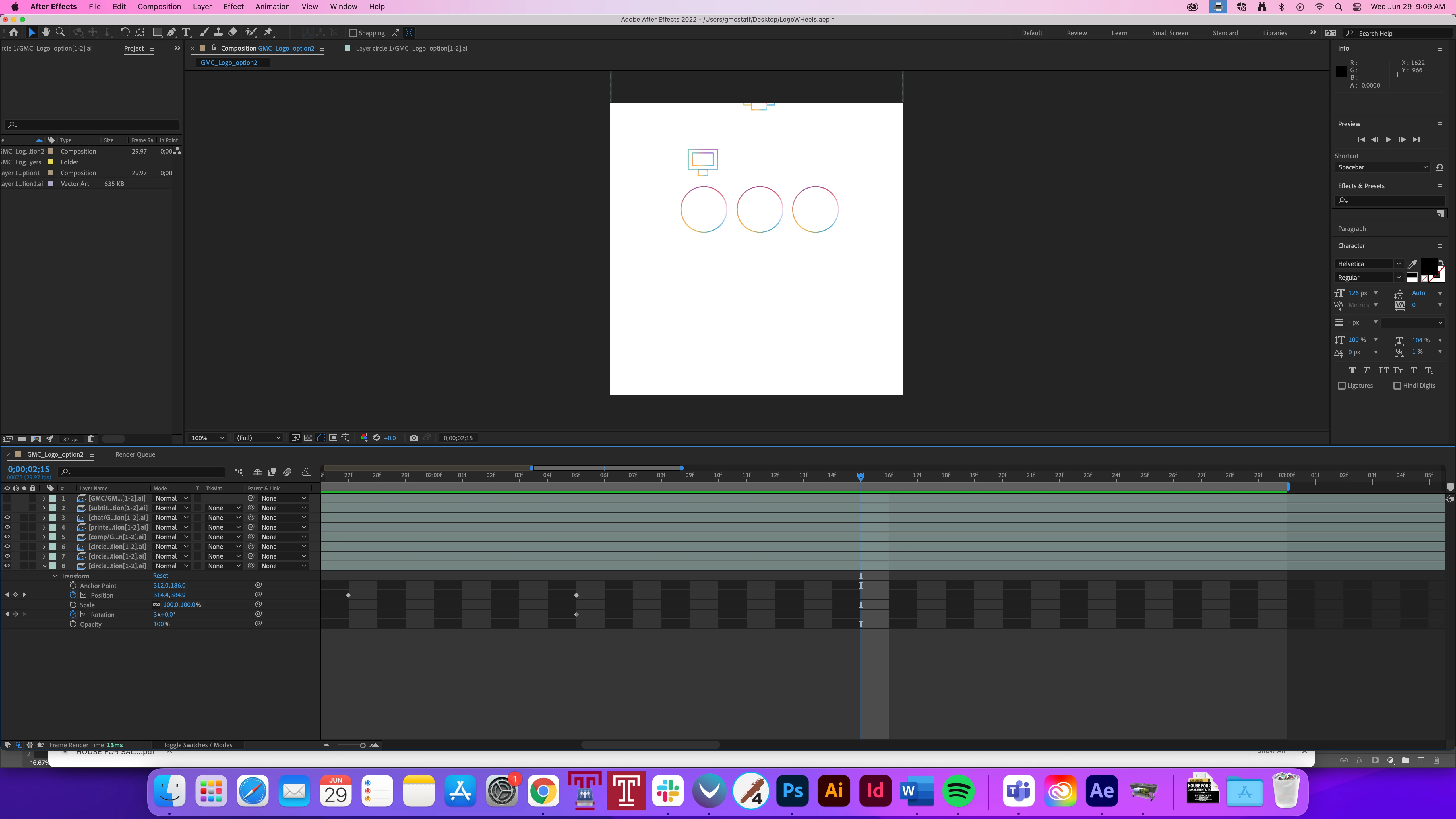

Hello! I'm facing a peculiar problen on AE that I've never dealt with before. The animation that I'm working on changes the images/files towards the end (as you can see the circles are solid and then they become outlines).
I'm using AI layers to put this animation together. The outline version is from another AI file but I don't see how it is connected with the current AE project I'm working on now. I'm not able to figure out if this project is somehow linked to the other AI file.
Thank you in advance!

From the screenshots you posted below:
The icons on your layers look like image sequences - which is why they say filename[1-2].ai.
Because of the way you imported these, After Effects thinks it's a piece of footage, and not an actual Illustrator file.
Select the asset in your Project panel, right-click: Replace Footage > File
Navigate to the original file and make sure when you select your .ai file, that you UNCHECK any indicator marked "image sequence."
Because your files end with a number, AE assumed it was an image sequence. Sometimes helpful, but sometimes very confusing if you don't know that's what happened!

I've attached the screenshots! If you can see where the Current Time Indicator is, at 14f it is good until that point. In the other screenshot at 15f, it changes to the outlines.
