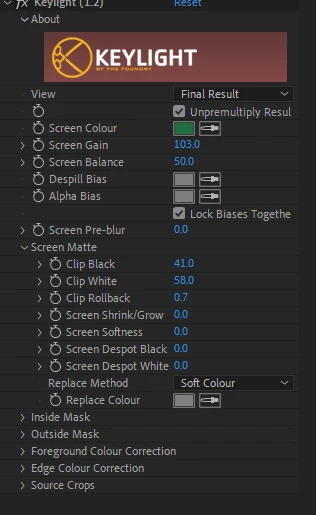

You overcranked the screen gain, but have basically two completely different greens to begin with. you need to dial that down and work with the "rollback" options further down. You also cannot avoid some manual masking due to the whole situation. Other than that it should be perfectly doable if you have a sufficiently tight garbage matte to only have the center. On another note it might have helped if you worked with some light from the left rear as well. The clipping you experience is no doubt related to the huge difference between when the figures are in the shadows vs. when they are in the light. If you use colored lights for such stuff you can even creatively selectively color correct them to enhance edges or fake additional shadows.

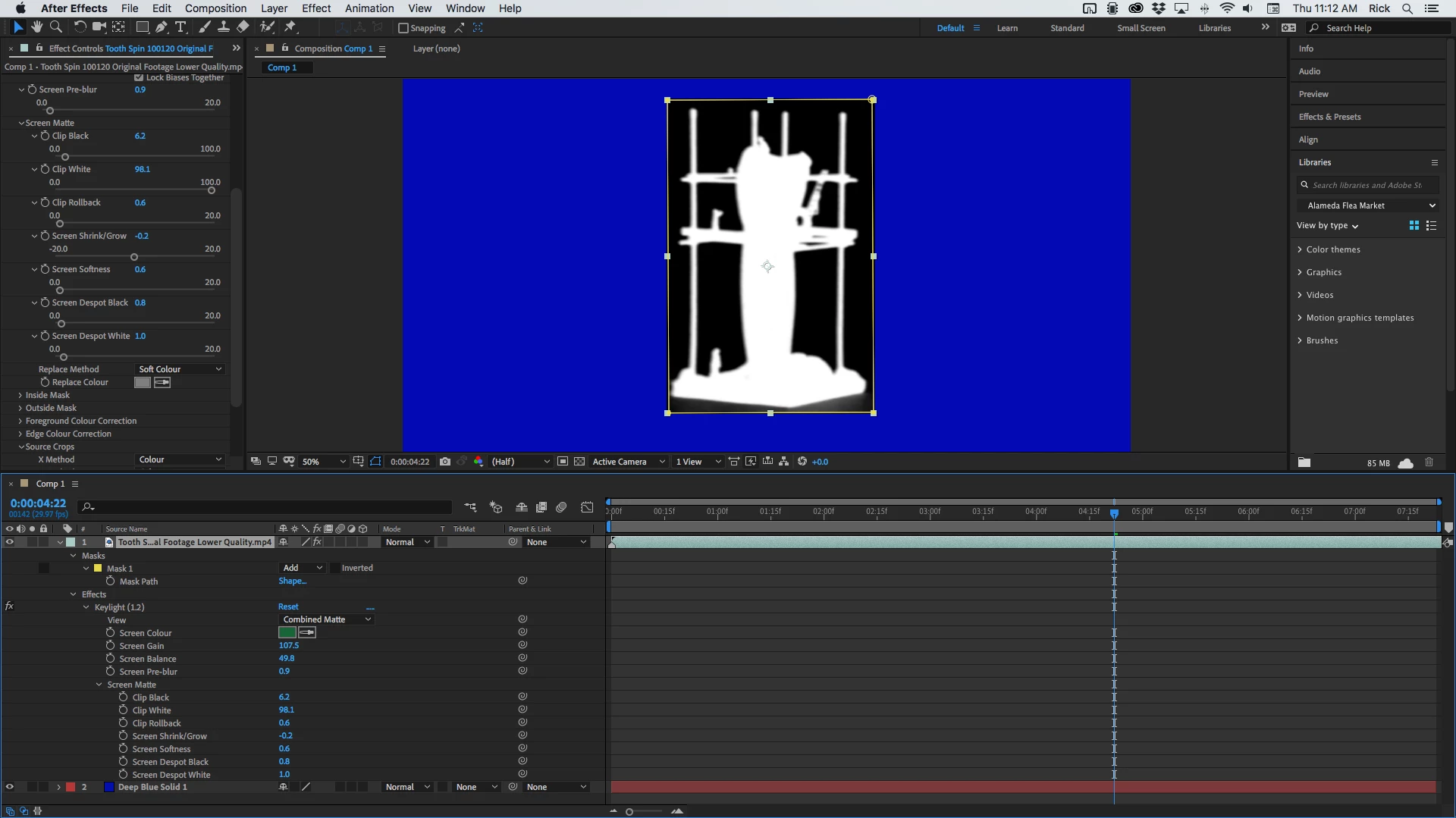

What is the format and bit depth of the original footage? I get a pretty good key right off the top just using Keylight. My first pass looks like this:
The comp is 32 bit. The base might require some rotoscoping to fix the shadows, but with raw or at least lossless original footage you should be able to get most of the way there just by fiddling with the controls in Keylight, but you'll have to mess with most of them. It is not unusual to have to do a little roto to clean up shadows.

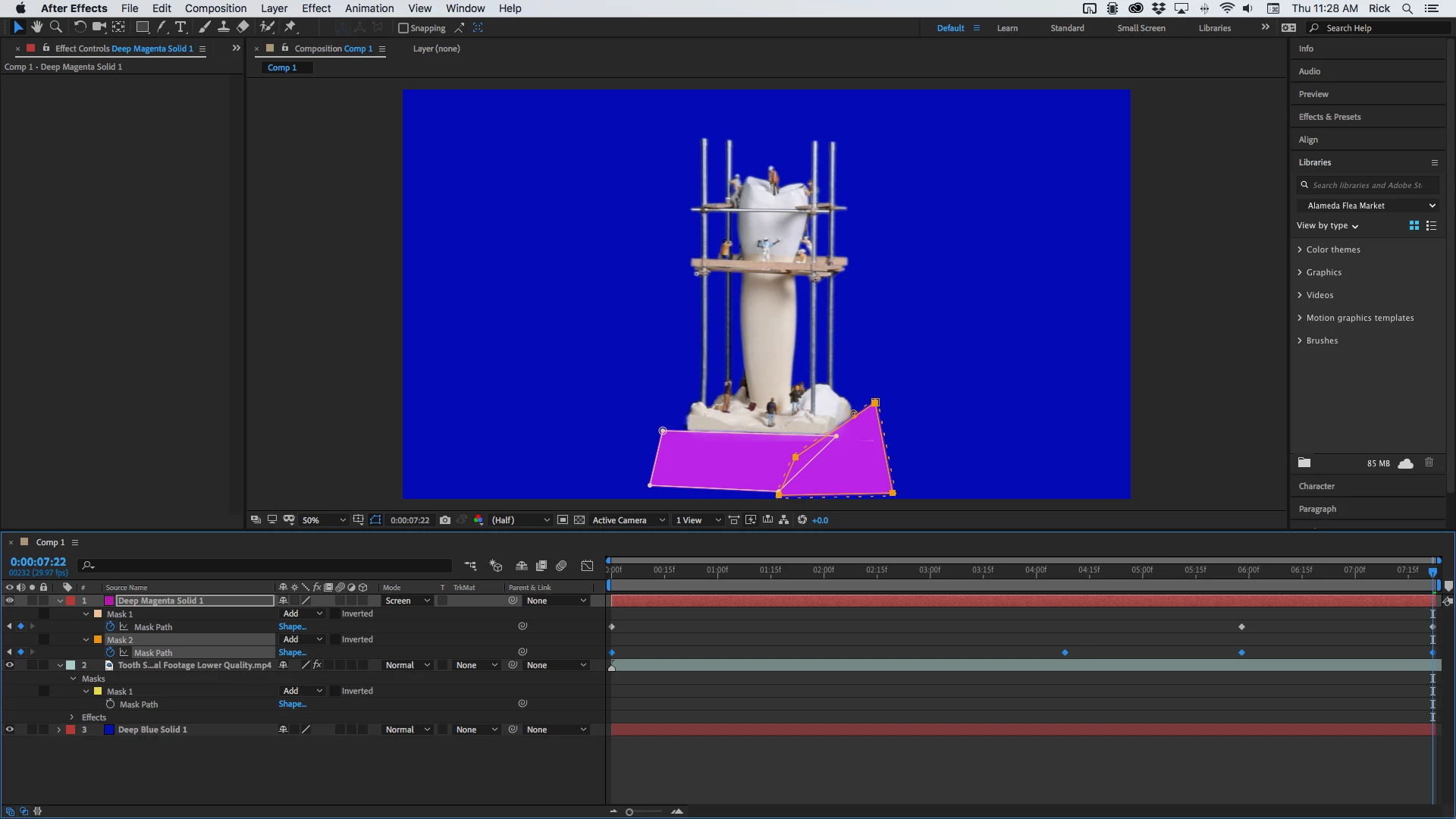

I usually use shape layers as track mattes for the roto because you can easily see through the layer if you choose a good blend mode and you can animate the opacity of each individual path as needed. I find it easier than dealing with masks on my footage. That setup looks like this before setting the layer as a track matte for the footage. I was able to animate the masks with just a few keyframes.
As long as you have the path selected in the timeline it is very easy to edit the paths with the selection tool (v) because the cursor will change from a black arrow with a tail to a white arrowhead and you can drag selections around points.
I chose a blue background solid because it is easier to see edge problems against a solid color than it is to see problems against black, white, or the transparency grid. I chose the color of the track matte solid (layer 1) so that it gave me the best view of the edges with the screen blend mode turned on. The results were perfectly acceptable with no other work.
