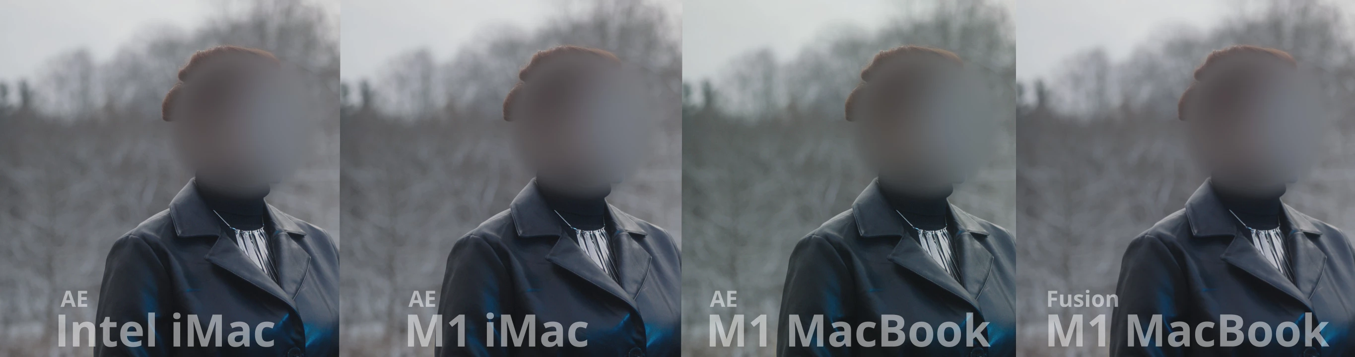

I have an issue where After Effects on 1 machine seems to be handling the color differently than it does on other machines, this is happening with multiple files that I tested.
In this one test (image included) I open the exact same AE file on 3 different machines (all Macs) and the Macbook is rendering the images with a slightly adjusted color than the other 2 machines. It is the exact same file, so the working color space in the project is set to be the same, and the export codecs were the same, and there is no setting I can find that is different between them (although admittedly I'm no AE expert so I'm hoping there is a setting I am unaware of).
When I open the project up it is even noticeable in the AE viewport that the color is looking different, so it's not just a export issue.
I was starting to think it was a issue with the Macbook, so I loaded up the same footage and LUT in Fusion to compare but it looks fine in Fusion, so I'm fairly certain it is a issue with After Effects not the computer.
I have tried uninstalling and reinstalling AE, but I am still getting the same result.
Any help on figuring out why this one installation of AE is handling the color differently would be much appreciated.
Thank you
Image description, the first 3 panels are all rendered from the same file from different machines, as you can see the 3rd panel has a more green tint. the 4th panel is from the same computer that rendered the green tinted 3rd panel, but rendered from Fusion to show that it is a issue with the software not the computer.

One thing I'm not quite clear on: it's apparent the colours look different on the Macbook AE render, but if you take the Macbook's output and view it on the other machine, does the colour shift carry across? Is that colour shift visible only on that machine, or has it become part of the rendered result?
Put another way - when you grabbed the panels from each machine to make your preview image above, did you pull all the renders onto one machine and grab them from there, or did you grab each shot from each machine?
(I'm assuming you're grabbing those panels from a rendered movie, not just screengrabbing from AE - am I right? If those panels are screenshots from AE, you may need to check you have Display Color Mgmt switched on and set to the same color space on all machines - View Menu)
The other thing we kinda need to know is what you've got going on monitor-wise, what colour space they're using and whether you've calibrated them (and in the case of the Macbook, depending on the particular model, the screen may be in sRGB mode, or P3 [wide-gamut] mode etc, which may look inconsistent next to other monitors)

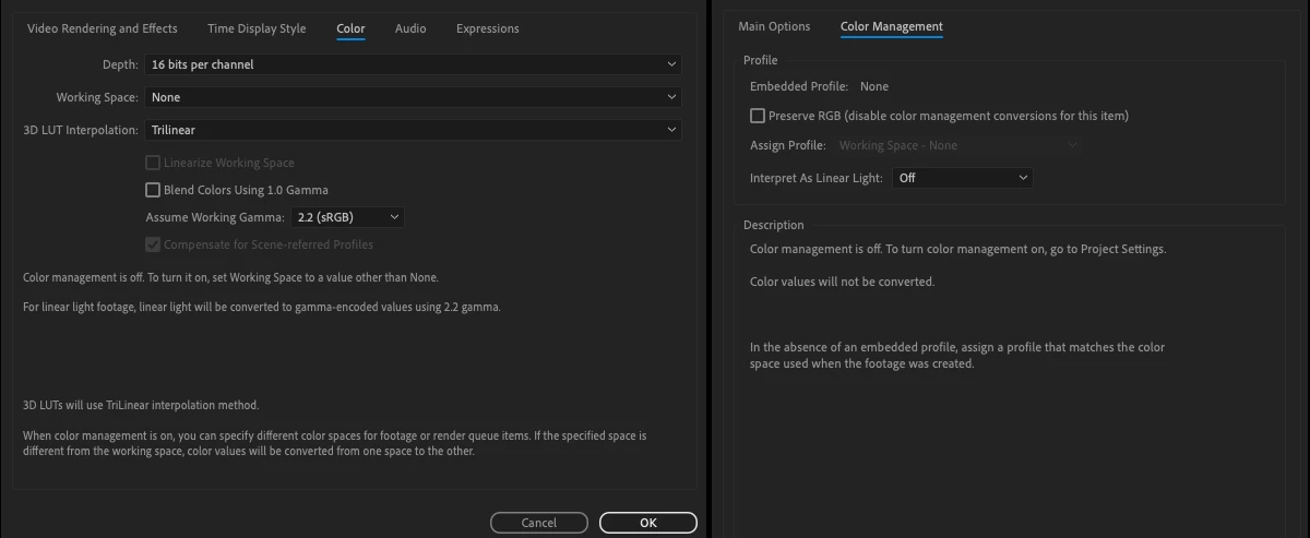

And what are the actual color management settings? Footage interpretation? Screen settings? Hardware acceleration settings? You've written a lot, but not provided much actual info.

The color management settings are turned off, as the working space is set to None, this setting was consistant for the file when rendered from all 3 machines. I'll include a image showing both my project color settings and footage interpretation for the file.

I am not sure which screen settings you are refering to for me to check, but all the results are from renders, and compiled on the same machine, none of the images were taken from screen captures, as I didn't want monitor differences to effect the previously provided image (As far as I am aware monitor and display settings shouldn't effect the render result, please correct me if I am wrong on that). As howiemnet has asked below, the color difference is a part of the rendered result, as when I viewed the movies on other machines they had the same color offset baked in, and vice versa the movies from other machines appear normal when viewed on the M1 Macbook, which is why I was able to compile the previous image to display the difference (the image was compiled and rendered out of Fusion, so still no screen captures involved).
