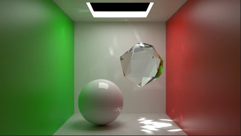

The image looks the same as in my C4D renderview. See below:

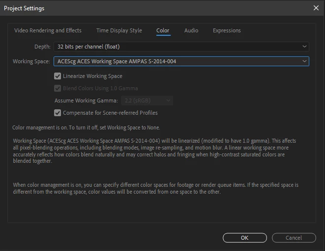

I'm starting with a new project. Set my project settings as following:

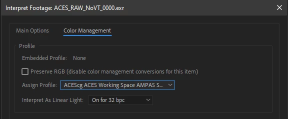

Under Interpret footage I assing the ACES-cg colorspace profile to the render.

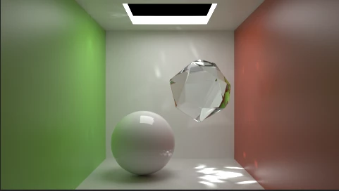

I would expect the render that is now interpreted as an ACES-cg render to look the same as in my C4D renderviewer or using the OCIO plugin. Instead it looks like this:
The transfer curve seems to be different as the image is much brighter than what I would expect. The brightest parts are completely blown-out.
Where am I going wrong? Why is there a difference between the two methods? Is there a way using the built in colormanagent to get my render to look the same as it does in my C4D renderview?

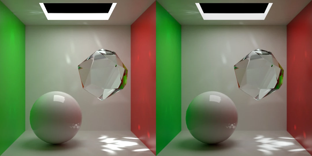

And a side by side so it's easier to see the difference
