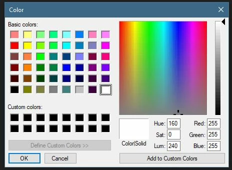

After the most recent AE update, the color selector changed to this:

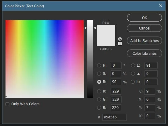

I'd really prefer that the interface look how it did before, like this:
Does anyone know how I can revert it? Preferably without rolling back the update. Thanks!
Correct answer Mylenium
Turn off the "Use system color picker" option in the preferences.

MyleniumCorrect answer
July 8, 2022
