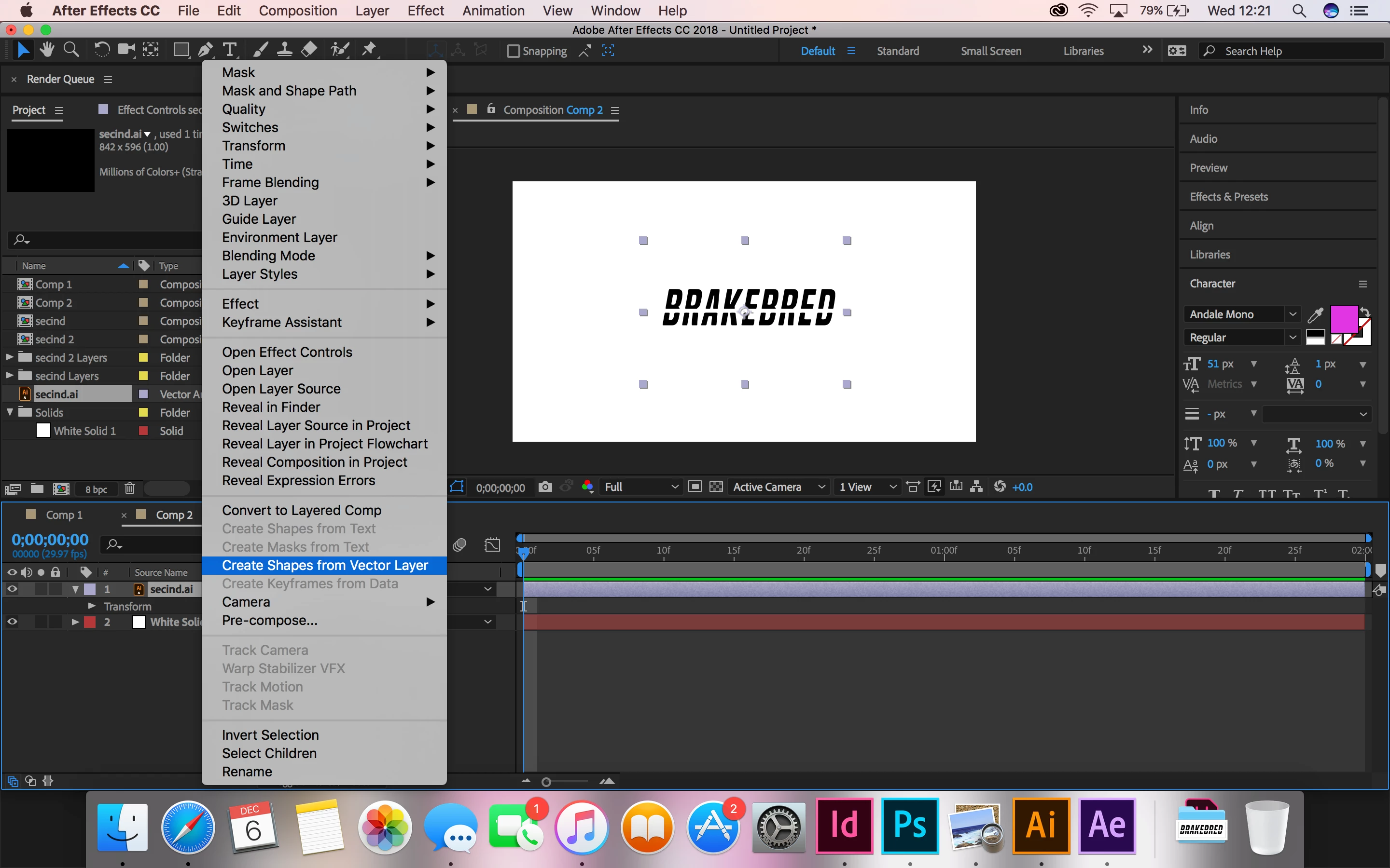

I am trying to make a logo 3D, from an Illustrator file (or I could try from png). The logo is cut up text, so it is made of many parts, like so ..

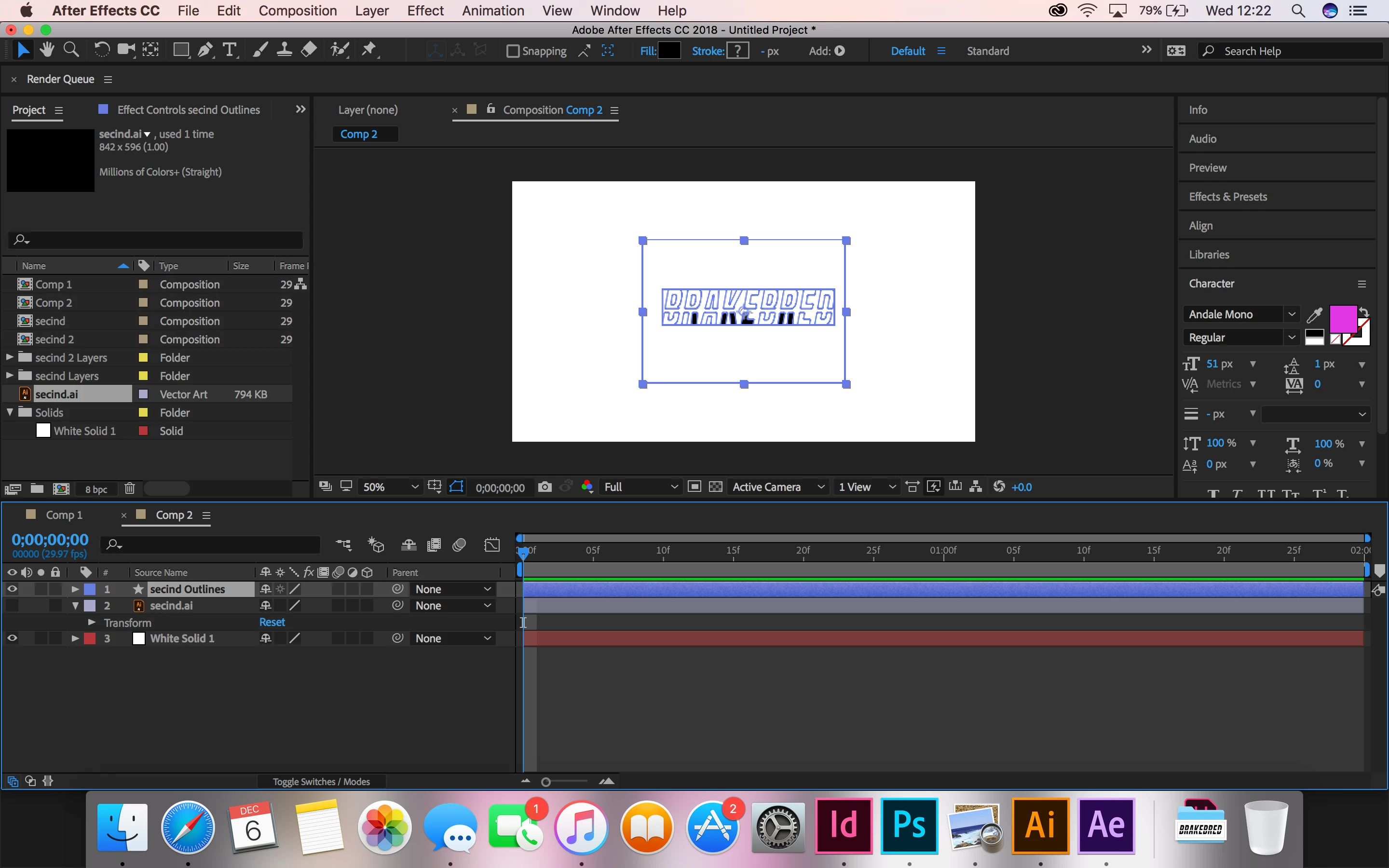

I place this into AE and when I select 'Create Shapes from Vector layer' most of the logo stays white/is not even selected.
How do I fix this?
Images below...

I can see from your screenshots that the shapes are all being converted, but you're running into issues with how they're grouped. As mentioned above, the issue is the way they're built in Ai, which is giving you unpredictable results when converting to shape layers (which I'm not entirely convinced you need to do.)
Confirm if you do indeed need the letters to be separate pieces.
Confirm if you do indeed need those pieces to have full editability in Ae (i.e. whether they need to be shape layers). If not, just import them as separate layers from the Ai file.
There are a lot of tutorials about the Ai to Ae workflow - I'd check some of those out, which will help you with the particulars, but also help you determine how far down this path you actually need to go. This might be a good one to start with.

You start with expanding appearance in AI so you end up with simple paths. If they are in a group select the group in the Layer Panel,  use Release To Layers (Sequence) by clicking on the Layer Panel menu at the top right corner. It's 3 little horizontal lines. Then you select all of the layers created and drag them above the first layer.
If you want to keep everything on one layer then you have to explore the Layer Panel in AI and make sure there are no groups, compound paths or trim paths applied. Those will cause problems converting to shapes in AE. Expand appearance and the elimination of strokes on all of the objects will help a lot.

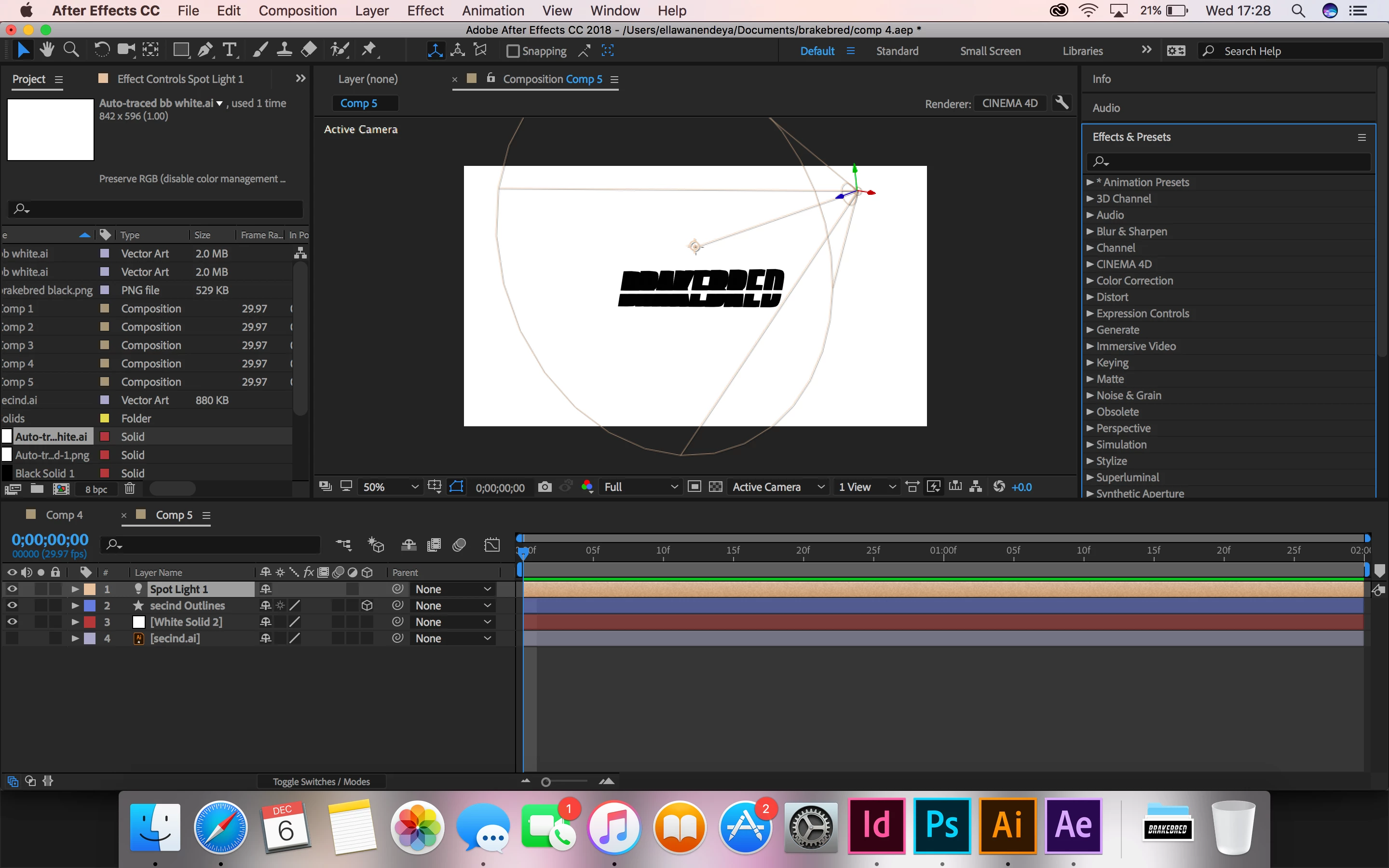

Great thank you! I did just that and was able to make the logo 3D very easily afterwards! I'm now just having difficulty putting shadows on the object? The light is white and I've turned on 'cast shadow'... if you could spot what is wrong, I would be extremely grateful!

In addition to what Rick said also check the paths themselves. Slicing up stuff in AI using PAthfinders etc. regualrly produces "bad" paths with stray anchor points that need to be cleaned up. This can have a huge impact on the conversion.
