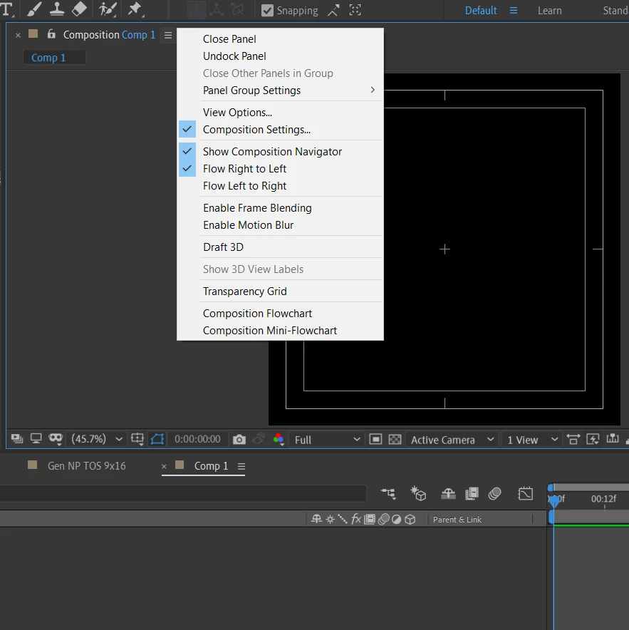

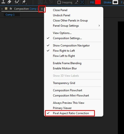

Hi Antonio23770288k3xu,
Thanks for writing in.
Are you working in non-square pixels (say, DV)? If so, enable the Pixel Aspect Ration Correction in the Composition panel (check out the screenshot) and redraw the circle.
Let us know if it helps.
Nishu
March 28, 2022
@nishu_kush
Hi Nishu,
Thank you for the information. I believe this might be the issue, but I was unable to find it on AF 2020.
I've searched everywhere AE and other search engines but was unable to find it. I hope someone here has the answer.
