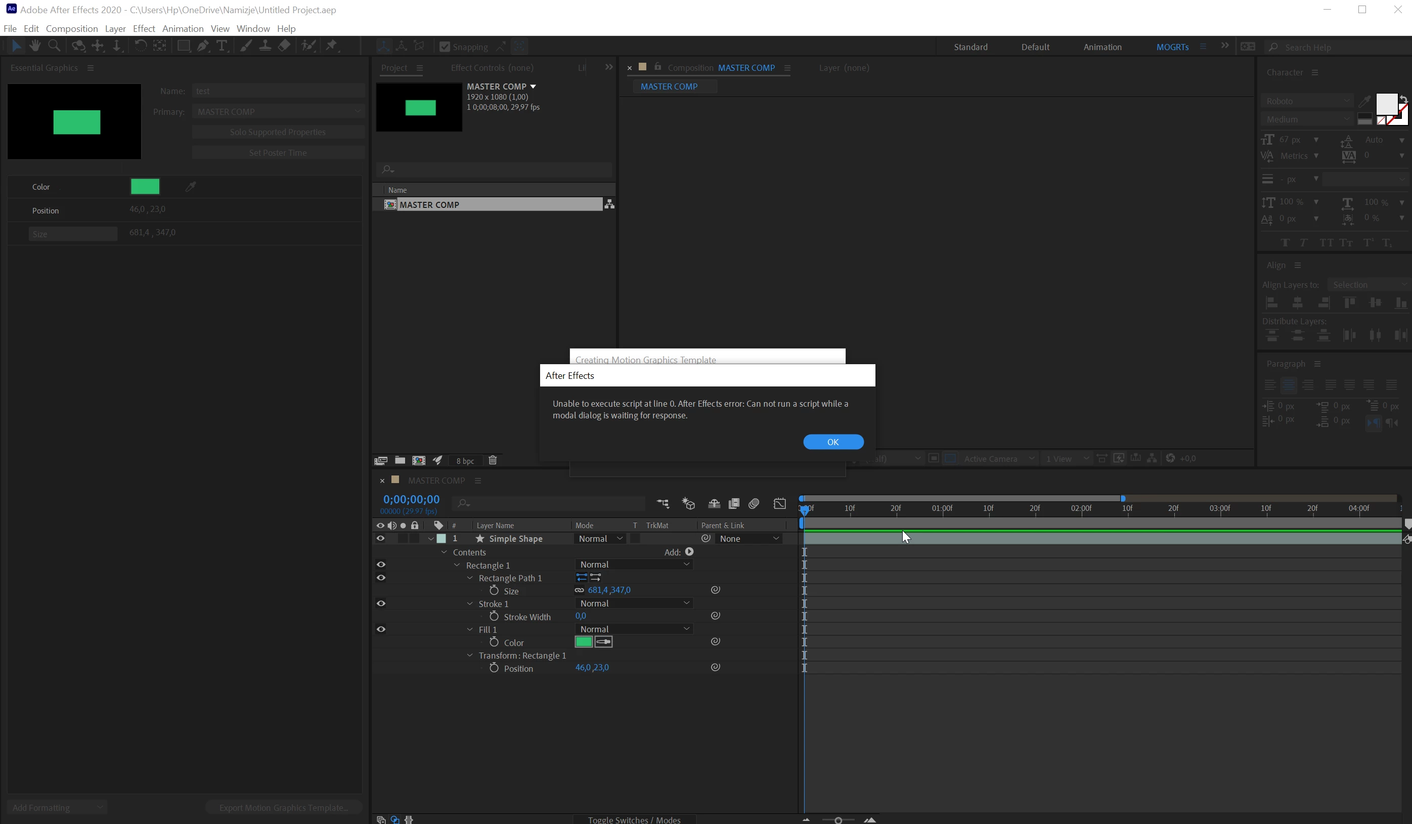

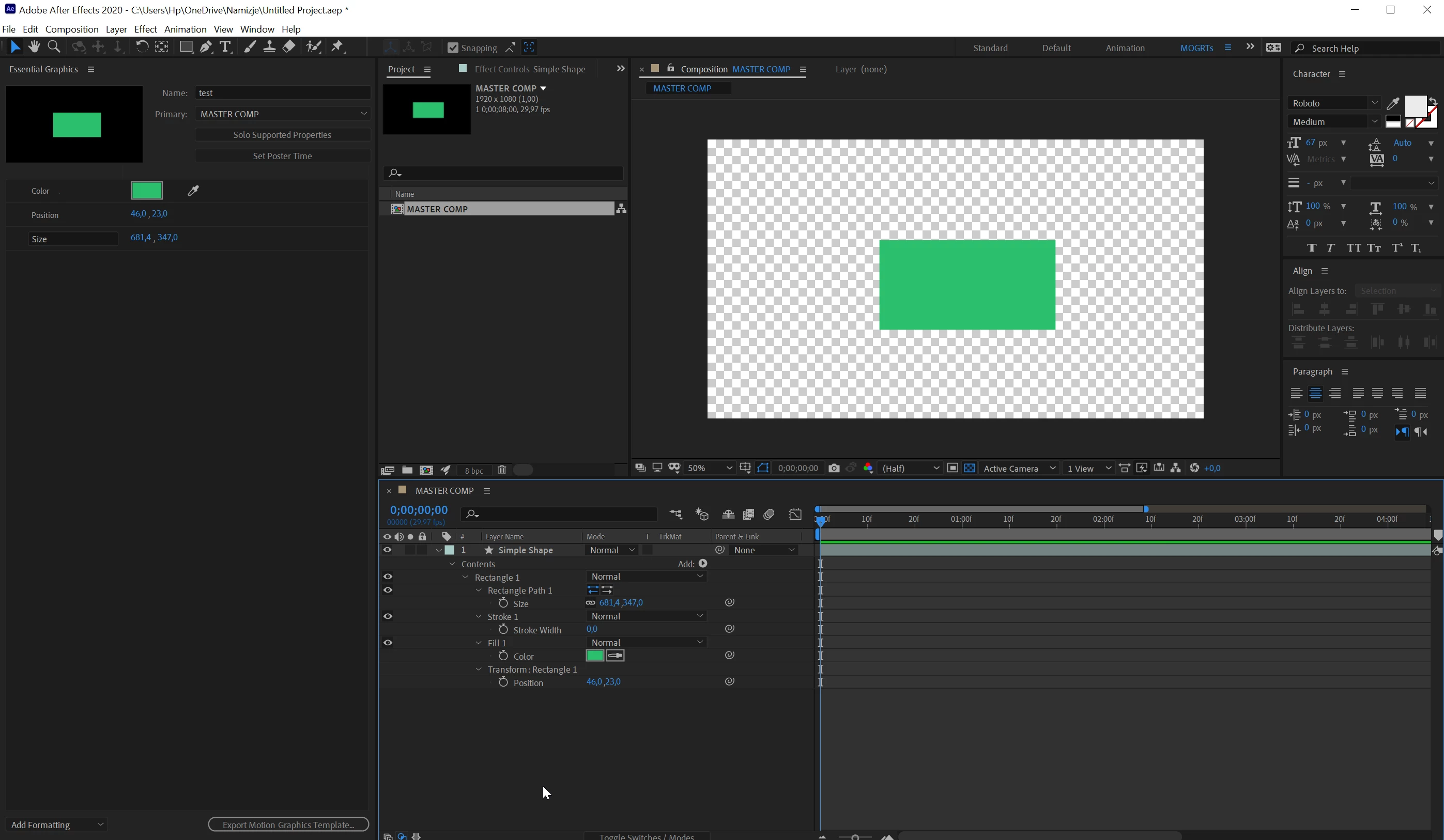

saso.goricar
March 6, 2021
Hello, even if I create a new file from scratch, and just put some properties in Essential Graphics and export Motion Graphic Template I always get this error. I tried to uninstall AE and install it again and the error didn't disappear. Here is my picture of this simple file, when I get an error. Thanks.
March 7, 2021
It's not going to work until you fix your preference settings to allow scripts to write.

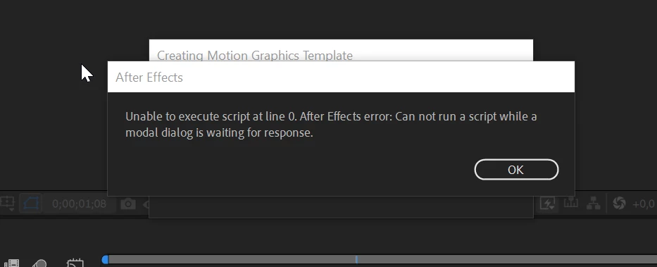

March 5, 2021
This is an error.
