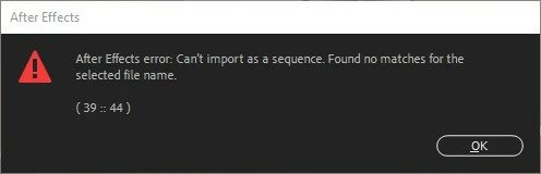

After Effects error: Can't import as a sequence. Found no matches for the selected file name.
I get this error when importing an image sequence in to After Effects 2020 (Version 17.0.4 (Build59)). The funny thing is that it works just fine when importing the very same image sequence in the previous version of After Effects (Version 16.1.3 (Build 5)) ... This means I can't use the latest version of After Effects, since I work with image sequences all the time. Have anyone else encountered this problem and/or have a solution or workaround?

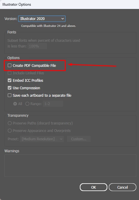

after struggle for couple hour, you need to save as again your file with with checkbox

Mar 17, 2020 10:12 AM UTC
You have not provided any info about the actual file naming, file types, storage locations and so on, so we can't realyl tel lyou anything. Aside from AE being buggy as hell these days something specific could be going on that could be easily fixed like renaming a folder. Impossible to know with no specific info at hand.

Mar 17, 2020 11:58 AM UTC
Sorry about that. I will try to fill in the blanks here ... The syntax of the file names in the image sequences I use all look similar to this: 'Speaker04_Handle_00000.jpg'. The error appears no matter the file-type (JPG, PNG, TIFF etc.). The image sequences are all stored on my local SSD harddrive (C:). I am running After Effects in the latest version of Windows 10 (64 bit) on my workstation, which is a DELL Precision / Intel Xeon CPU E5-2687W v4 @ 3.00Ghz. I am not sure if there are any other information that would be relevant to solving this problem, but please let me know if there is. 🙂
