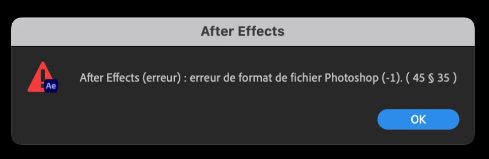

After Effects error: Photoshop file format error 1. (45::35)
Hello community,
I opened a .aep file that I hadn't opened in 2 to 3 months. Upon launch, I didn't receive any message indicating missing files, and I don't have any Photoshop files. However, when I start the preview, it works for a while then abruptly stops and displays an error message.
I cleared the cache, uninstalled and reinstalled After Effects, updated Camera Raw, but to no avail.
I'm lost because I can't seem to solve this problem. I've searched everywhere on the internet and haven't found a solution to my problem, so I hope you can help me here. Thanks in advance.

I had the same issue. Mine came from an image file inside my composition that had the extention .avif. Once I replaced that with a .jpg problem was solved.

Just came across this problem as well. Didn't have any .avif files or .jpg only pngs from photoshop. When I selected all my images that were in my project, I selected "Reload Footage" and I didn't get the error again.

When this happened to me I found what seems a quick fix. I found couple of DNG Photoshop files were not rendering on the preview.  (Comp display was just Black). When I reloaded the DNG files in the Project window it showed up again and did not get the File error again.

Yes! if you have something different from JPG, choose Reload Footage on the project window.
Thanks! Worked for me too.

Hi, merci pour ta réponse
En effet, c'était bien la source de mon problème, merci pour l'aide

I'm having the same issue, and after clearing cache, restarting, etc. to no avail, I tried opening in a prior version of AE (23.6.5).
It yelled at me that this wasn't allowed, so I reopened my file in v24.3. This is the same version that had been giving me issues.
For some reason, everything is now working fine.  No more error message. This seems too dumb to be a solution, but I wanted to provide it on the off-chance that it works for you.
