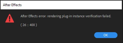

After Effects Error : Rendering plug-in instance verification failed (26::400)
Hey guys
I constantly get this error and it has already become annoying that appears while I am working, the error appears and sometimes I have to restart After Effects to be able to move on ... Any idea what could be causing it?

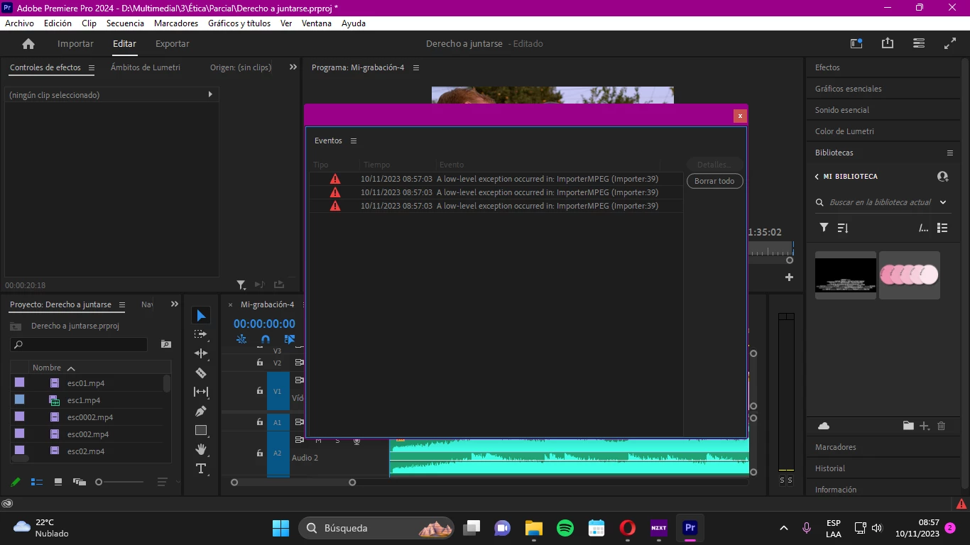

con.cancan
Nov 10, 2023 12:00 PM UTC
Se suma a mis problemas ahora premier, acaso no me conviene pagar el paquete y bajarme el pirateado? Antes no tenia estos problemas, ayuda por favor!

Feb 12, 2024 3:16 PM UTC
i an not suceeding in startin after effects
i get the same message all the time
how do i proceed ?

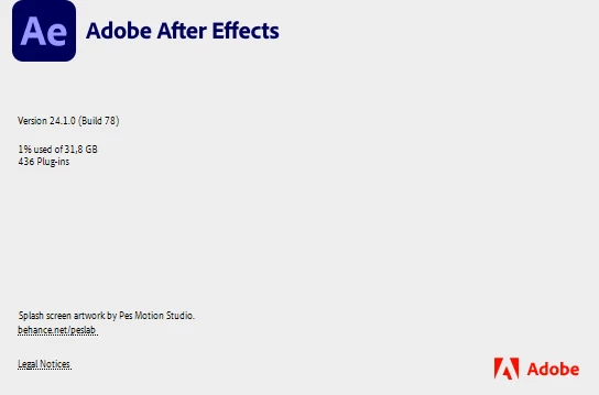

Feb 12, 2024 3:21 PM UTC
my after version is the picture attached
