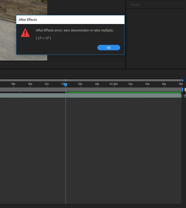

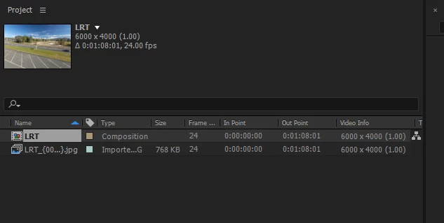

chesterb72279385
December 28, 2016
I have the same issue.
I want to import a jpeg sequence from a timelapse for stabilisation. I interpret the footage at 24fps and create a new composition to work with.
The issue is that clip is the right size (1:08) but the images in sequence stop at about 4/5 the way through (0:54) and the rest is just black. The clip is not compressed the images from this point on do not register so its missing the last 12 seconds.
The funny thing is this is the exact time that the entire clip would be if it was 30fps. The images in the green bar above are just black and dont render or export. If i try export the clip it just fails at this point also.
If I import and render at 30fps this dosnt happen, only when it is set to 24fps.
Working in AAE 14.0.1.5
Running Windows with 32gb Ram Intel i7 6 core and GTX1080
I have rebooted, reinstalled (multiple times) and reset preferences.
Any help would be massive!!

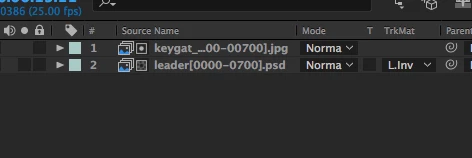

January 10, 2017
I have this error as wel. When combining a black/white matte through using "Luma Matte" for creating an alpha channel in the composition. In after Effects 2015 this works in the 2017 version, I get After Effects Error: zero denominator in ratio multiply. ( 17 :: 17 ). Reinstalling, Rebooting, nothing works. The 2015 version is on another system, I run the 2017 version now, and this project would not open in 2015 version.
January 11, 2017
I Always use JPEG for Luma mates. I found out, that creating a MOV file solves this for now. Not ideal.
