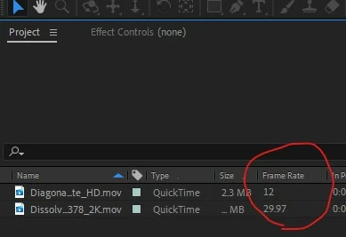

Looking at your clips in the Project panel, you'll be able to see the frame rate of each file.

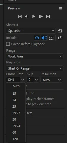

You can also Preview your compositions at frame rates other than the one it's actually using. Make sure this dropdown is set to either Auto or to the specific frame rate your composition is using.
Hopefully this is a good start at helping you pinpoint your issue. Based on your explanation, I'm guessing you have assets at a variety of different frame rates, and/or may be creating your comp and /or previewing at a weird frame rate. See if that helps you sort things out, and come on back if you need some further clarification.
