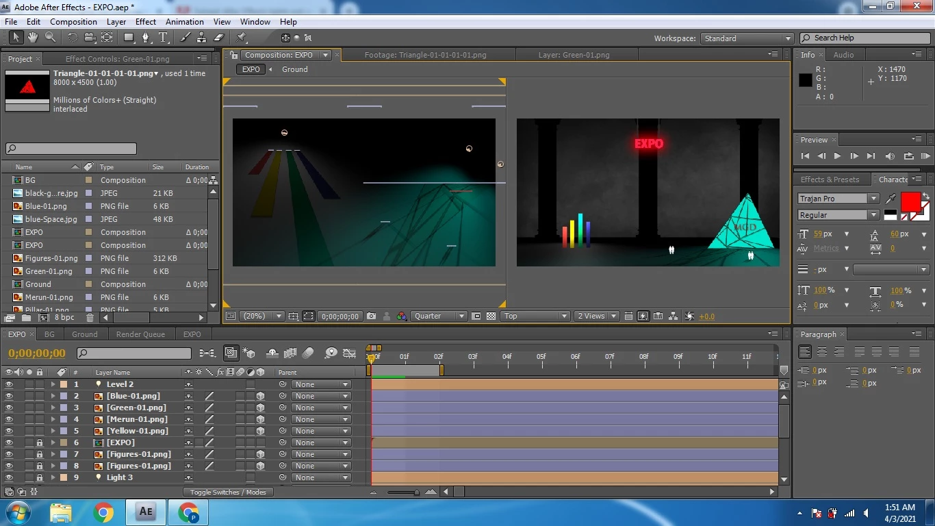

    I Can See The Light Rays In Top View But I Cant View The Light Rays In Active Camera, I have Not Set Any Cameras.. That Is Only Camera View, Everything Is Turned On In My Layers Specially Accept Lights, Accept Shadows, Light Transmission Everything....Anyone Have Any Idea?
    Thanks In Advance For Your Answers
    Apr 2, 2021 10:02 PM UTC

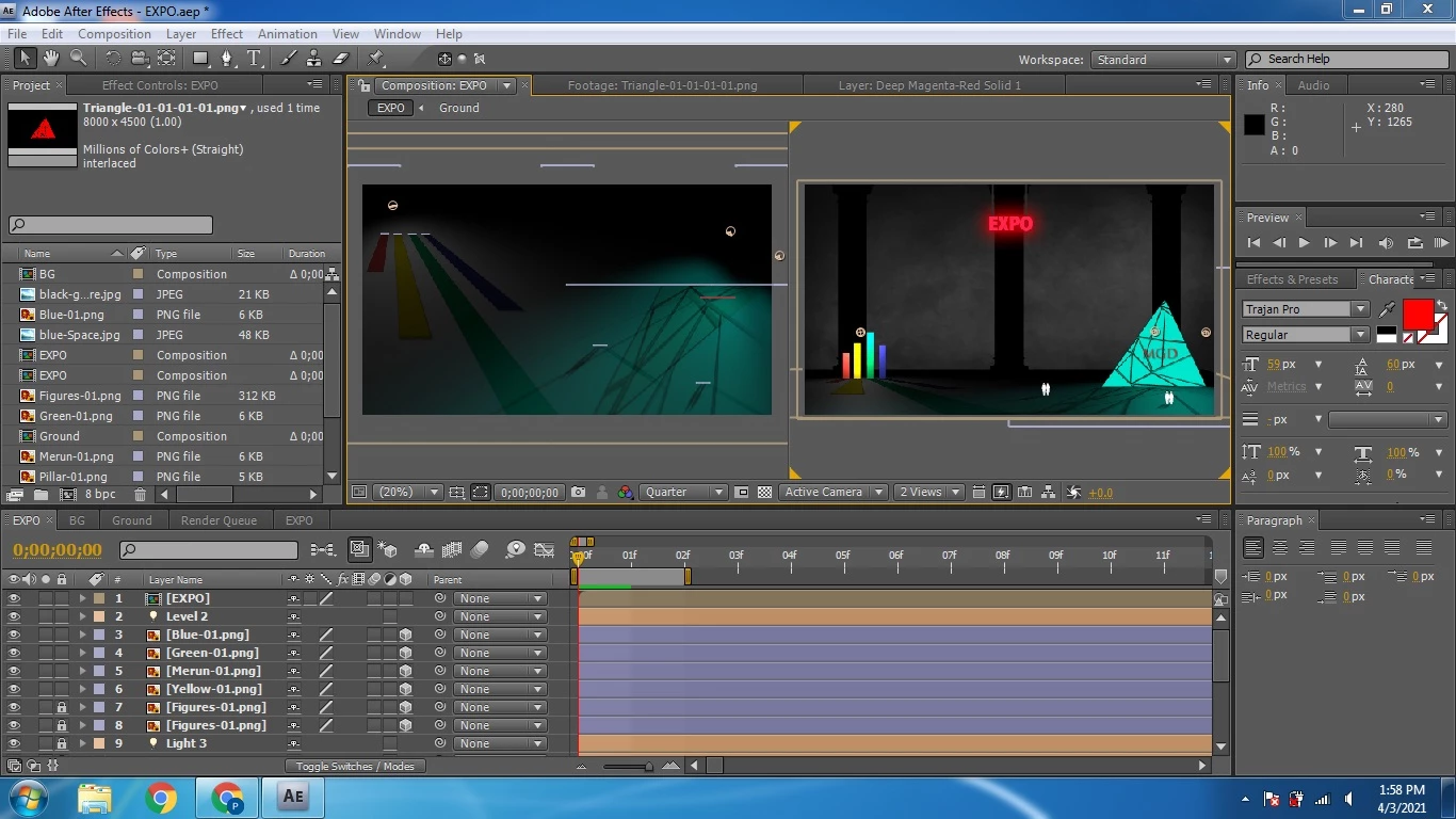

    Move the layer "EXPO" to the top, it looks like it's breaking 3d space between layers at top of "Expo" and at the bottom of it
    Apr 3, 2021 8:32 AM UTC
    Thanks a Lot Brother... Its Working.......!!!     But Still I Cant Understand The Mistaken Why Its Happened? Please Describe Brother If You Have a Time...
    Thanks Again For Your Valuable Timings....
