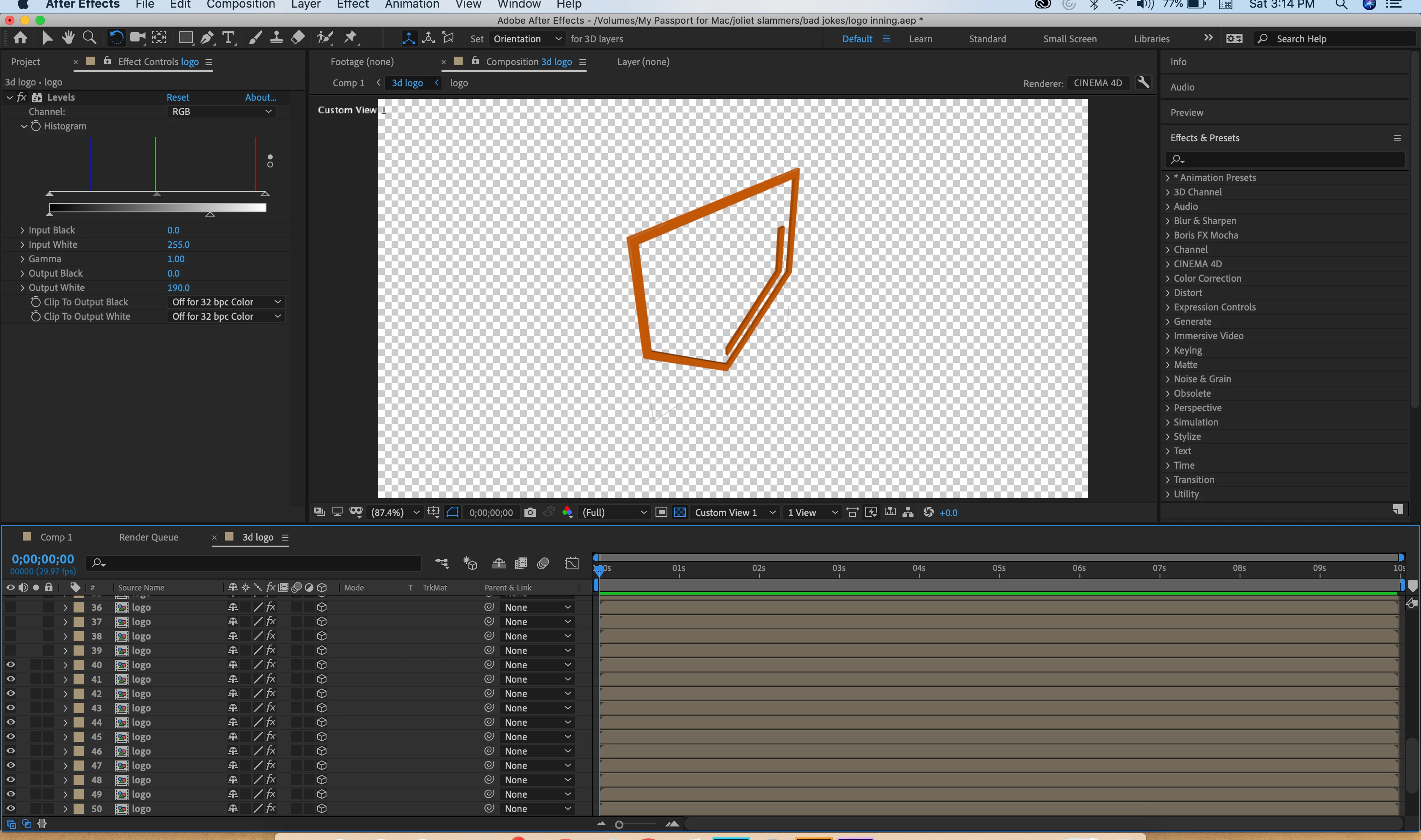

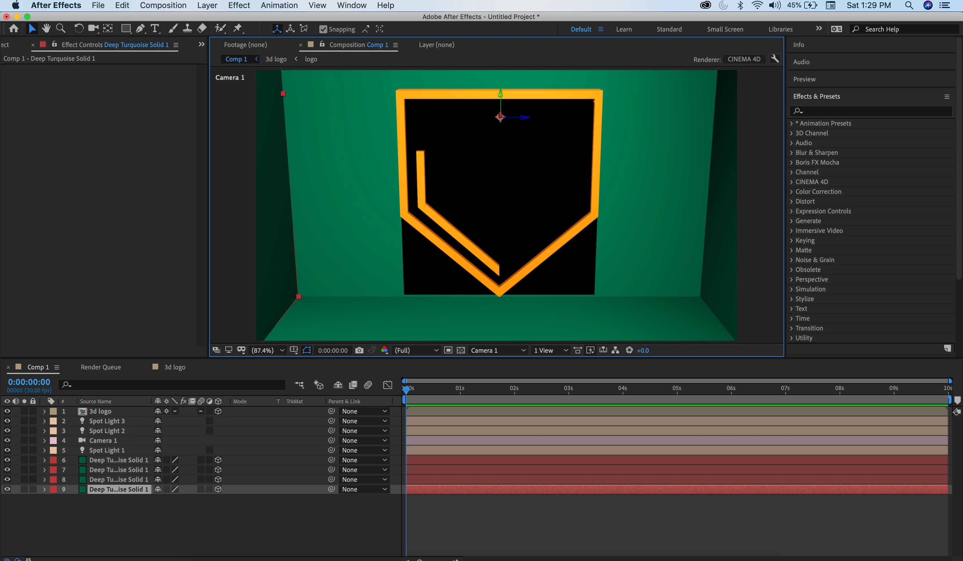

I was making a graphic in after effects and I need my logo to be transparent. When I first put the logo in it was, but then I made it 3d and now it turned it black in the background. I tried turning on the transparency grip in the logo comp but it doesn't do anything. How do I make my background transparent again? I added a picture to show you what it is doing.

If you are duplicating layers to create depth then you should be using the Classic 3D rendering engine. If you take that logo into AI and make it vectors or you just trace a shape layer you can extrude using C4D. You can also set up a layer and a camera and export your comp to C4D, then do the extruding there.
Try changing to the Classic rendering engine first. That will probably fix it.

I think it is definitely user error. So I went back to my Logo comp and in order to make my logo 3d I just made a bunch of duplicate layers. It stays transparent until layer 16, then it turns black after that when I add more layers. Is there a way that it can do more layers? The Youtube video I watched to learn to make a 3d logo had like 90 layers and theirs didn't turn black.
