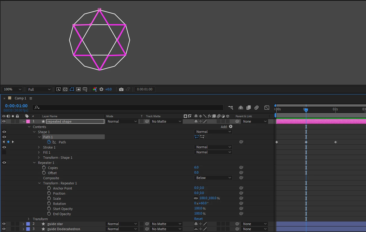

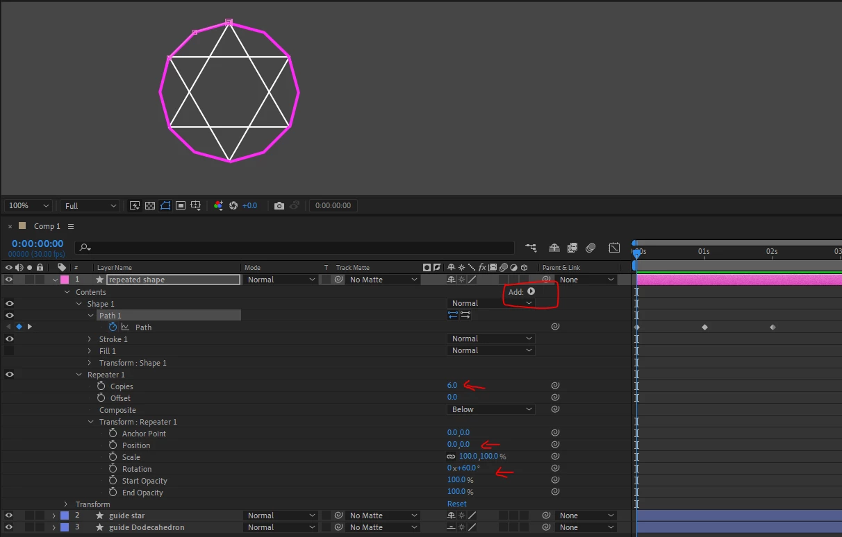

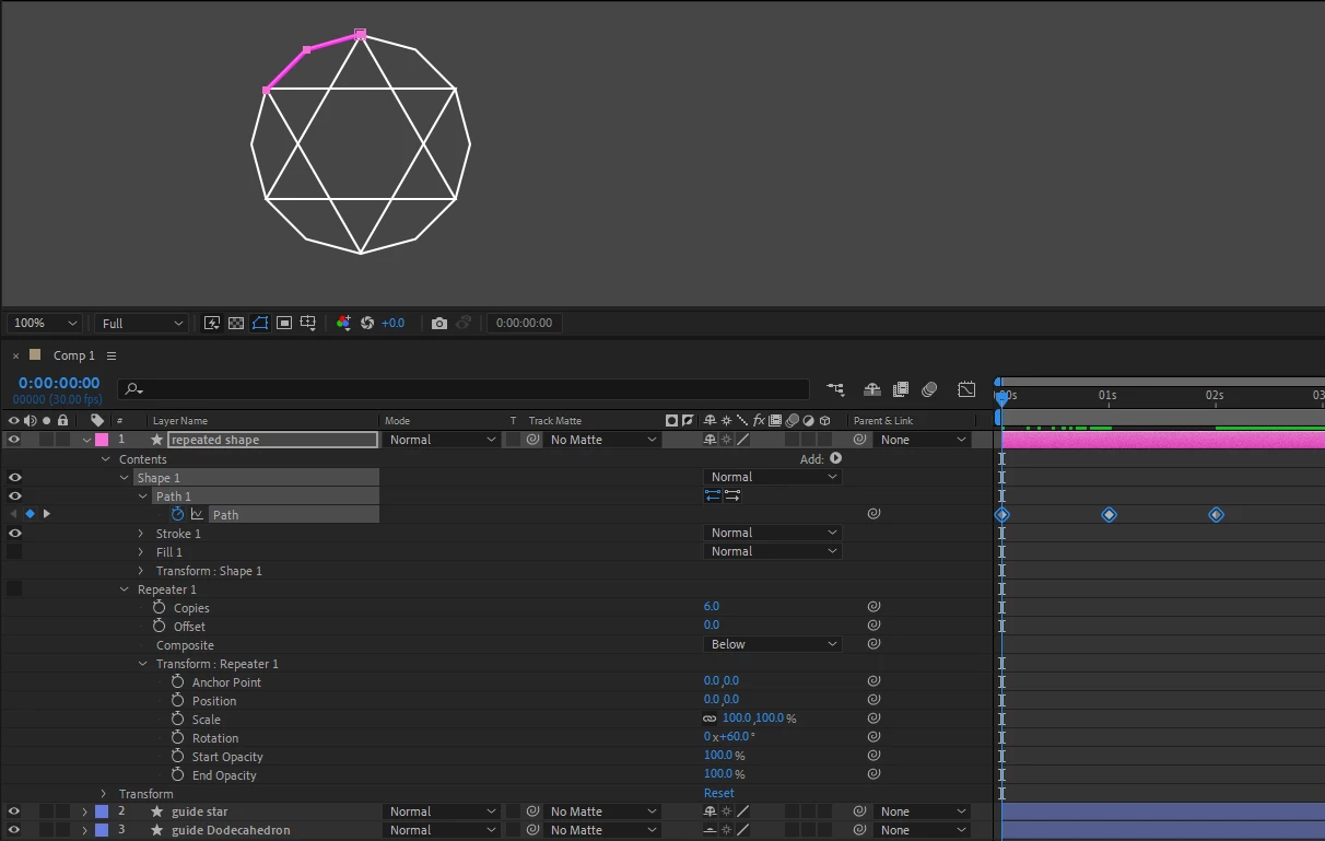

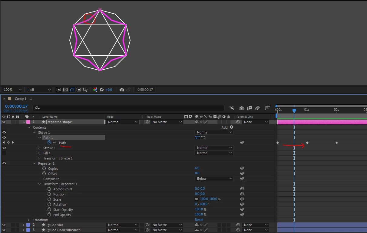

Adding a few screenshots of the repeater method! It rebuilds just the outer edges of the shapes.

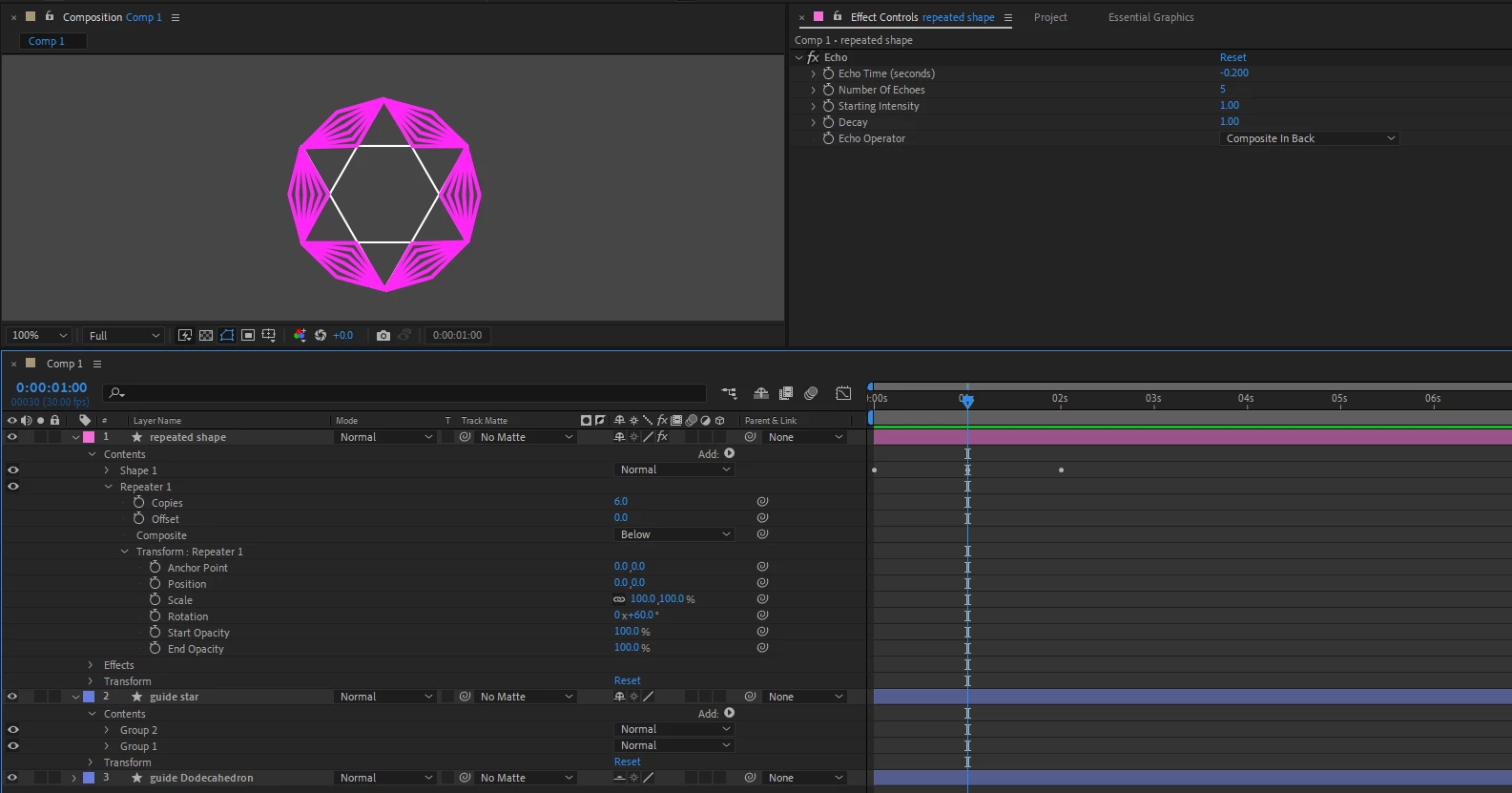

I'm making some assumptions about your final look, but if you want to get something like the AI blend effect (that animates) you can play with the effect time --> echo after you have animation on your layer. That's the last screenshot.
