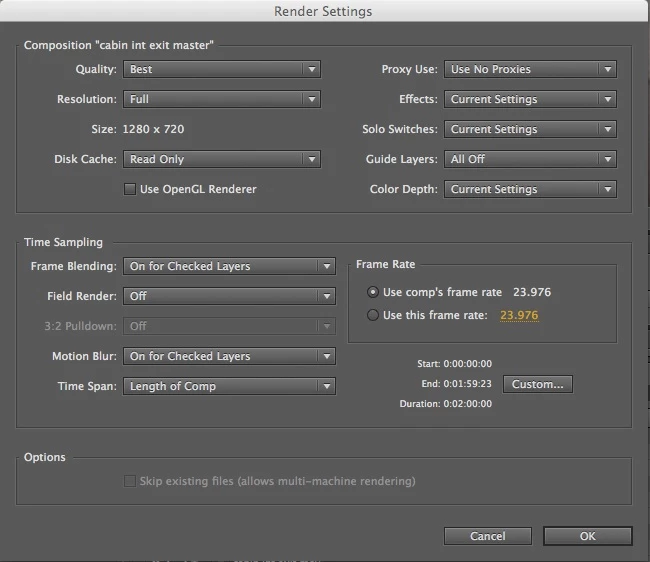

1280 X 720, Square Pixels, 23.976 Frame Rate, Rendering Plug-in: Advanced 3D. For my preferences, I don't have "render multiple frames simultaneously" checked, and I keep 4 GBs of RAM reserved for other applications. I also have OpenGL disabled.

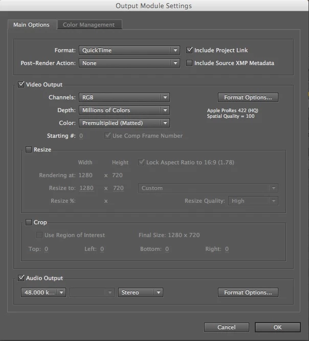

And finally, here are some screenshots of my Render Settings and Output Module for this project:

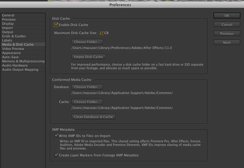

    Hi Mortisfilm, over the longer term, you might want to consider adding more RAM.
    I would start with a clean slate here.
    I would go to Preferences/Media & Disk Cache and then click on the "Empty Disk Cache" button in the top portion of the resulting screen.
    Matt

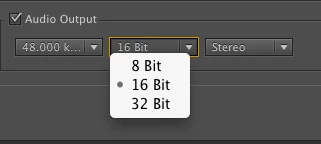

    The weird thing in your screen shots that I see, is that in your Output Module Settings, the audio bit-depth settings seem to be grayed out for some reason. Are you using some sort of audio hardware that is customized, or perhaps some compressed audio in your project? Here's what I mean:
    Thoughts? Aside from that, your project does sound as if it is pretty intensive, so I'm sure the problem could be occuring elsewhere...

    Not sure why the audio bit-depth settings are grayed out -- perhaps it's because my render is set to output using the AAC Audio Codec -- when I have that selected, I notice that the audio bit-depth settings are grayed out, so perhaps that's why nothing shows up there.
