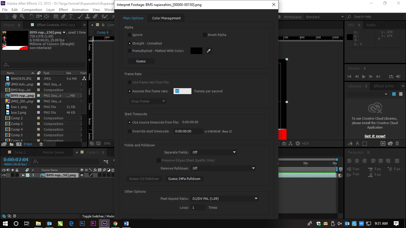

    We're going round in circles here. Your question said:
    They ask me to make it on PAL D1/DV 720x576, and they ask me to export  it in PNG Sequence. I did everything and everything went well. but when I  importing the png files. it's only showing 5 seconds. but I export a  6-second video
    1. PAL means the composition should be 25fps (interlaced) which is confirmed in your screenshot, but for some reason you're not exporting to a PAL-compliant video format.
    2. 576i PAL means a pixel aspect ratio of 1.09 and interlaced output, which means you have a bucket load of problems saving to a PNG image sequence unless you know exactly what you're doing.
    3. You talk about importing the PNG sequence, but you haven't shown us the settings for that piece of footage in the project panel, which as I said before is critical. If it's not interpreted at 25fps, of course it will be a different length. Image sequences (except for specialist packages like cDNG) never have embedded frame rates, everyone using them has to be told what interpretation to apply. After Effects will use the system default in the preferences panel, not some value from the project. You will find it's still at the factory setting of NTSC 29.97.

    HI Thank you, so much. oh my god, you guys are lifesavers. I check the frames just like you said. I export it in 25 frames. but when I import it shows as 30 frames. I change as you say to 25 frames. the suddenly it went right. oh my god Thank you soo much. bau I have a small problem the PAL video is a blur after I export it. one of my friends said that it will not be a blur on Television. is it normal to be blur?.  I have to give this today. Thank you again.

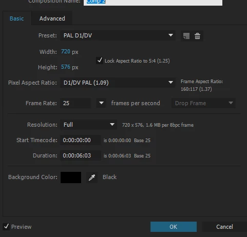

    Hi, thank you both a lot. these are the settings they ask me to use

    Obviously you need to tell After Effects what frame rate to use when importing an image sequence; it doesn't ask at the time and just applies the system default so you have to go into Interpret Footage and correct it.

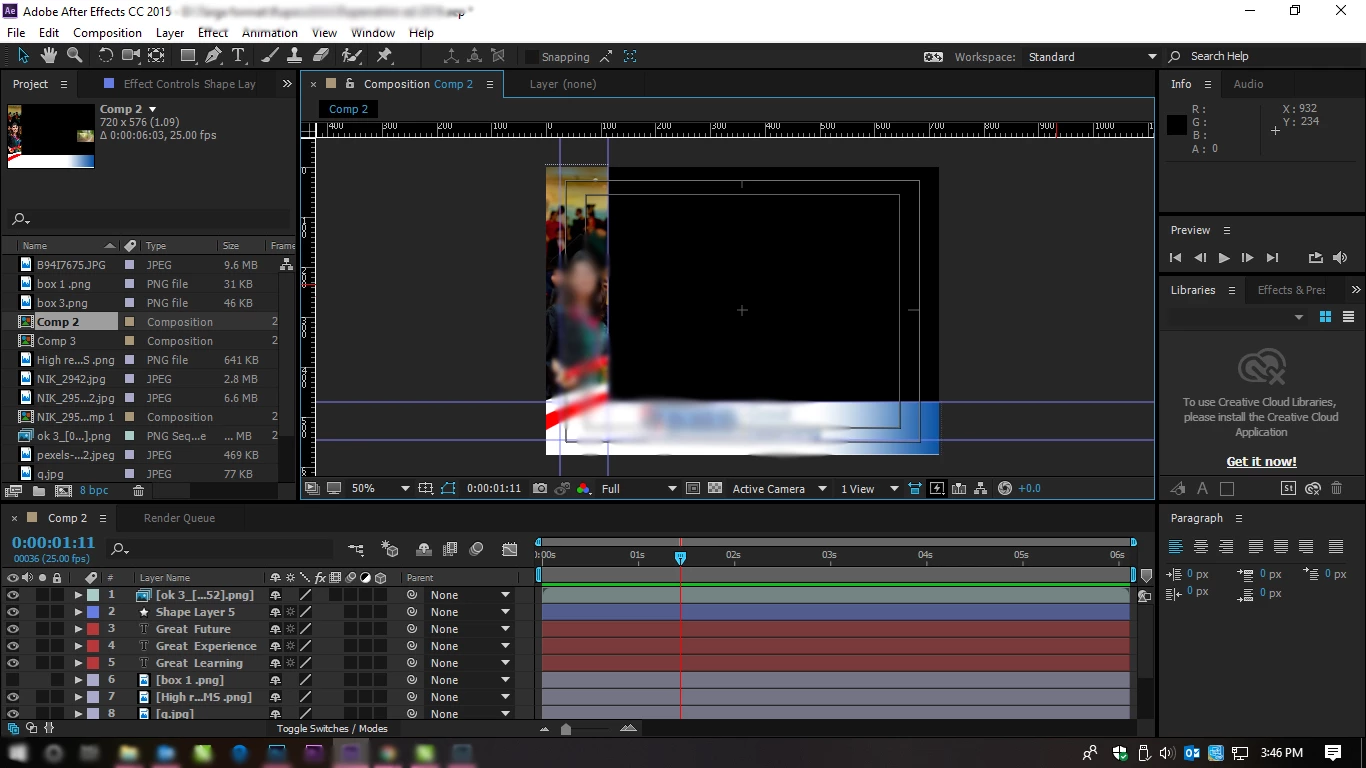

    Jose Panadero
    May 27, 2019
    Could you upload a screen capture of your timeline with the layers? Also, what kind of footage are you using (ie, image sequences, graphics, video, etc)?

    May 27, 2019
    Hi these are the settings they ask me to use
