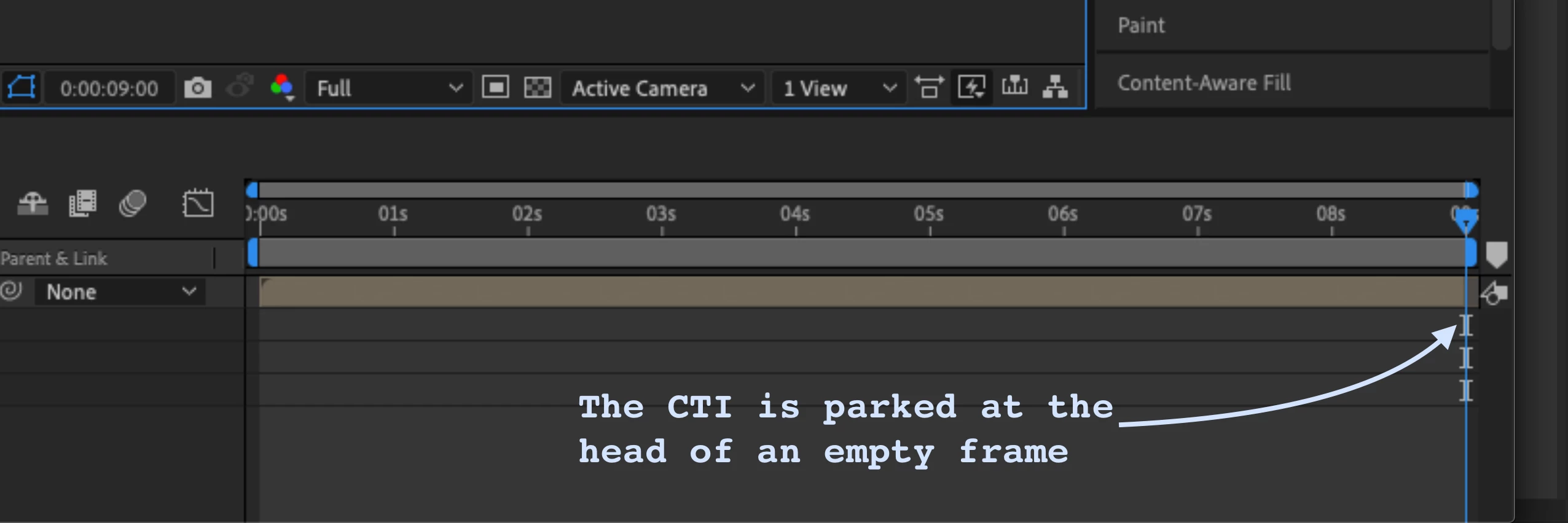

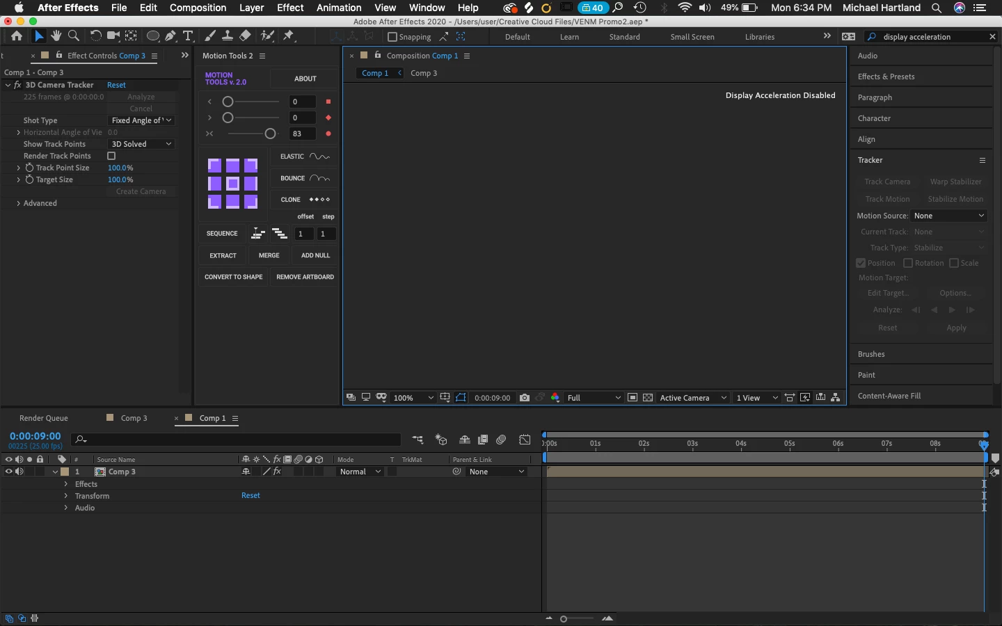

In the first screenshot, the CTI is parked at the end of the nested Comp 3 right at the head or start of an empty frame so nothing would show in the Comp Panel.
The 3D Camera tracker is also not selected in the Effects Control Panel so if there was a warning banner or any tracker points they would not show up. You also have set the Magnification Ratio to 100% instead of Fit so the comp panel frame could have been moved completely out of the Comp Panel.

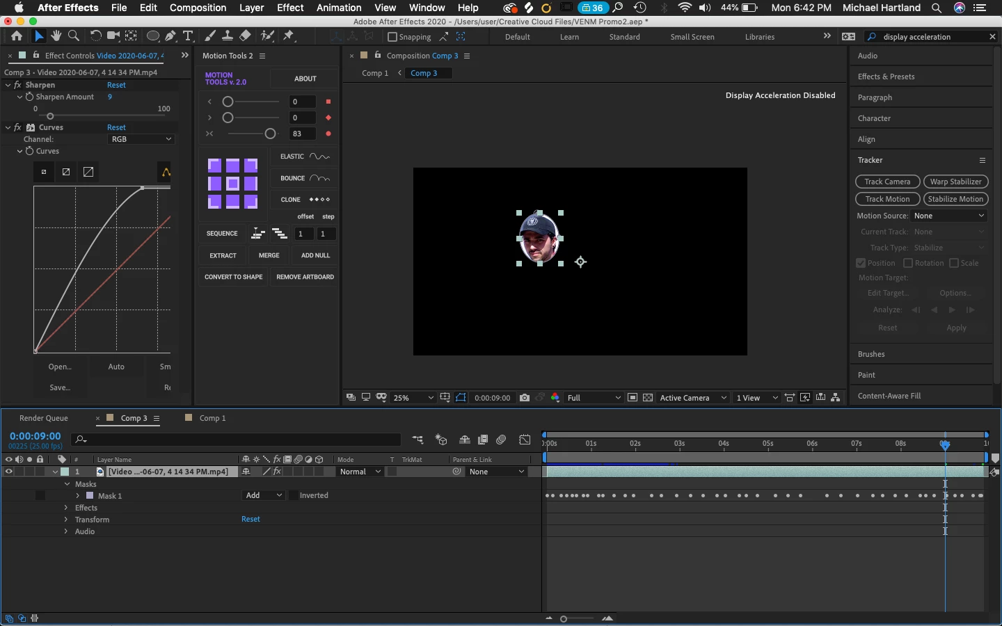

In the Comp 3 screenshot, you have masked a just the face so I'm assuming that you are trying to attach some kind of 3D object to the face. There is not much detail in the face and it occupies a very small portion of the screen so I would be surprised if you could even get a decent track with that footage. The CTI is parked at 9 seconds so the time matches the time in Comp 1, but there is not much more that I know about your workflow.
