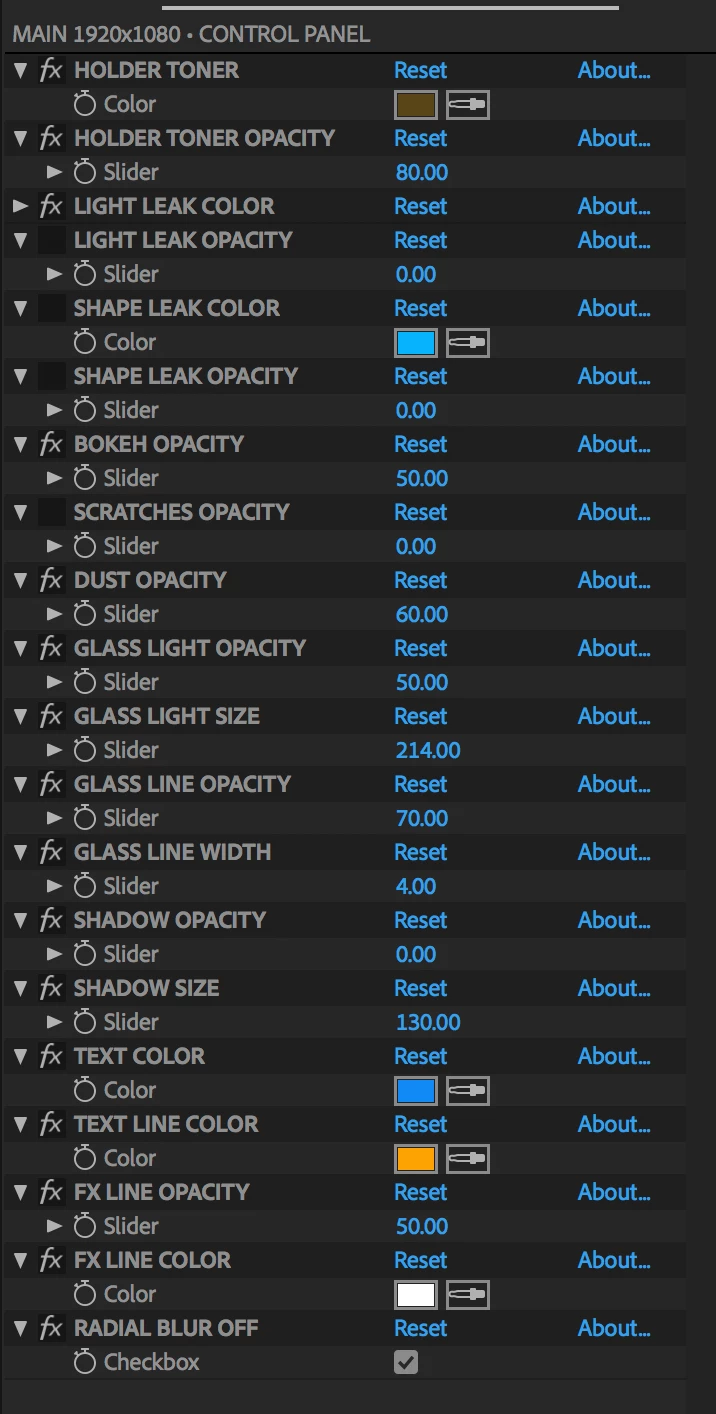

    Then there is a control panel with adjustments (Picture below)

    Jan 15, 2018 8:13 PM UTC

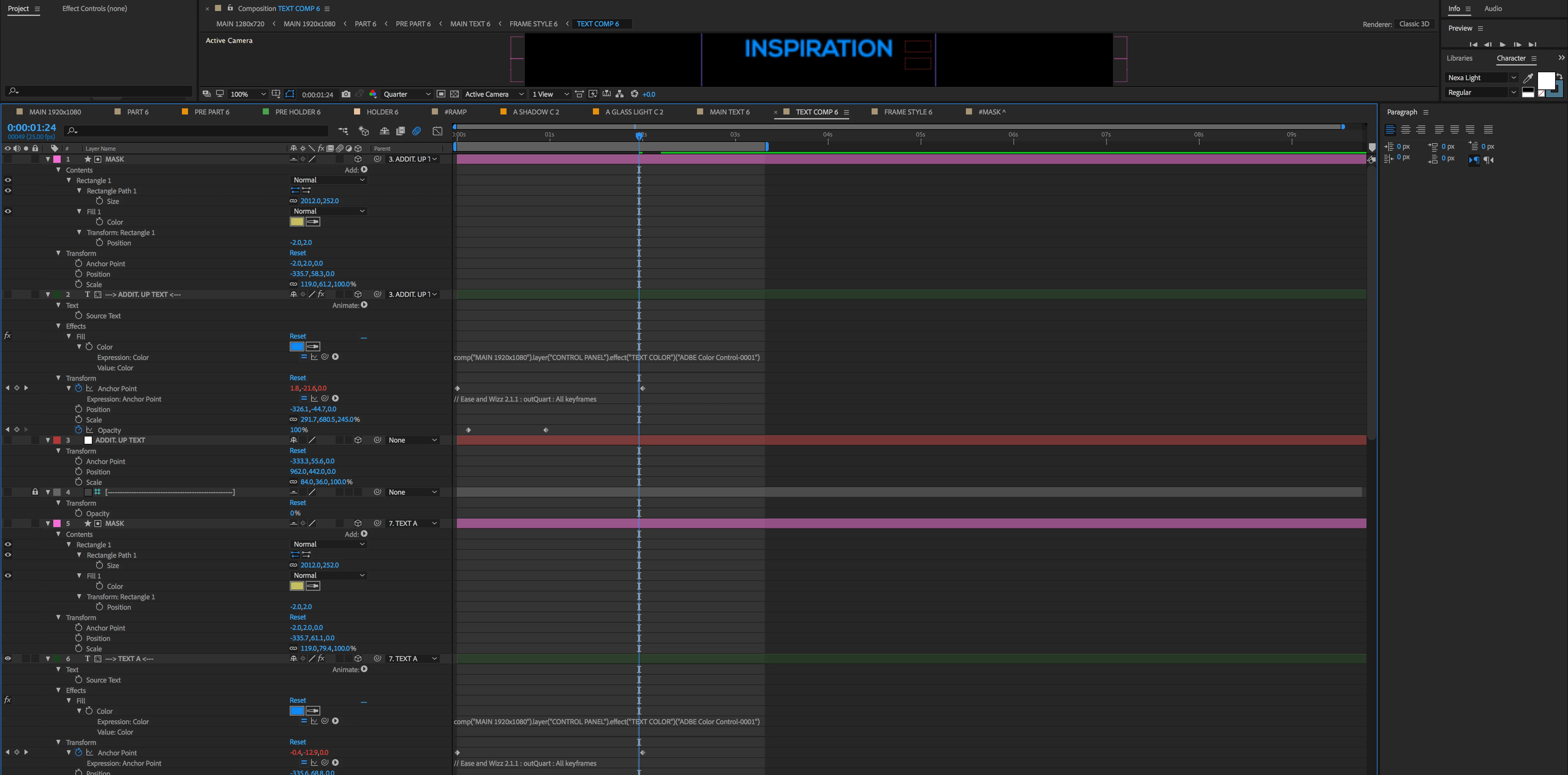

    Those are mostly expression sliders.  So it looks like you're working with very complicated template with tons of expressions & all sorts of who knows what going on.
    There really is no way efficient way for anyone to trouble shoot without the actual template.
    And there may not be anything "wrong" per se.

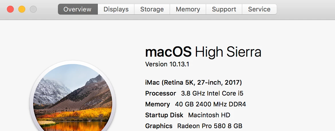

    It could be that you i5 processor is struggling.
    That's not to say that an i7 or the beastliest of CPUs wouldn't ALSO be struggling.
    There's really no way to tell with so much going on "under the hood" in the template.
    Your best bet is to follow the suggestions I already gave of turning off layers and effects that
    you do not need to preview & trimming layers.
    I think this is just one of the "Cons" of working with these fancy templates.
    They can be very system intensive and very, very difficult to troubleshoot since alot of what is happening is hidden or otherwise
    unknown to the end user.

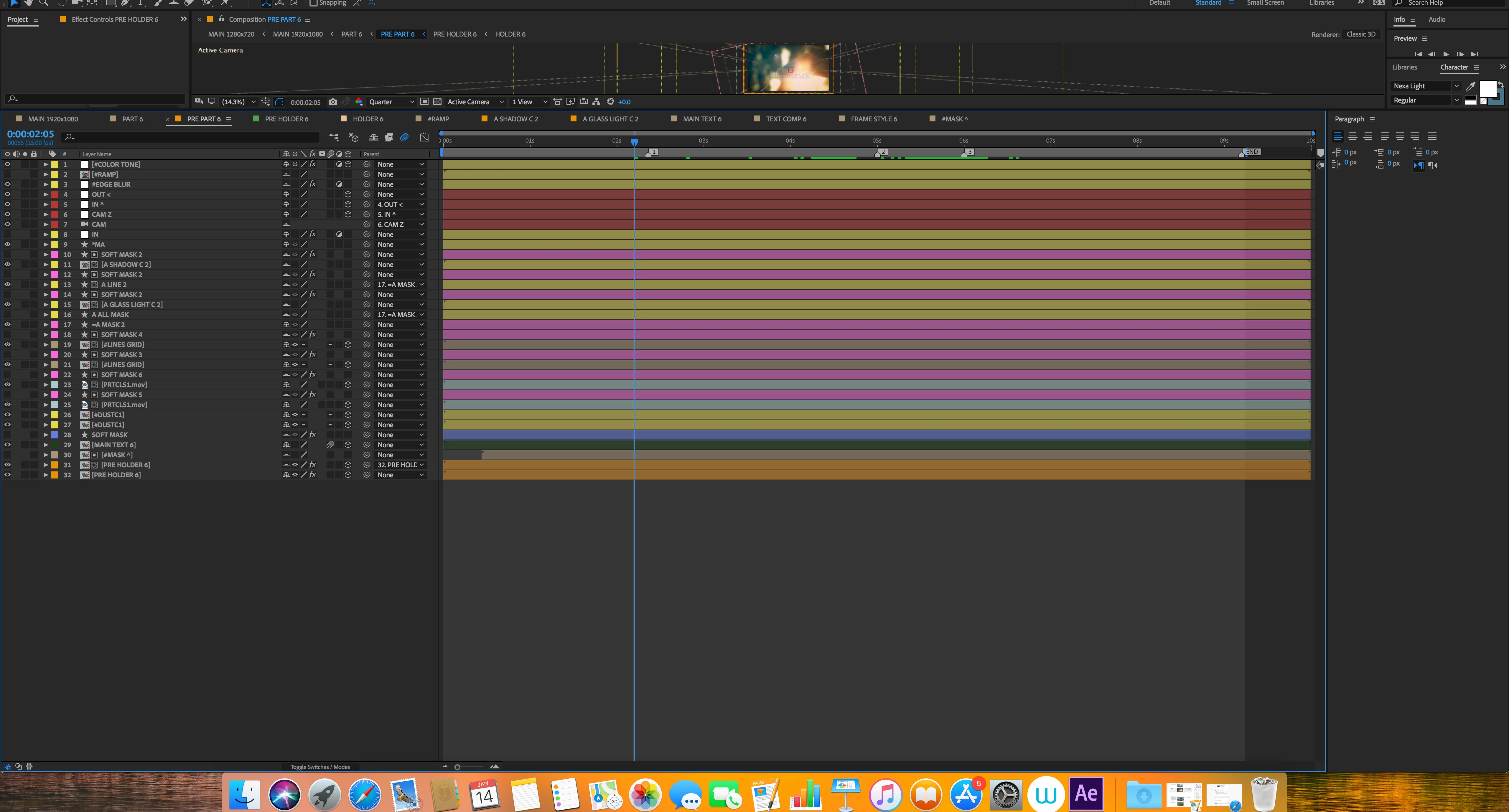

    Jan 16, 2018 1:11 AM UTC
    Image size is also a contributing factor. Setting your Composition Panel's resolution to auto and running 25% or 50% previews is going to help. You have a boatload of layers in a 9-second comp and a lot of them are nested comps so I'm assuming that there are a lot of things going on. The project may be a lot more complicated than it needs to be, or it could just be one of those templates that take forever to render.  If the latter is true just try and make sure that all of your images are at or near 100% scale at some point in the project. This will really help with render times.

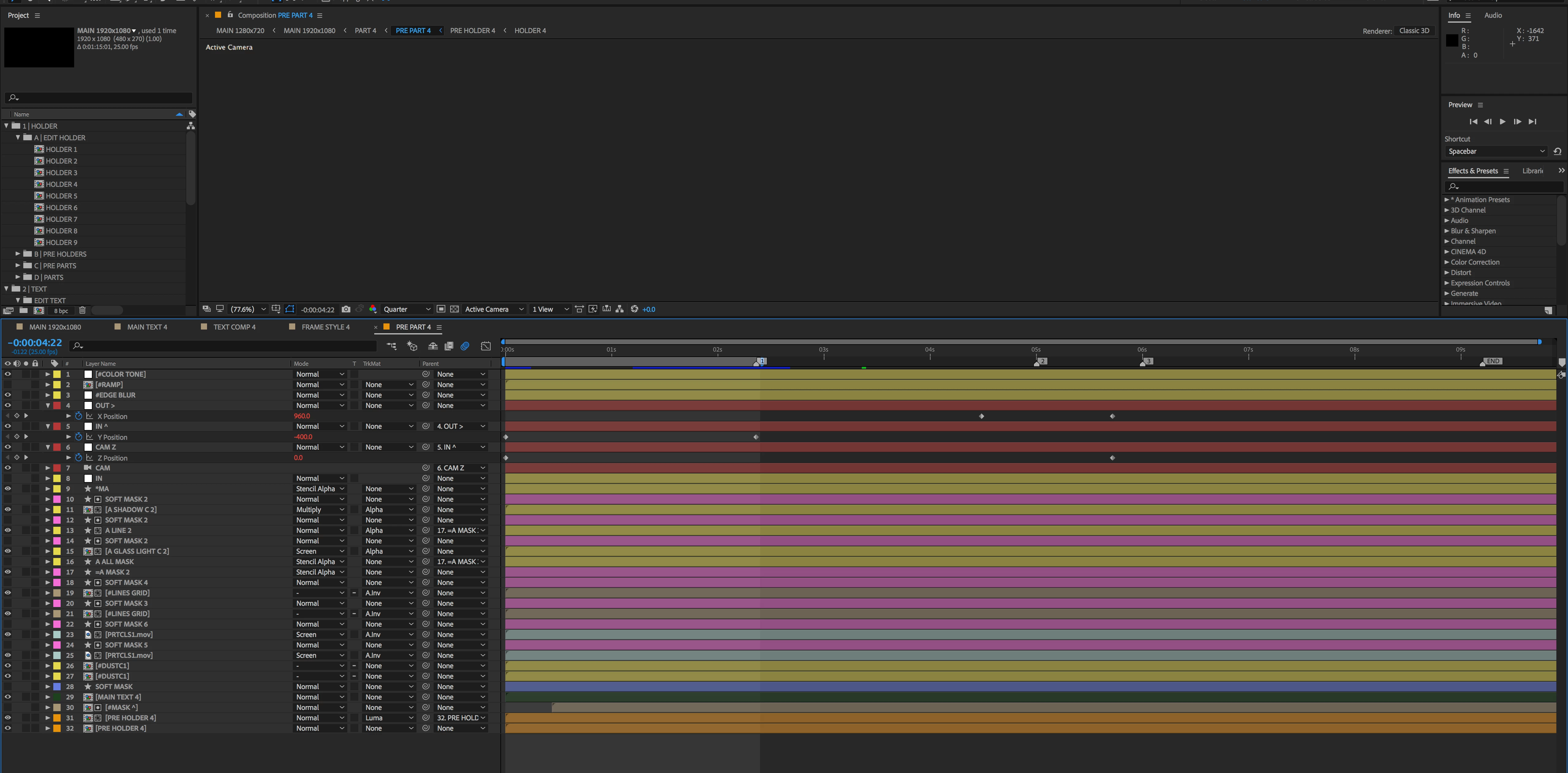

    Jan 15, 2018 12:23 AM UTC
    Really can't tell much from that screen shot.  What in all those comps?  What effects are being used?  How big are the images?
    All that information aside...something that used to slow me down was having everything the entire length of my project.
    Trim the in points and outpoints of all you layers and compositions only to where they're needed so after effects is not evaluating every layer of every comp for the entire length of the project.
    So that's a step that applies universally.
    Also only preview what you need to.  For example lets say you do some heavy color corrections.  You can test the correction on a single frame, get it how you want it then turn that effect or effects off until you're ready to render.
    Apart from that there's really no way to tell what you have going on in the project in terms of effects and assets.
    ~Gutterfish

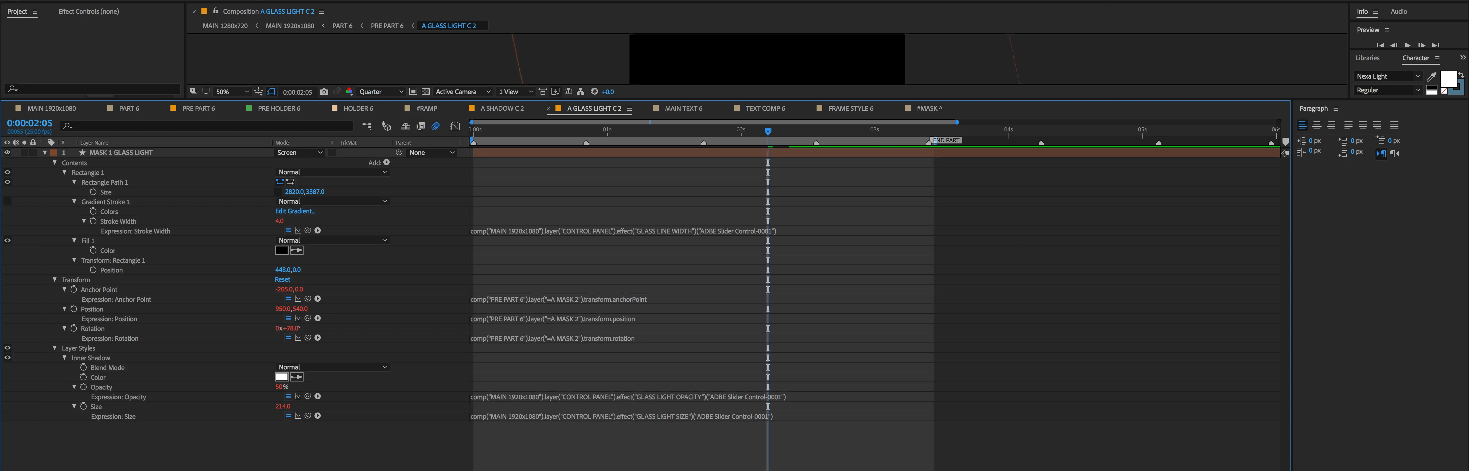

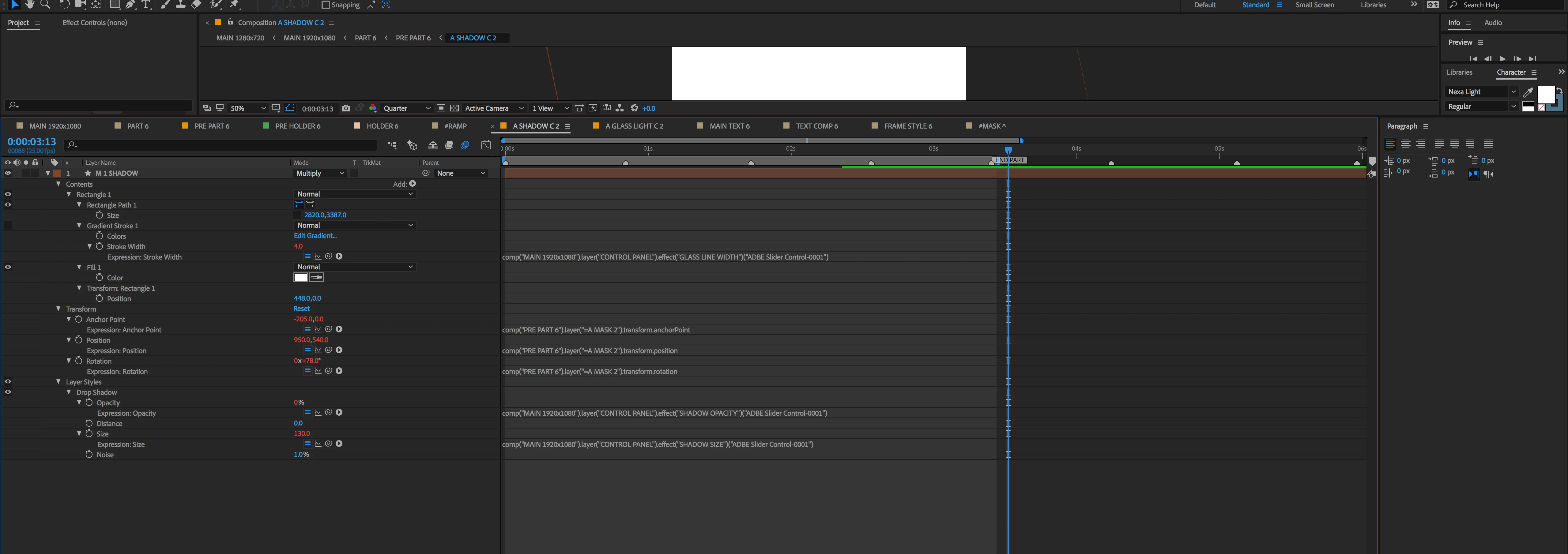

    Here are pictures of the comps
    Assets are a few images and videos (1920 x 1080) max resolution. 3 images and 3 videos so far.
