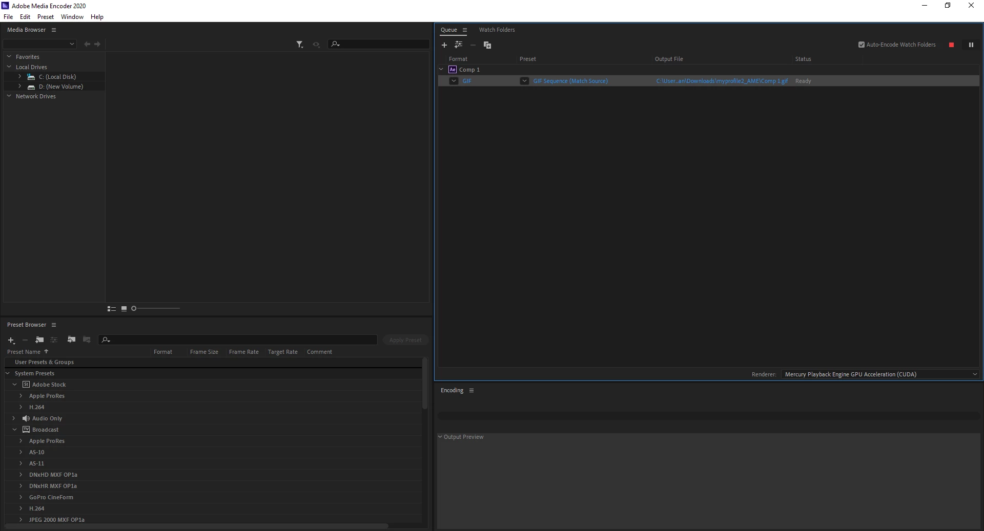

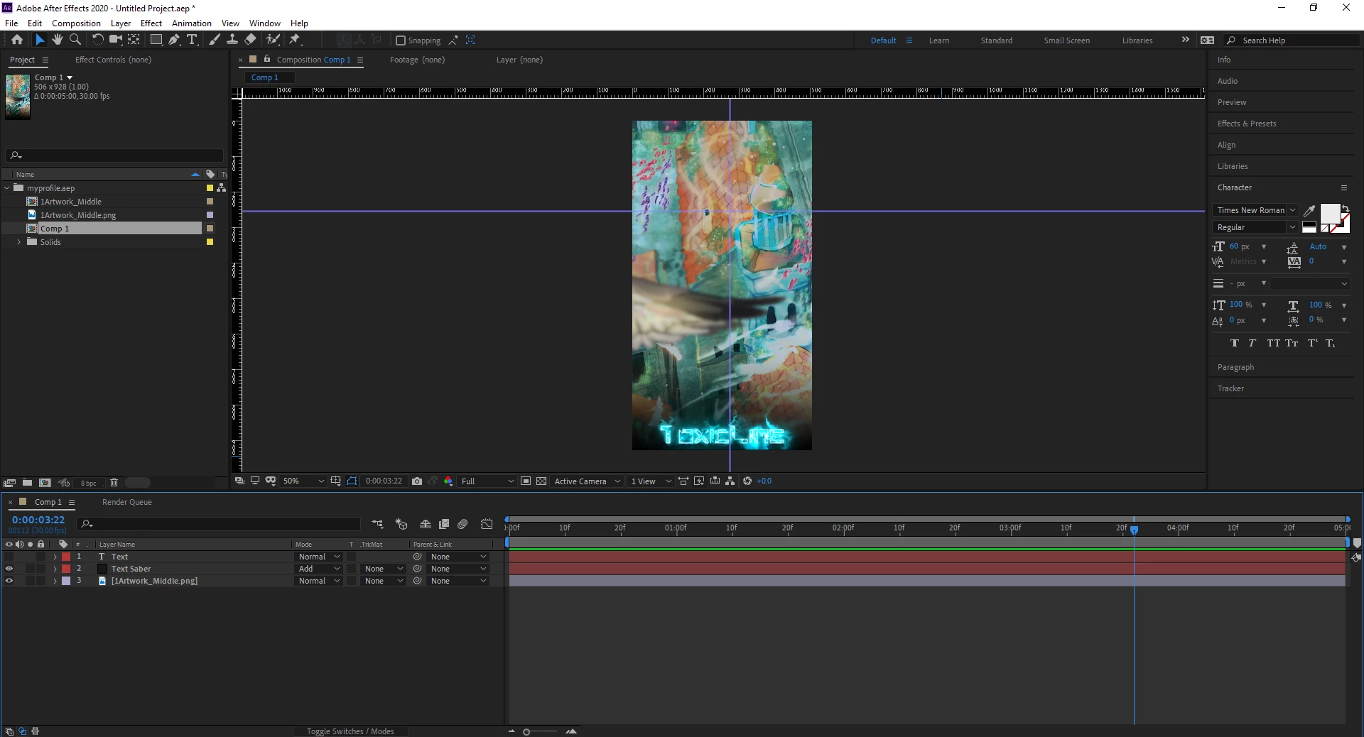

So I'm using after effects to create some animated text to add to my steam profile, and I tried using the Saber plugin to create a cool effect. All was going well up until I tried to render the project in Media Encoder, at which point my project decided it didn't want to even attempt to render. When I moved my project into Media Encoder, I tried two things; I started rendering with the file destination set to my D:// drive which is my hard drive with a ton of space, and I tried to render with the file destination set to my C:// drive which is my SSD with around 3gb left. In the first case, it tried connecting to Dynamic Link, which just sat there forever, not finishing the connection. In the second case, the bar was stuck at zero percent the whole time and no matter how long I waited, it wouldn't even move a little. I've exported projects through Media Encoder before so I'm not sure why it didn't work, anyone got any ideas?

Well, does it actually render without the Saber plug-in? Sometimes third-party plug-ins cause odd behaviors due to their workarounds in accessing non-native AE data...
Mylenium
ToxicLime
ToxicLimeAuthor
February 2, 2020
I think I can render regular projects just fine but the problem is that the effect I'm trying to create uses the Saber plugin, so I'm not sure what I can do.
February 2, 2020
Are both your After Effects and Media Encoder up to date?
ToxicLime
ToxicLimeAuthor
February 2, 2020
Yes, they should be. I installed them not too long ago. Is there anyway to confirm this?
