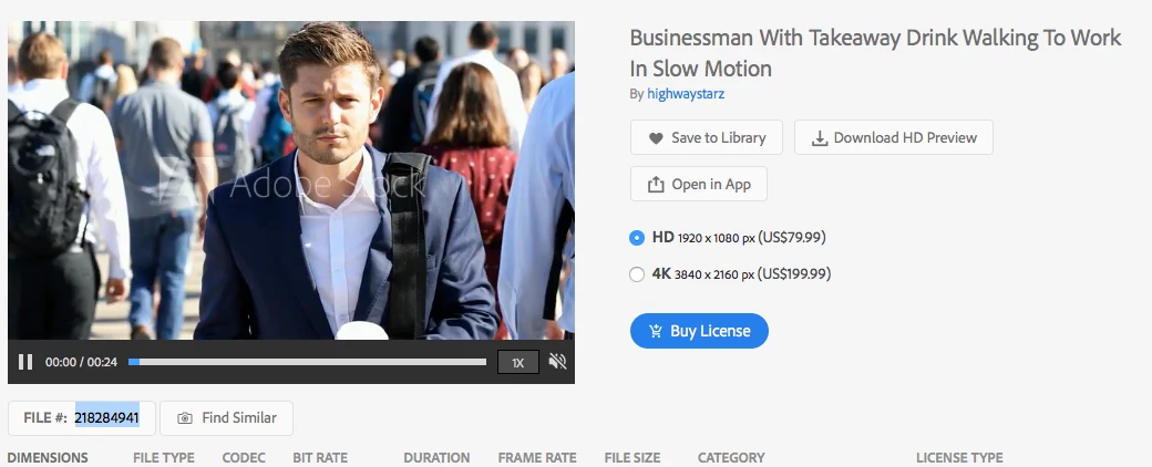

This shot from Adobe Stock is not a good candidate for camera tracking because of the lack of fixed geometry. Everything is moving:

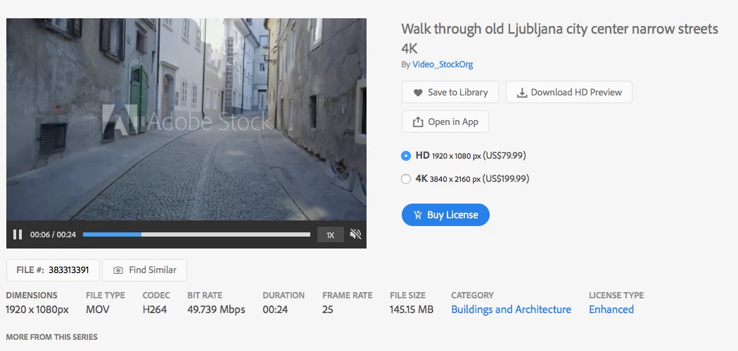

This shot, on the other hand, is going to work just fine:
You can download them for free and give them a try.
