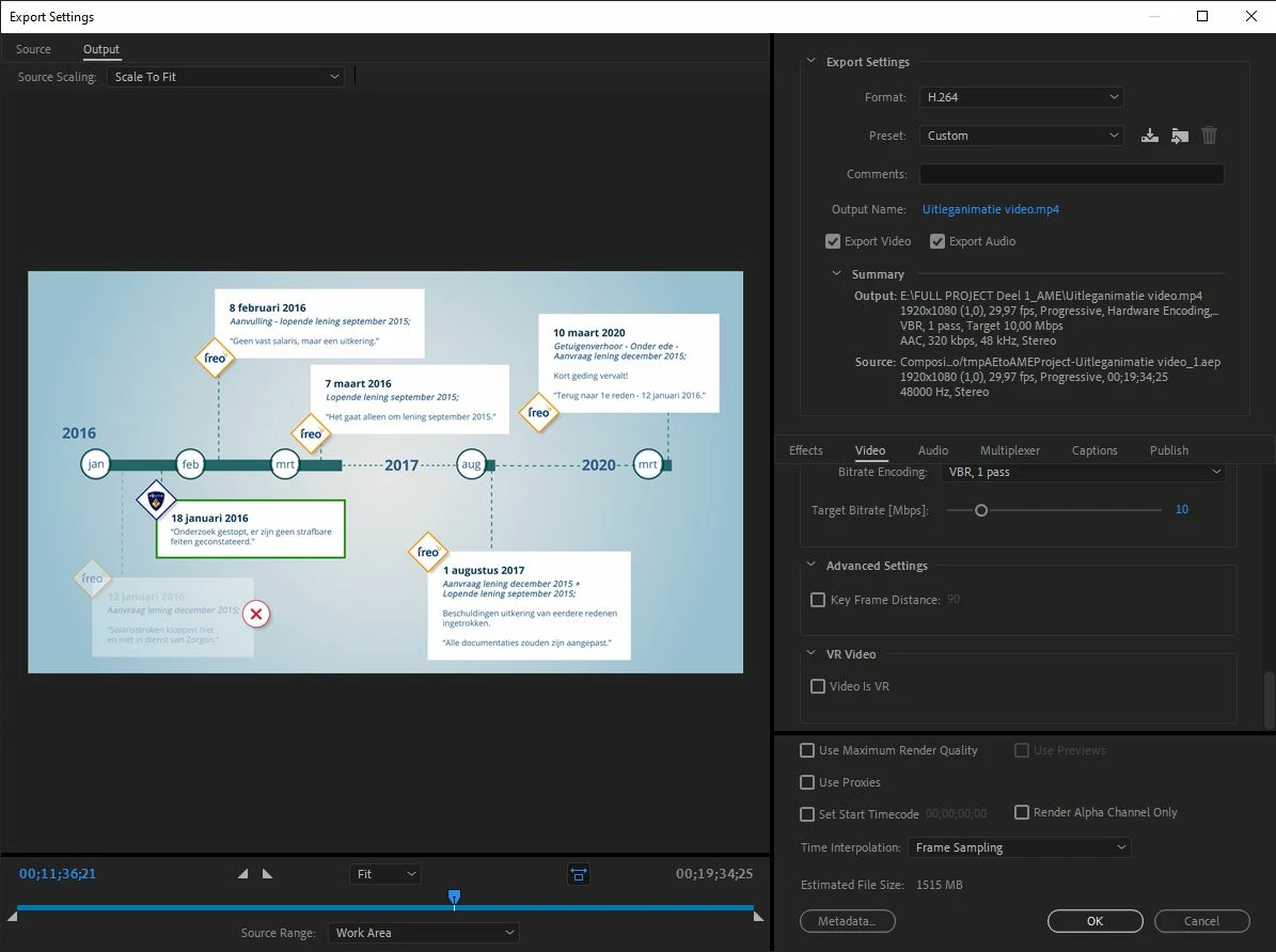

My render settings:
Format: H.264  (I also used AVI - this failed too)
Preset: Youtube 1080p full HD
I used both options software and hardware rendering (both failed)
I set the bitrate to 10 (was 16).
Video is around 19 minutes, this shouldn't be a issue because I rendered 30 to 40 minutes last week.
I also updated/reinstalled my GPU driver. I used the studio driver as the game driver from Nvidia. Both failed to finish my render.
Is their anything I missed to mention?
