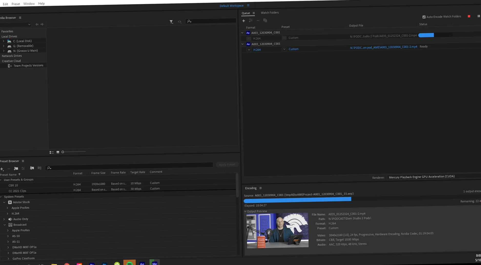

I have a simple project I have rendered in this way many times before but as we all know Abobe products love to randomly stop working and cause irreverable trouble. I have a roughly one hour video that is 4k and has a green screen. I know this sounds big but I have rendered this exact thing the ecaxt same way with half the render time. Below are my comp specs and project settings. Please advise how to lower this render time. I can provide any additional info needed.

NVidia CoDEc? Doesn't exactly make sense, given that by choosing this option you would nix all optimizations of the regular H.264 encoder and relegated all the hard work exclusively to your GPU instead of also getting the benefits of your multicore system. Unless this is realyl your intention, this would have to be the first thing to change. beyond that of course the usual applies: Your system may need a graphics driver update and some checking of the hardware acceleration options. some of that stuff has changed in the latest version.

This is very interesting to me as I have been editing for years and still am quite ignorant to the proper codecs to use and when. Could you explain this a bit further if you have the time? I always though with my new graphics card it would always be better/faster to use the GPU acceleration? Also when I set the format to h264 where would I change that codec?
