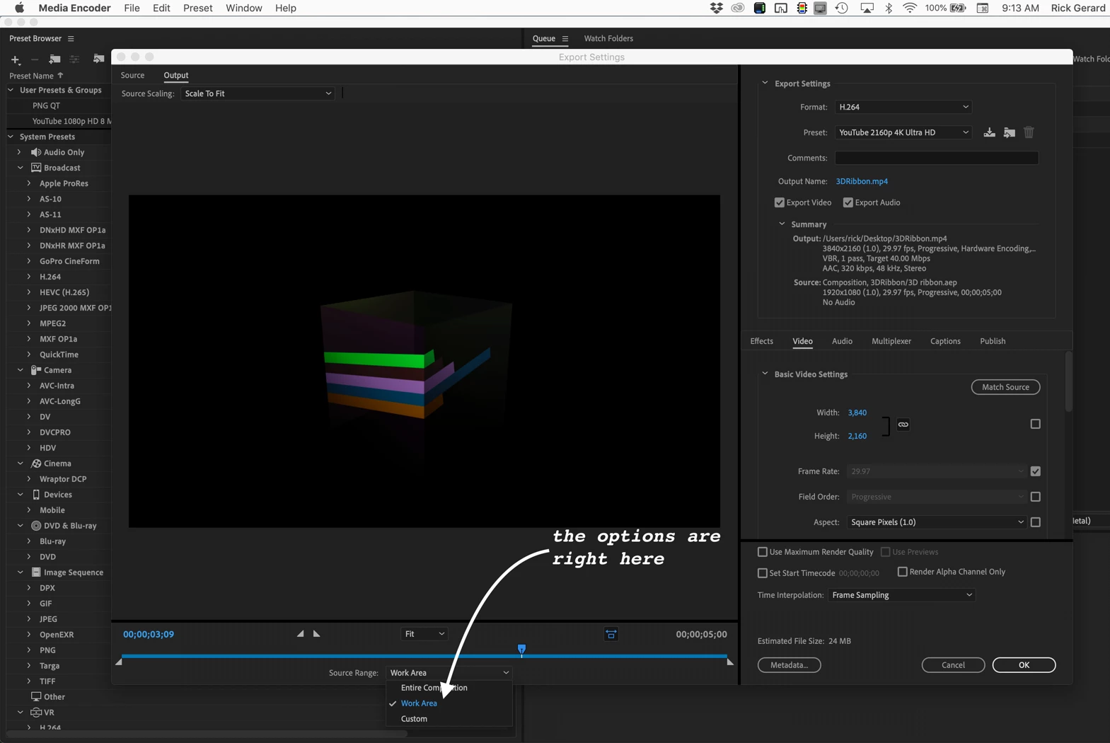

I’m assuming you don’t see any error messages during export?
Are you using a custom export preset in media encoder? Are you able to screen shot the export settings window in media encoder so I can see the setup?
May 25, 2019
You have probably set the work area to half the video, then not selected the entire video in the rendering options. You need to pay attention to the UI and make sure you see and understand everything you see there. Try resetting the work area, change the options in the Render Settings to the length of the comp, or do the same in the Adobe Media Encoder.

Sorry for the trouble. Any chance you are rendering the work area when you see only half?
If not is it the first half or some other portion of the video? Does the same project reproduce the same half render each time or is it random? Are you able to screen capture the issue?
