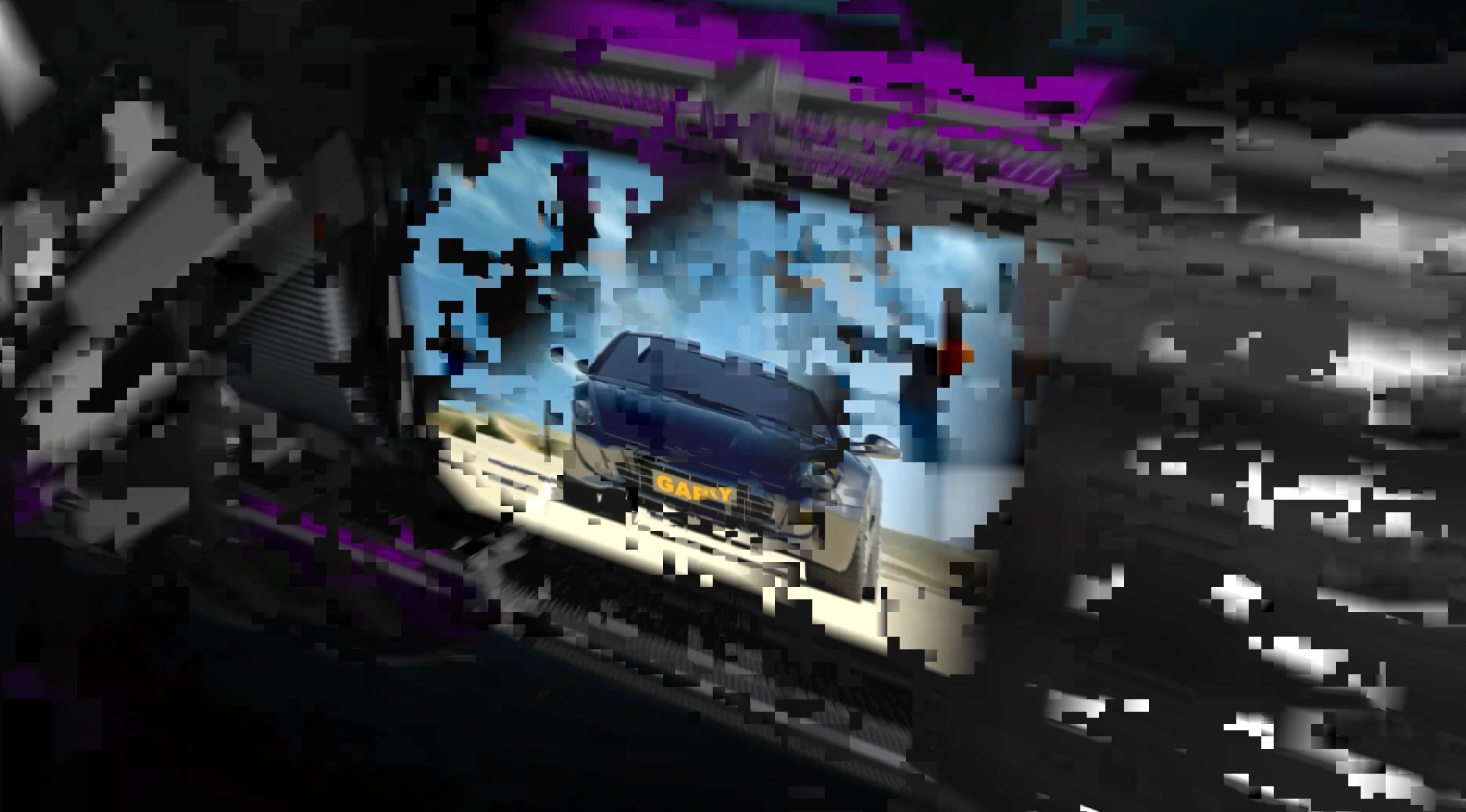

After Effects rendering POORLY on MacStudio Ultra 128 RAM since upgrading to SONOMA 14.1.1
Hello. I have an old MacBook Pro 2016 with Monterey 12.7.1. And a new MacStudio M1 Ultra with 128 Gb RAM using Sonoma 14.1.1.
The moment I installed Sonoma on the Ultra, After Effects (new and old versions) renders SO badly, I have to use the MacBook to get my work done. Naturally this slows down my work by 30 fold, and makes my M1 Ultra investment useless. Attached is a screen shot of how the M1 Ultra Sonoma is rendering with all the glitches. I uninstalled and re-installed AE of various versions to test. No improvement.

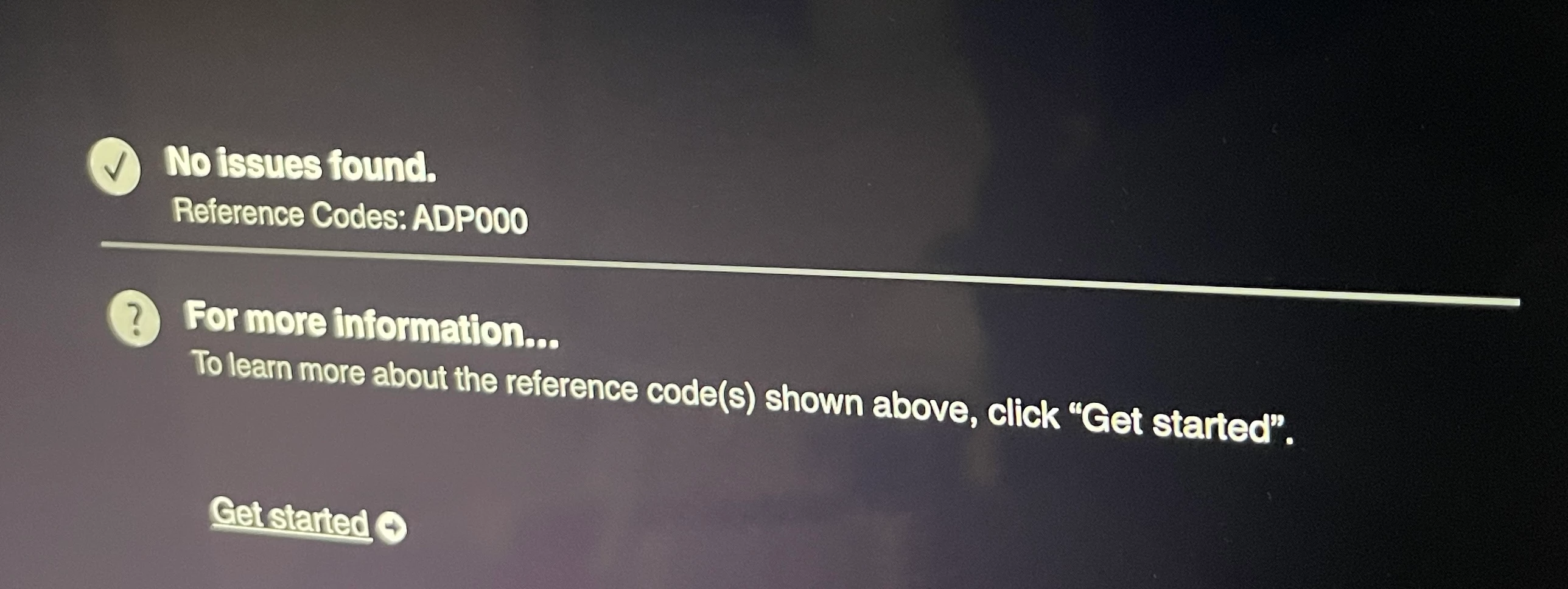

Dez. 5, 2023 1:48 AM UTC
Hello. I ran the Diasnotic test on the MacStudio. Attached is the simple test result which says, "No issues found. Ref Code ADP000".
In conducting addtional experiments last night, the problem of massive pixelation and damage is now ALSO appearing when I am using Final Cut Pro. When I skim the head across the timeline of a simple MP4 video of a simple timeline, it shows terrible results. When FCP renders out the video, some (not all) of the terrible pixelation appears (rapidly) in the output.
I do not use the MacStudio much. I have kept it in excellent condtion. The day I installed Sonoma, this memory issue started. The same issue does not happen on my older MacBook Pro using the older OS.
With FCP, one cannot change any memory/RAM allocations. So this really is now an Apple issue I think. In all my decades of design work, I have seen 'slow' machines, but I have never seen this kind of memory/refresh. Something is very wrong with Sonoma and how it can handle the simplest task. Thanks, everyone. John.
