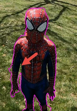

Hi I am a beginner and looking for some assistance with rotoscoping in after effects. I am using the rotoscoping tool to mask spider-man image. I want to rotoscope between his arms. I am not able to. The rotoscope keeps going inside body and it has become pointless. Should I be using the pen tool to mask spider-man.
The outcome I am looking for is to bring spiderm-man and the 6 seconds of him out of the current video and bring in a different background. If you can give me some assistance with rotoscoping or point me in the correct direction that would be great.

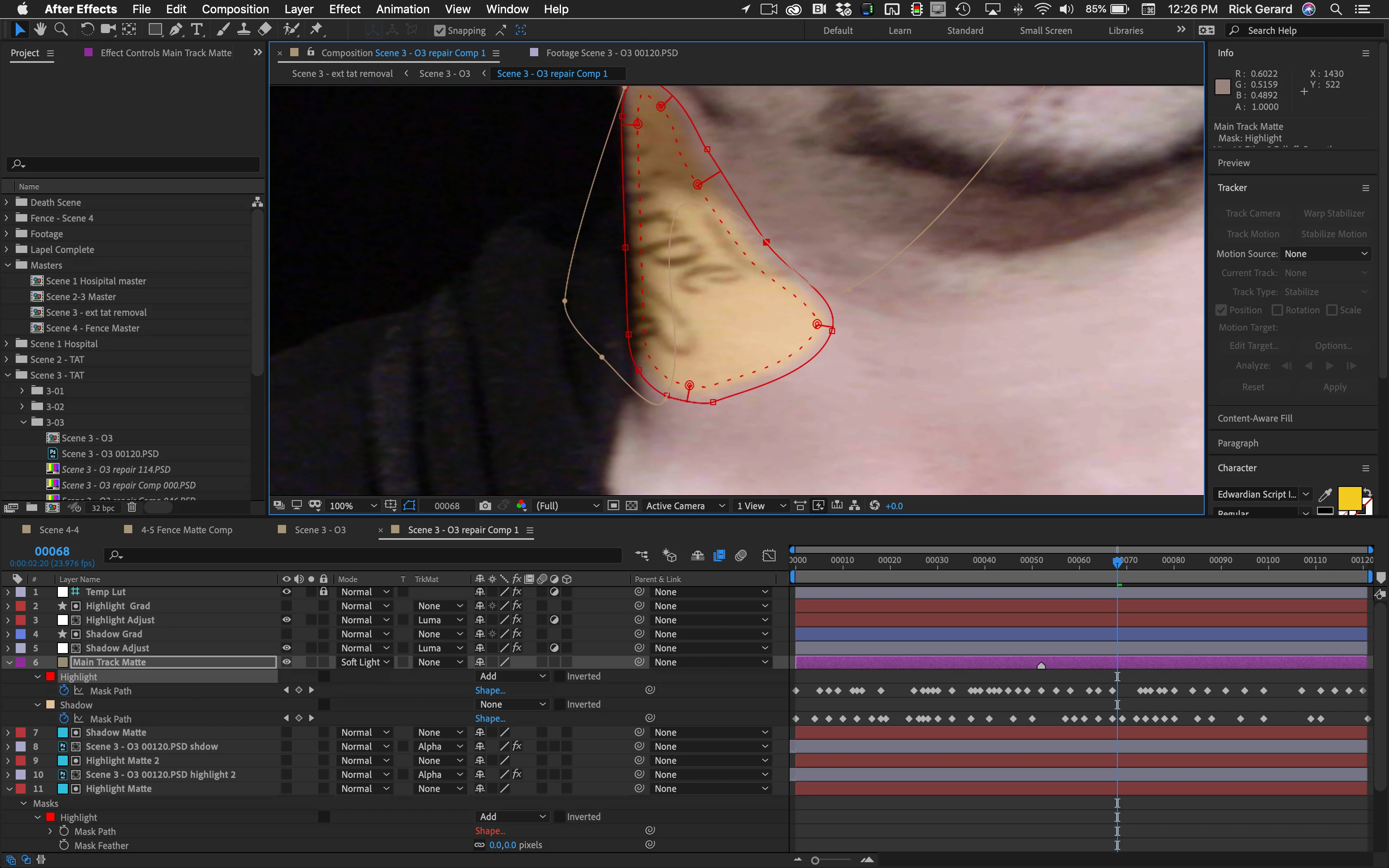

Here is a screenshot of the procedure I am using to isolate a tattoo from an actors neck so it can be removed. I have 2 masks, one that includes the entire tattoo plus a little for feathering, and another that includes just gets me the shadow. I will link these rotoscoped masks to other layers to complete the composite.
The footage of the guy with the tattoo has been conner pin stabilized and scaled up to make it easier to do the roto. Trying to do this roto job without motion stabilizing the shot and enlarging it would have takes four or five times longer than it did.

The shot I'm working on in the screenshot has a lot of keyframes because there is an awfully lot of movement by the actor and the shadows change almost every frame. It took me about an hour to do the first pass at the roto and another 3 hours to fine-tune and adjust most of the keyframes for both path and feathering to get this shot to work and it's only 120 frames long.

First, let's clear something up: "Rotoscoping" is a generic term for each and any technique used to separate and isolate items in footage. It's not in any way only referring to the Rotobrush, which more or less is an unfortunate misnomer, anyway, considering how crude and useless it can be a lot of times. That said, yes, your "rotoscoping" technique will involve masking of sorts, whether that be fully manual, assisted with mask tracking or using external tools like mocha. Having grass in an image constitutes having noise and in addition to possibly there also being compression artifacts this is one of those scenarios that can easily make Rotobrush go belly up. Unfavorable lighting with equally dark background shadows blending into your subject doesn't help, eitehr. So yes, study up on how to do it manually and muster up the patience for such a potentially tedious job, though 6 seconds is really not that much and trying to fiddle with Rotobrush may have already cost you more time than just doing it with masks right from the outset.
