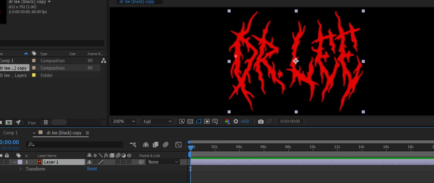

After effects shape layer not displaying color on preview
  • June 25, 2021
  • 4251 views
Sorry for the french interface,  I'm trying to animate a logo so my first step was to import my AI vector layer and then convert it to a shape layer. However, while my AI layer shows all the shapes filled in with black, my shape layer doesnt.
When selecting individual shapes in the group, the background is registered as black as you can see (Fond).
But only three of the shapes actually show up as black on my preview screen.
Is this a visual issue due to hardware maybe? As in, maybe my CPU is too old to render the preview?
Or is it a potential issue with my AI vector layer?
I've tried changing the shape layer's colors and they're unresponsive on the different shapes. Am I misunderstanding how this works entirely?
Correct answer Mylenium
You need to drill into the groups and check the path as well as any fills. And of course you will have to do soem re-ordering to do and use Merge Paths operators to get the same appearance as compound paths in AI. I would suggest you do actualyl read the online help on these things. Contrary to common belief this workflow isn't as simple as converting the AI artwork and then hoping it would work. There's more to shape layers and the workflow is considerably different from AI.
Mylenium

Hey quick update for those wanting a more in depth walkthrough.
It turns out during the conversion the After Effects created superfluous paths that mimicked my original artboard.
Deleting those fixed the issue.
