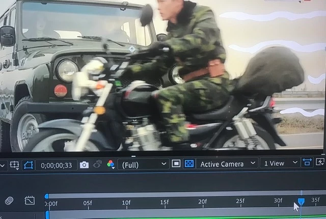

Hello, I have a 1 second clip in after effects.  I'm animating hand drawn wind lines behind a motorcycle.  The clip is 60 fps, and I drew the animations on every other frame.  The effects used are just paint and glow.  I tried deleting glow, no help.  Preview skip is set to 0.  Paint on transparent checked, and I'm painting on a copy that is above the original clip.  I've also cleared the cache and tried playback with cuda disabled.
The problem- the animations are skipping and sometimes disappearing all together.  If I let preview play on repeat, sometimes they're all or mostly there, sometimes there are a notible chunk of animation frames missing, and sometimes the motorcycle drives by with no animations playing at all.  If I stop playback and navigate frame by frame, every animation is still present.
I rendered my Premiere project that has this clip attached(dynamic link), into an h264 youtube 1080p file.  The weirdest thing is that playback through both Pot player and VLC the same exact thing happens.  The first time no animation showed at all.  Then I played through it again and there it was.  Then again but with portions of the animations missing... how does that even happen on a rendered video? lol  Not sure what to do next.

Thanks for the reply,
yes, I followed that path and selection for cleaning the cache.  The lines are actually quite thick but I did first outline them with the #5 circle brush and then filled them in with a thicker brush as I was wanting a certain look.  Is it bad to fill in with brush strokes?  I actually did another two second clip before this one and it worked fine(I would have cried if that one didnt work lol)... but i dunno.
Whats so strange to me though is that the rendered video file sometimes plays with the lines and without.  If the frames are painted on, where is it getting the clean frames??  lol
