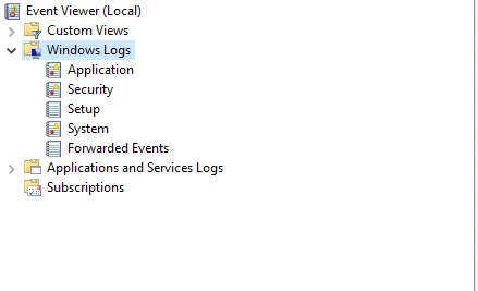

Perhaps someone knows a way to see a log file somewhere so I can file a proper bug report to Adobe?

Mylenium
November 20, 2022
System and Application, apparently. Filter it for AfterFX.exe or critical events with a red warning sign.

Crash info for app hangs appears in your Windows Event viewer and that's what we would need, anyway, to even come close to a diganosis of the whole issue. that said, the freezes being totally random most likely indicates an issue with your harddrive or a sub-process of the whole Adobe shebang being blocked/ killed prematurely, so that would be the first thing to check. Have Task Manager open while AE launches and monitor the behavior of the individual processes  and graphs. Something is going to spike and that most likely relates to the faulty process.

Thank you. Would you be so kind as to tell me which part of the Event Viewer should I be looking at?
