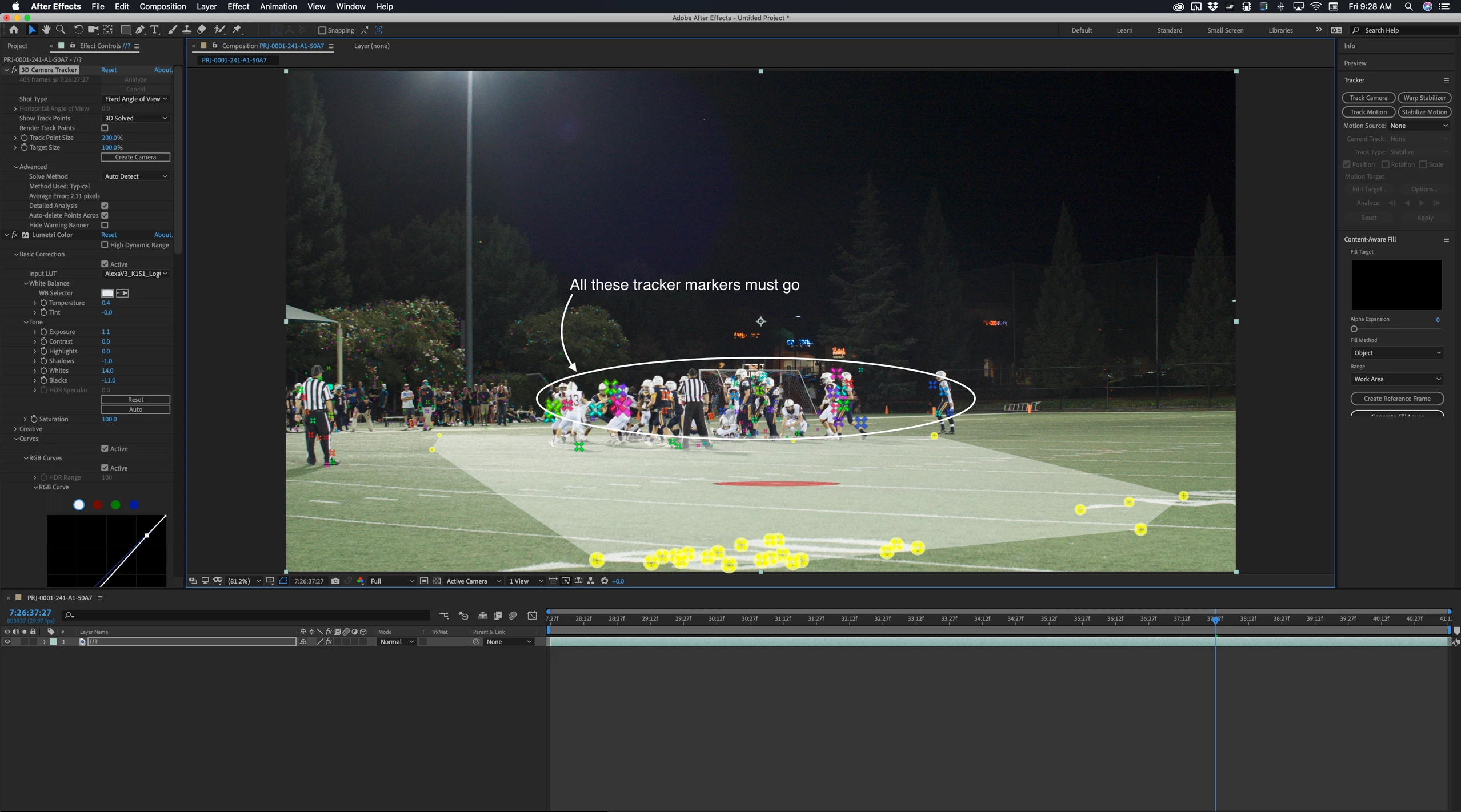

    I hope this helps. Maybe this screenshot will also help. JR football at night, MoVI Pro + Segway for moving 4K footage at 120 fps for some slow motion. The first solve was terrible because of all these markers on the players:
    Even though I could get what looks like an accurate target on the field all of the markers on the players fouled up the track. After Deleting the markers on the players by dragging a selection around all of them, and setting my origin and ground plane I got a really solid track from the shot that was giving me a lot of trouble.
