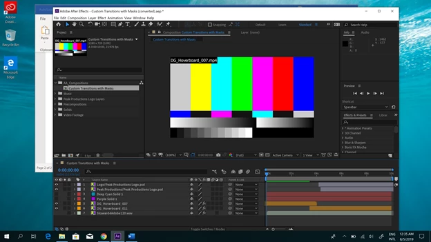

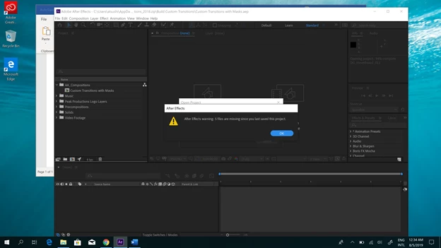

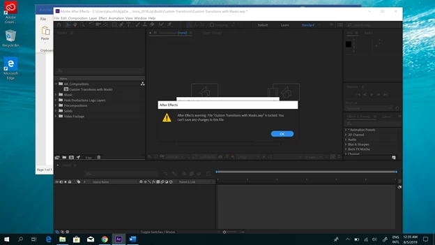

    Hi thank you for the messages.  Here are screen shots to show my problem below.  The same problems are happening when I download the files from this site.  Thank you for any suggestion to fix!
    David ArborCorrect answer
    August 4, 2019
    Thanks for posting those screenshots. The first message is simply telling you that the file was made in an older version of After Effects and it will be converted for the version you're using—this is a very common message and there's nothing wrong with it.
    The error you're seeing about missing files indicates that the footage isn't in the location the project expects it to be (because it was saved and organized on a different machine). Color bars are how After Effects indicates offline footage. All you need to do to fix this is find any one of the pieces of footage that's missing in the Project panel (you can go to the search bar at the top of the Project panel and type "missing"), then Right-click>Replace Footage>File. This will bring up the Windows system dialog box where you will then navigate to the location of the downloaded media, select the corresponding asset, and After Effects will relink it. If you didn't reorganize the rest of the downloaded files then it should also automatically relink the other assets.
    August 10, 2019
    Thank you for your suggestion.  It worked!
