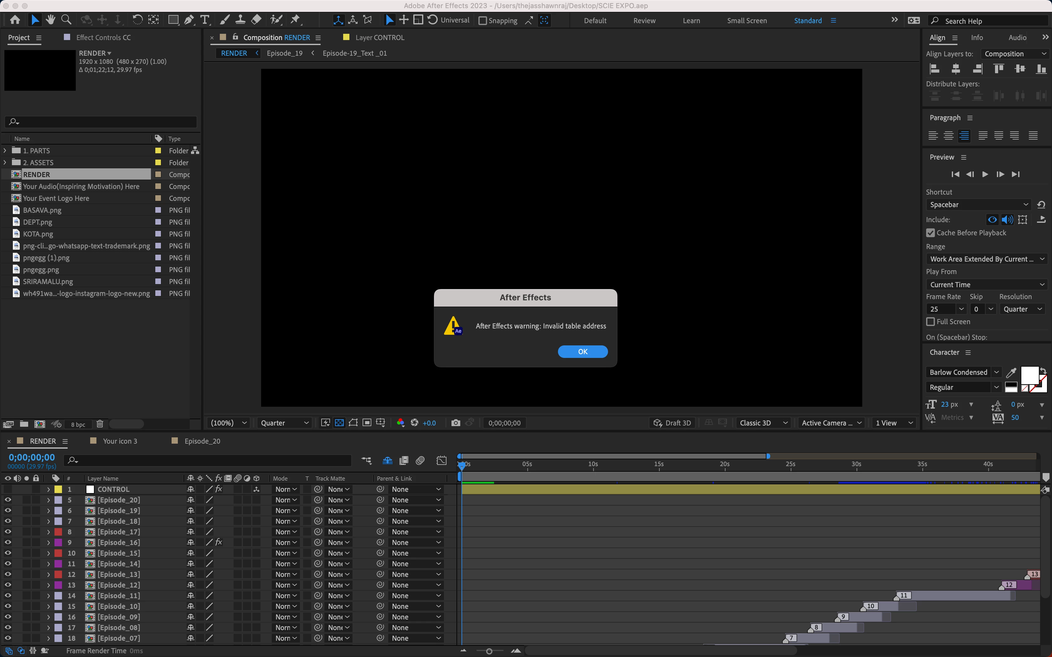

After effects warning : Invalid table address
I cant able to work everytime while playing the message pops up "After effects warning : Invalid table address"

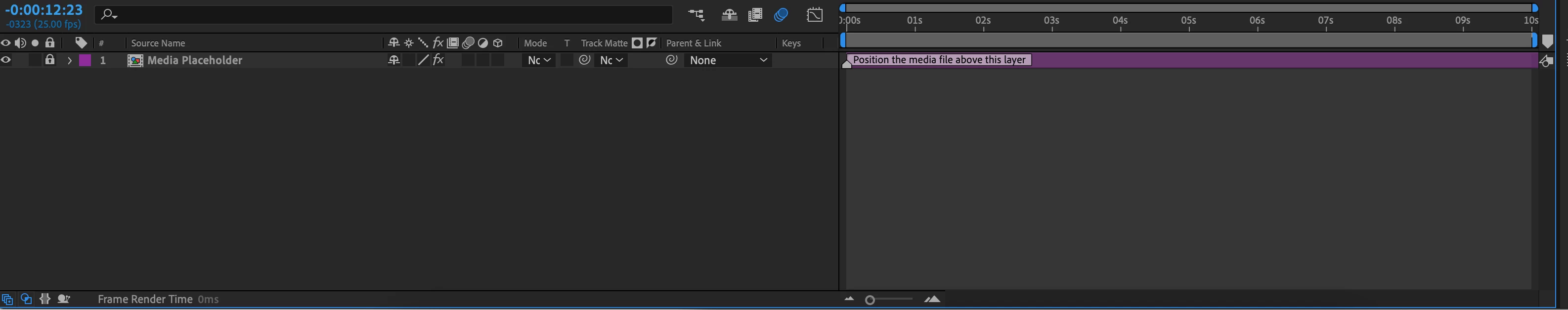

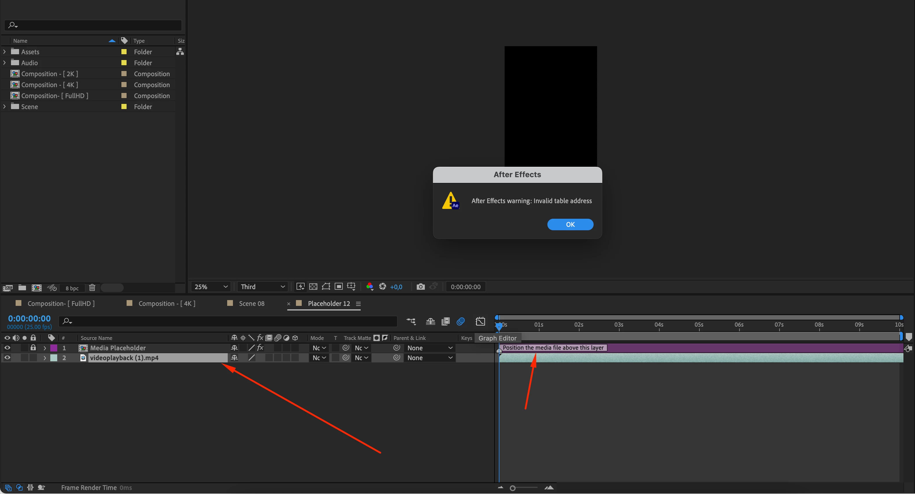

I found out the reason for this error. I honestly don't understand why this is happening.
I have a locked layer with numbered placeholders. An error with the address of the table appears if I put any file on the panel under this layer.
Solution: move all layers above the locked layer.

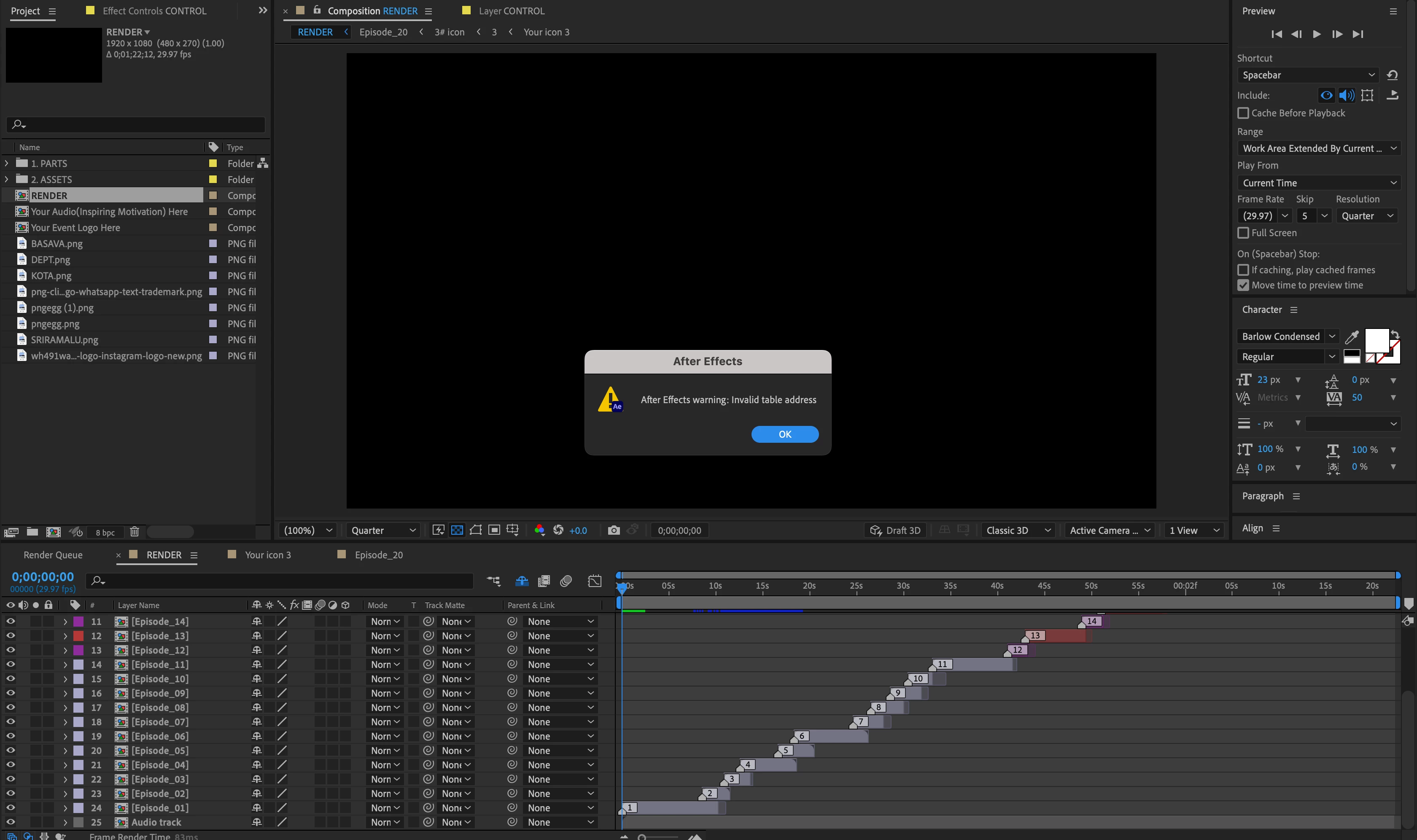

whenever i start previewing the message pops up saying "After effects warning : Invalid table address" what is that means. for more infor i have attached some files
