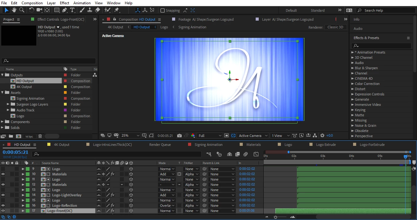

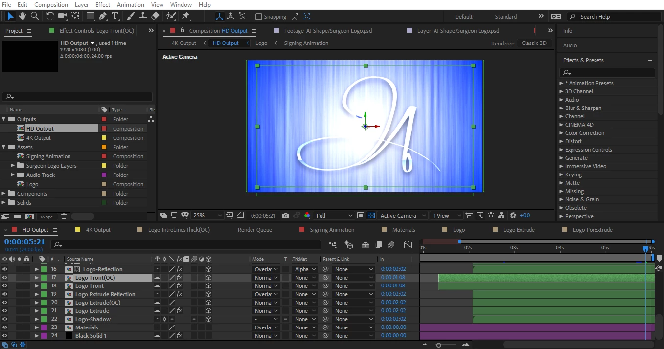

Hi. In After Effects I imported a PhotoShop Shape (Script Logo), then I made a bunch of controllers, extrusion, etc. After I render all, everything was fine. A reflective 3d script letters with a slogan.

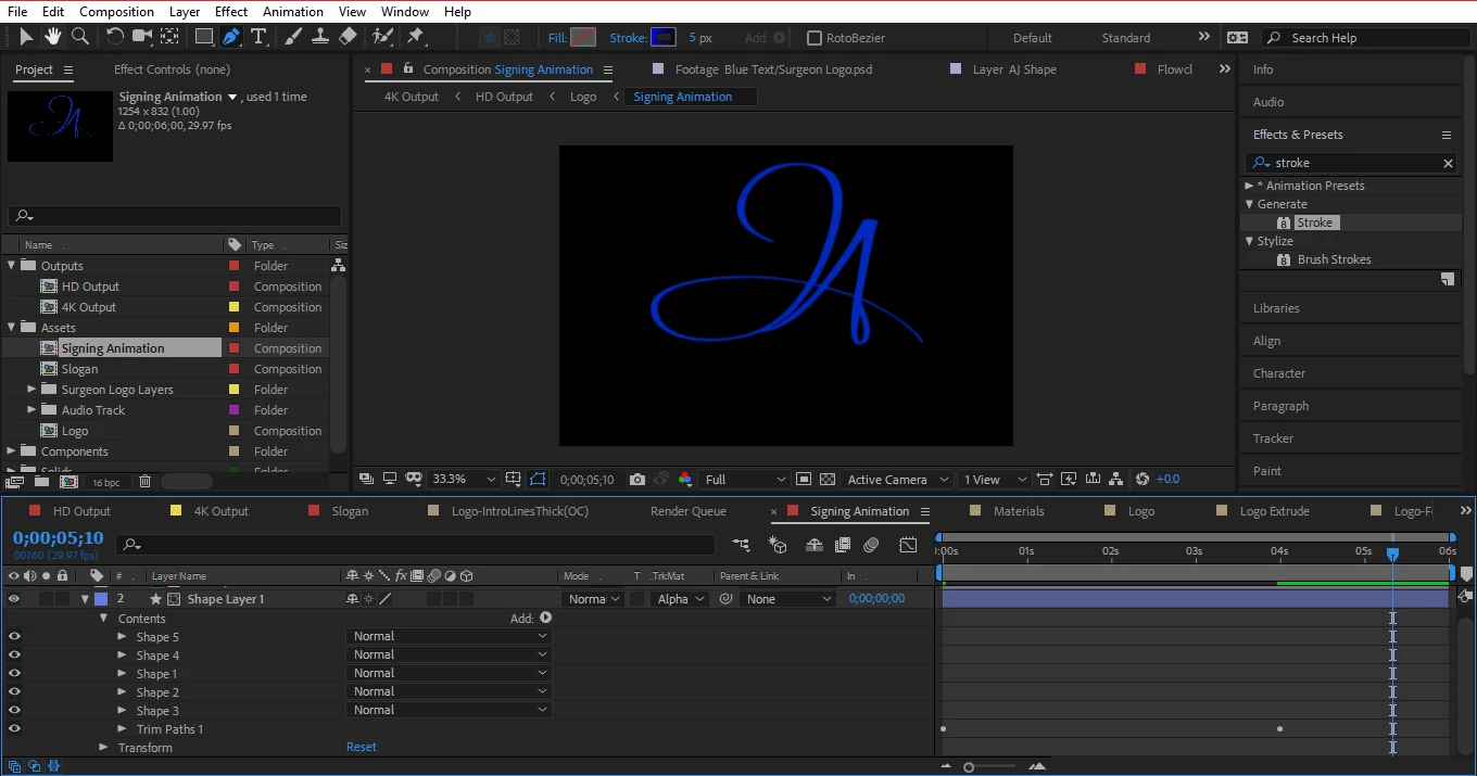

But then the customer changed his mind and told me he wants a version of the logo without slogan/name (only Logo's Icon) and the logo to appear like someone is signing. The comp that is connected directly to Main Output for rendering is called "Logo" (the one with all the controllers and effects). "Logo" have inside a comp called "Signing Animation". Inside of "Signing Animation" is where the PhotoShop shape (with 5 maks) is now. So I made a Shape Layer below that PS Shape and ended up with 5 shapes and a Trim Path inside that new Shape Layer's content.

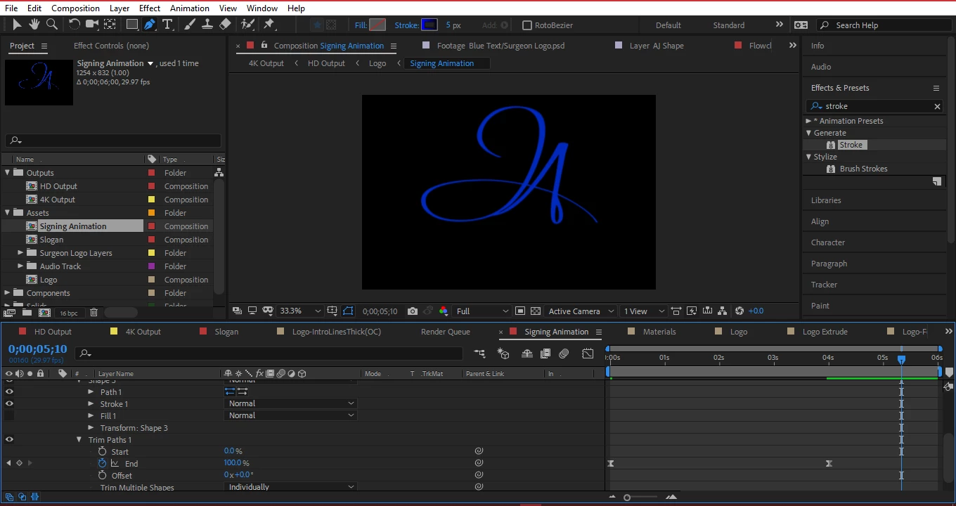

The trim path is animated with end 0% at 0 seconds and 100% at 6 seconds. The "Trim Multiple Shapes" is set as "Individually". This 5 shapes have stroke and fill effects inside each of them. The 2d shape now makes a signing animation similar to when you animate a stroke and choose to reveal original image. Note that the Shape Layer have a Track Matte to Alpha AJ Shape (the PS Shape) that is now disabled so that only the Shape layer 1 is shown. And I used that Track Matte so that the stroke has the same smooth shape the original PS shape has. The animation seems to work for now when previewed inside this comp called "Signing Animation" that you can see in the following image.
Now when going to Main HD Output, I expect to find something like the first image I attached in this post. But instead, I get the following result:
Only the reflections, shadows, controllers effects, etc are shown and a bit of blue in the first part of the animation (upper left side of the script letter J). The Shape layer's blue color and extrusions etc. are not there, just a clear/transparent mess. I'm used to work with PS and Premiere mostly, so I'm AE newbie, Plus I installed a new version of AE and now I'm lost in this part. Did I mess up somewhere inside "Signing Animation" comp or in another place (controllers, effects)? Can it be something related to "Collapse Transformation/Sun Icon" which is grayed out for my Shape Layer 1? My customer is waiting for this logo intro and I'm stuck now that the whole work is finished. English is my second language, so... sorry for any grammar problem.

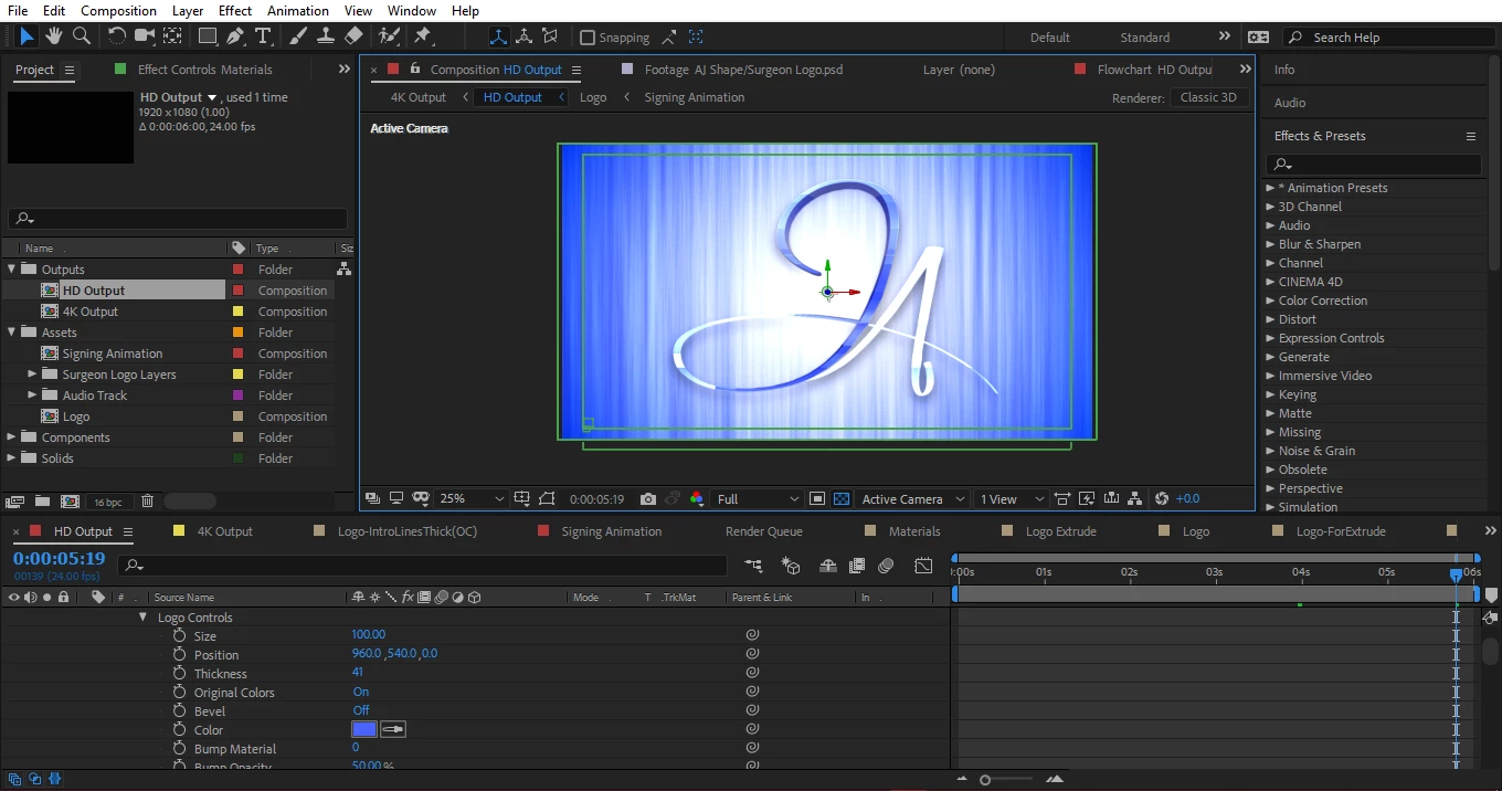

Ok, when I solo the problem layers, nothing is shown. All the extrude and front layers are the ones giving me problems. This ones...
When I disable the Animated Trim Path, the shape layer looks fine at the Output but then is not animated.
I should write the question now "Why does an animated Trimpath render my Shape's 3d extrusion invisible at Output?" This is how my Trim Path is set inside of "signing animation"...

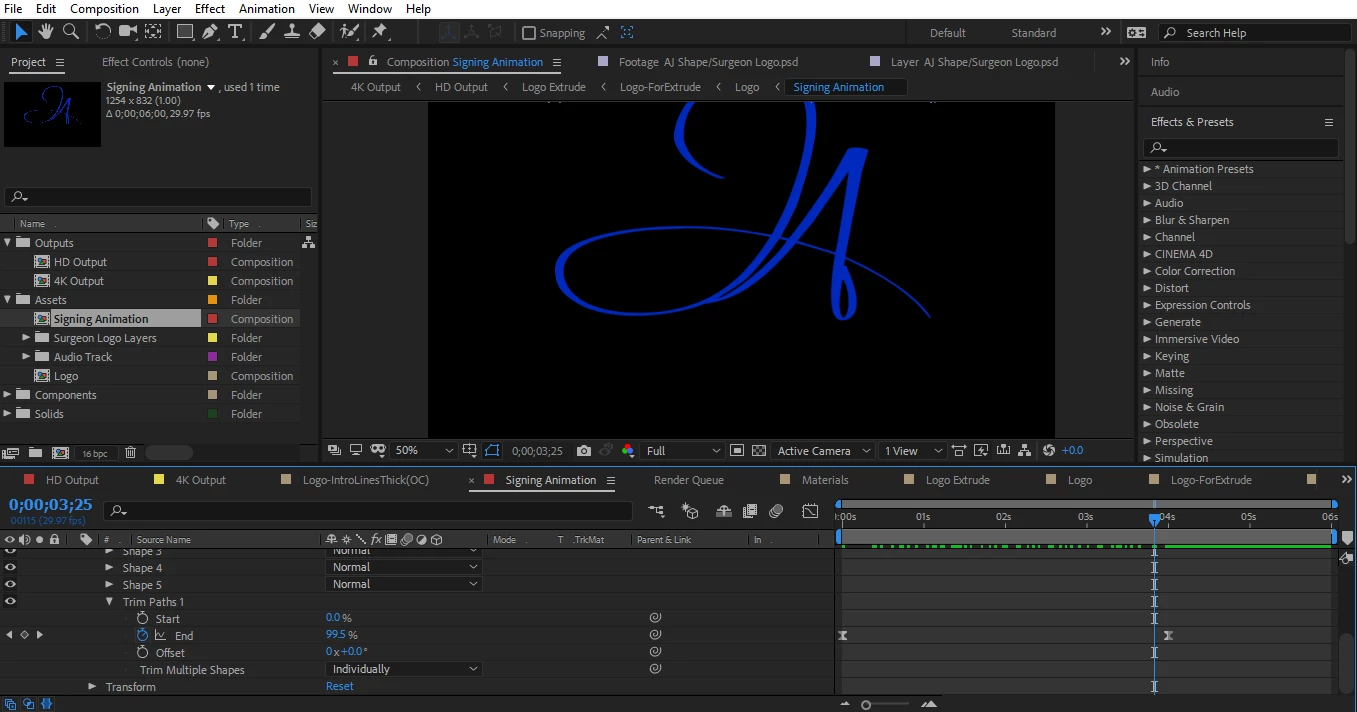

You think that maybe it has to do with something about my 3D Renderer? The key is to find how a Trim Path can affect 3D shapes. Also when I use the controllers to increase extrusion thickness, part of the logo's Extrusion and Front start to show up. But that's not a solution because my costumer don't want this logo really thick. In here I increased thickness from 7 to 41 and this happened. Part of the logo is shown in output. Only part of it, even if the signing animation is almost over...

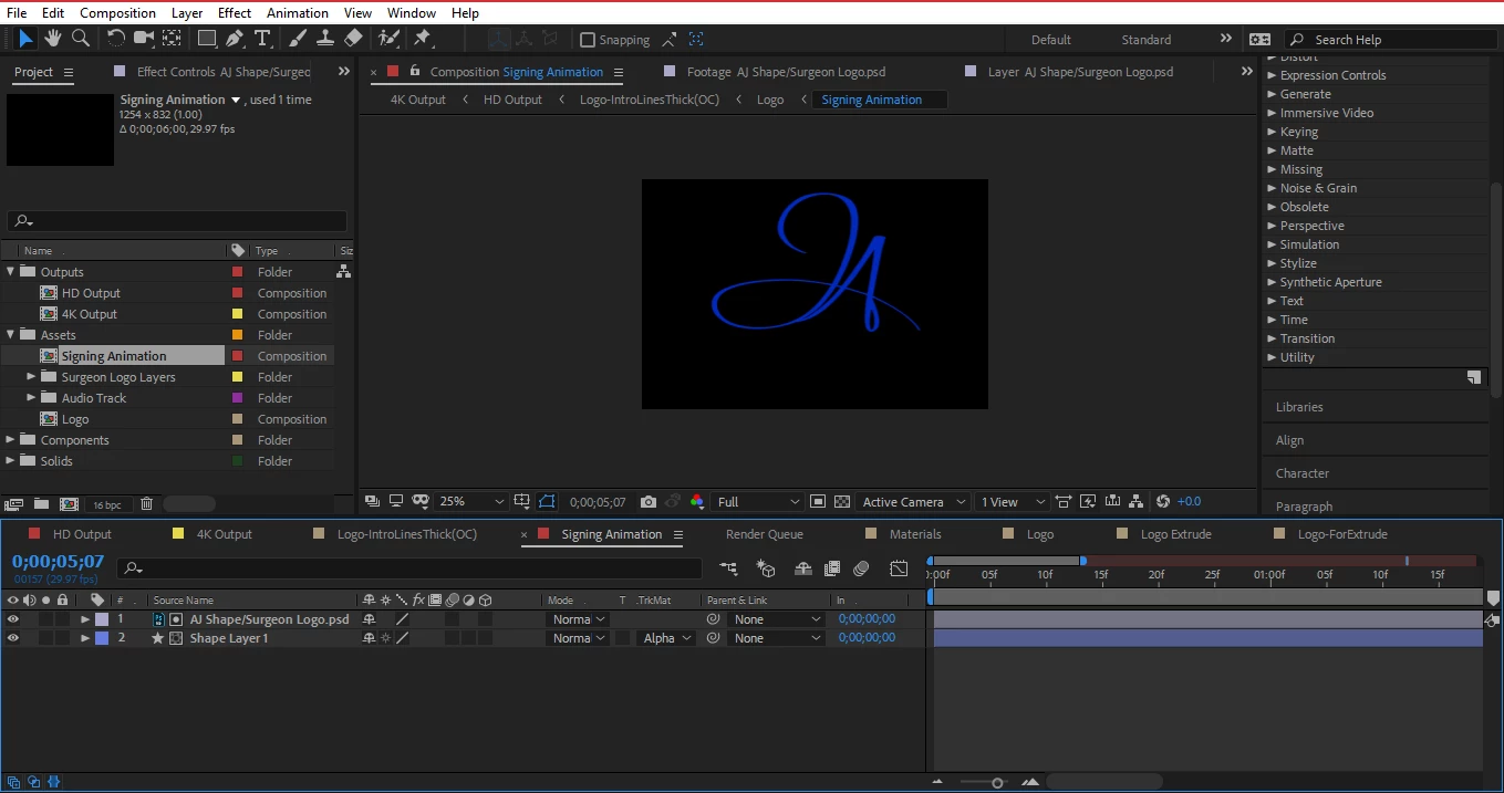

But when I enable the PhotoShop Shape (AJ Shape/Surgeon Logo) inside "Signing Animation" comp (Which is in "Logo" comp), then it would look fine and I can render good, but then it wont be animated, because the PS shape is in front of the animated "Shape Layer 1". If I hide the PS shape, then is animated again, because Shape Layer 1 is the only one shown, but then that same shape layer, which is in "Signing Animation" which is also in "Logo", won't show all the effects like the PS shape used to. They're both inside the same composition "Logo" (The only one linked to the effects, not its children.), which confuse me about why they behave differently being inside the same stuff.
Here I enabled AJ Shape(Original PS Shape)
Now when I go to output, everything looks fine, but not animated anymore (maybe shape layer 1 is being animated behind the PS shape).

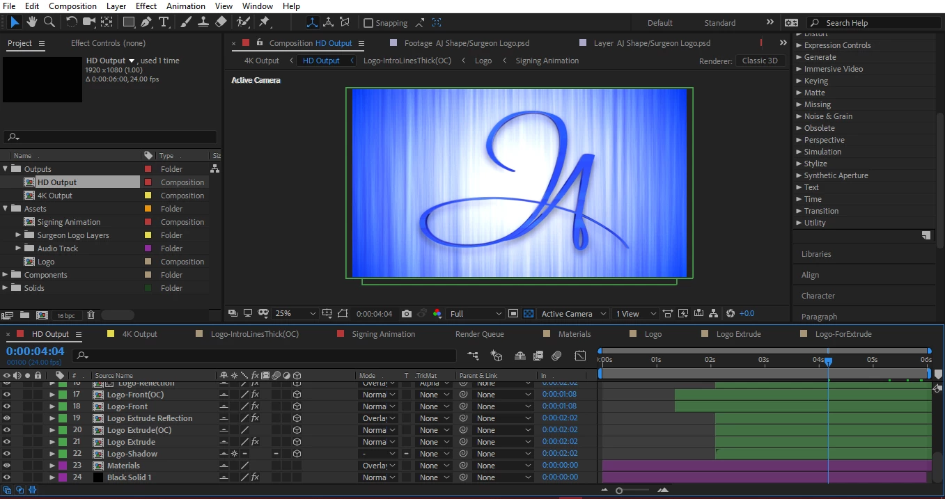

Look like you have apply some blending mode to your shapes layer or so, and it's not clear in your screenshoot and you clcik the collapse transformation for you Signing Animation comp, please check if you have blending mode and try to post better screenshoot show us all the layer specially on the HD-Output try to remove the shy button to we can see your layers structure
Phelionyx
PhelionyxAuthor
October 18, 2018
Thanks, Ok...
1. On the 2nd screenshot that I provided is shown that "Shape Layer 1" blending mode is Normal, as well as all 5 shapes inside (normal).
2. Now, because I paused that work for a significant time waiting for the customer, I forgot that I had enabled the general shy button (Hide all shy layers). Now reading your answer made me remember about that button so that I can provide a better screenshot.
3. For "shape layer 1" the "collapse transformations" is enabled and greyed out. I can't click on it. Note that the PS Shape is hidden to only show the Shape Layer being animated. The PS shape looks complete and fine in output (like the first screenshot I send earlier) when not hidden, but the "shape layer 1" don't get the same result in output.

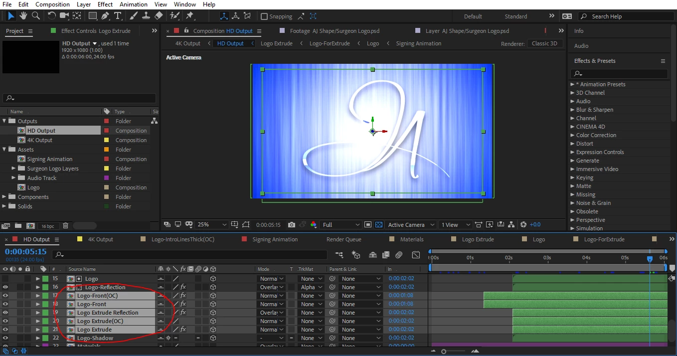

Now back to the HD Output Comp, I took 2 screenshots from Logo to below (the whole thing don't fit on 1 screenshot), because that's where the problem starts at 2 seconds and ahead.
Reflections have blending mode of overlay and light overlay have blending mode of add. Note that the light overlay and reflection have track matte to "Logo" composition so that only that shape have reflection and light. Note that at the preview window, the shape no longer shows the extrude and front of shape neither. It just shows the reflection and light overlay. Also, see that on that screenshot, "Logo" appears 4 times but hidden because if enabled they would look plain 2d like in original "Signing Animation". They're there just for 2 Materials, Light Overlay and Reflection's Track Matte. I want Logo-Front(OC), Logo Extrude(OC) and Logo Extrude Reflection, to affect the JA Shape coming from "Logo". I tried putting more "Logo" copies above each of those 3 effect compositions that are not showing for the JA shape animation, but they still don't show. After those compositions shown on the screenshot, the following are the compositions that remain:
