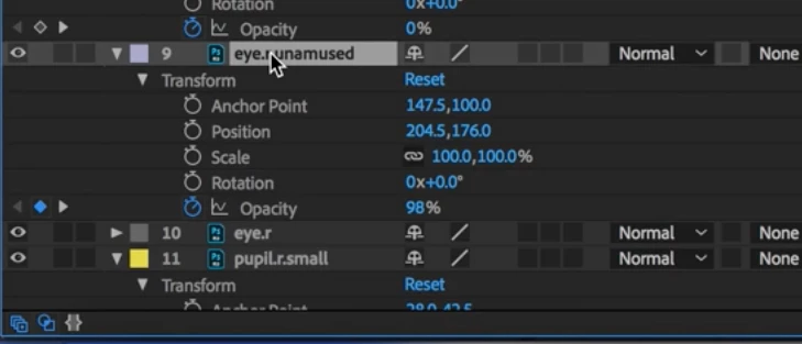

So basically this is something I’ve noticed a couple times in After Effects. I’ll have a layer that frequently changes from 0 opacity to 100 opacity at different frames. However, when I go back and rewatch my video, I notice that at every frame it should be at 100 opacity its been sifted down to something slightly lower like 98 or 96. And sometimes it shifts the 0’s up to like 4 as well and idk how to avoid this problem or fix it without editing every other keyframe. most times its only at the frames its supposed to be at 100 that its been shifted, the zeros more times than not are untouched! Can someone explain what the heck is going on??

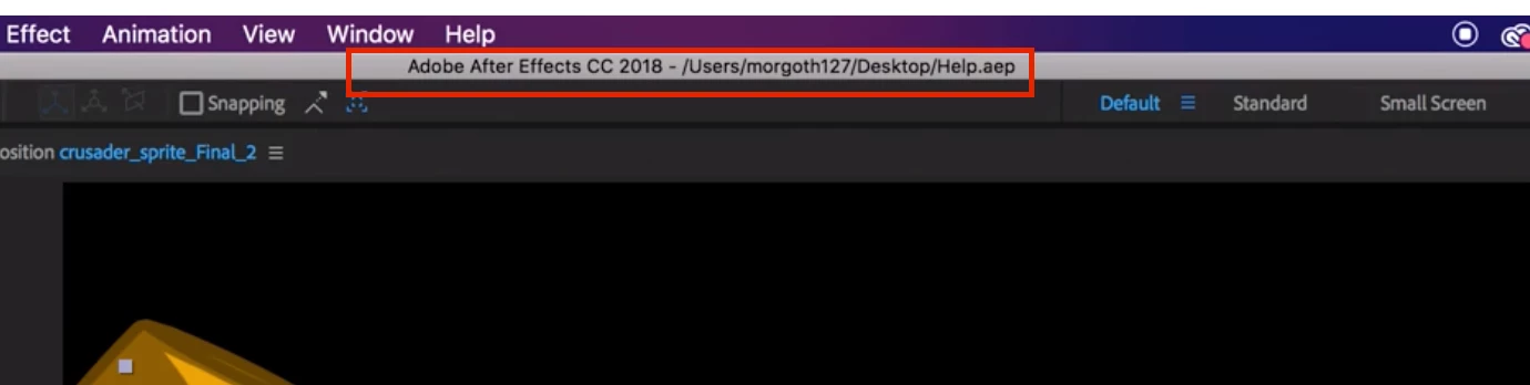

Maybe you don't notice that but they already use CC2018 and they think to upgrade to cc2019 but i'm almost sure it's not a release issue, the best reason to have this issue is when you change the frame rate of composition (but eve this can change the value before or after the keyframe and not the keyframe it self), and the best solution is by convert keyframe to toggle hold keyframes.

Hi sorry didn’t notice the version. In any case thie value change in opacity should not be occurring. I don’t see any frame rate changes in the video the OP posted and he is using pas files which are static images which won’t affect frame rate. The only other possibility is that frame rate was changed during the course of the project that’s not evident on his YouTube clip.

UPDATE! so I went back and fixed everything, changed all the 98s to 100s......went back to rewatch...AND NOW ALL THE 100S ARE 97!!!! WHAT IS HAPPENING!!!

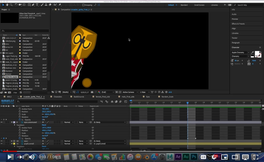

here's a video of the issue
HELP ME - YouTube
