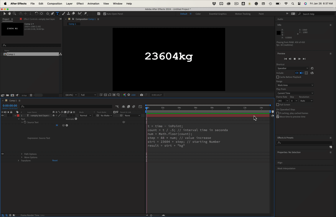

I'm trying to find out if there's an expression that adds up every X images?
The problem:
A machine that 2 times per second will increase its value by 88kg.
In other words, a calculation that would add the imposed figure of 23604 by 88 every 12 images.
As I couldn't find this calculation, I did it by hand ^^, but I'd still like to find a less restrictive solution.
Thanks
Jan 26, 2024 1:42 PM UTC
If you start by subtracting the layer's inPoint from the time, then divide that number by the interval and use Math.floor() to keep the value a whole number, you will get an even number multiplier you can use to add that value to a starting number. The expression is fairly simple. Add it to a text layer/Text property and you have your counter.
t = time - inPoint;
count = t / .5; // interval time in seconda
num = Math.floor(count);
step = 88 * num; // value increase
strt = 23604 + step; // starting Number
result = strt + "kg"
To keep the numbers from bouncing around, you will need to use a monospaced font like Courier;
Jan 26, 2024 4:30 PM UTC
Thank you very much! It works perfectly 🙂
