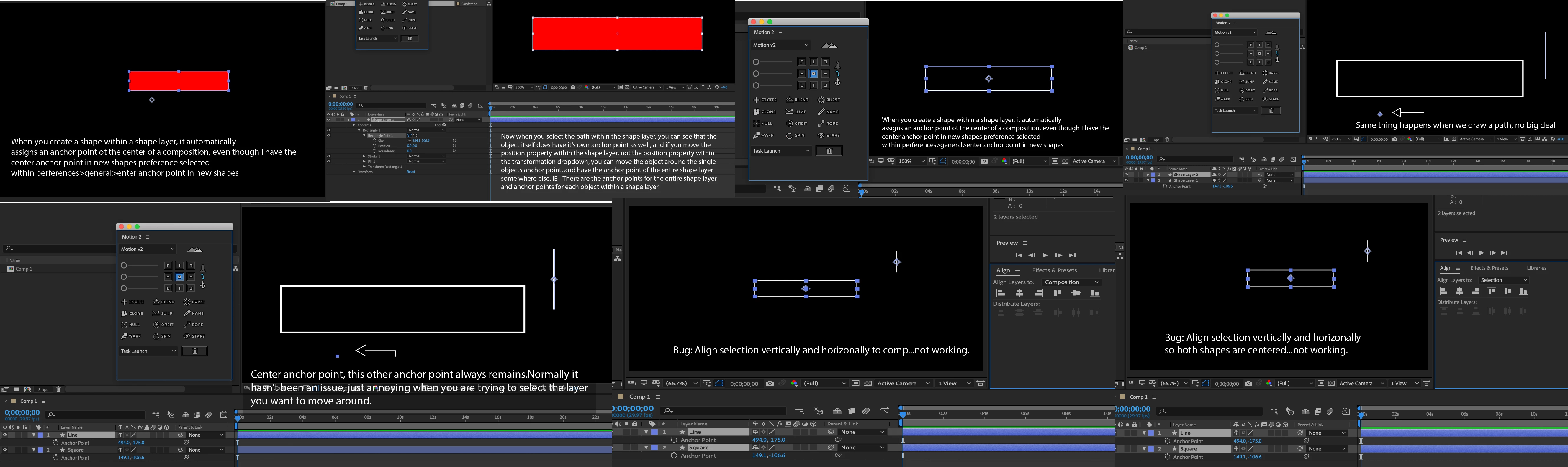

Anchor point centered, but align tool not working
Having an issue where after alining the anchor point to center on a line path, there is still a mystery point at the center of the canvas resulting in an issue where the align tool isn't working correctly. It is trying to use the myster point rather than anchor point. You can see the anchor point is centered on both objects, but the align tool is aligning them incorrectly.
How do I fix this? It hasn't normally been a problem but now I can't seem to get it to work today.

    Here is the issue explained in greater detail:

    If you select two objects and use the align tool, it's default setting is "Selection", instead of "composition". So you are centering both object to each other, instead of both to the comp center.
    Just can change this in the dropdown.

    That isn't the issue. The anchor points are centering correctly on the shapes such as a square, circle, or star. However anything that I'm drawing with the pen tool on a shape layer there is the initial anchor point at the center of the composition, then after using a center anchor point script you can see the anchor point moves to the center of the shape, but for some reason it is still using the original center of composition anchor point for aligning the shapes. Regardless of whether I choose align selectio or composition this is occuring.

    根本的な解決方法ではありませんが、スナップを利用するか、または、スナップを利用できない状態で整列を実行する場合は、2個のアンカーポイントとシェイプをコンポジションの中央に配置します。
    (手順)
    1. トランスフォーム/アンカーポイント の値を トランスフォーム・シェイプ/アンカーポイントにコピー&ペーストします。
    2. アンカーポイントツールのアイコンをCtrlを押しながらダブルクリックして、アンカーポイントをコンテンツの中央に配置します。
    3. 以上でシェイプとアンカーポイントが中央に配置されるので、整列が利用できます。

    How many layers do you have? I suggest you include a screen grab of your Timeline, to allow us to have a clear look at the layer(s) involved.

    I was having this issue within a comp with multiple layers, but I started a new composition to double check if this would happen in other compositions. The above image is a new comp with only two shape layers. One with a Square, and another with a simple path drawn by the pen tool. I double checked within the shape layer in question and there isn't any accidental points, just the single path.
