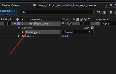

Nov 26, 2024 3:30 PM UTC
Thanks for sharing the details. I see what's happening here.
When you move the object right after creating it, notice that the shape (rectangle, star, whatever you created) is highlighted in the layers panel (screenshot). When the shape is highlighted, it will move only that shape, and the anchor point remains where it is. If you click on the name of the layer to highlight it and move it, it'll move the layer and keep the anchor point in the center of the shape.
Hope it helps. Let us know if that doesn't fix.
Nishu
