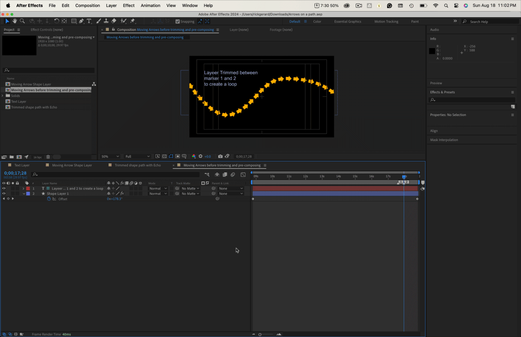

Aug 19, 2024 5:05 AM UTC
I don't have time to do a tutorial, but I did create a project file for you that shows how I would use Arrows from a text layer and also how I would use Trim Paths and taper to create a moving arrow, apply Echo, find a looping point in the timeline, then trim and pre-compose the trimmed layer to use time remapping and loopOut().
I hope that is enough to get you started.
Note: The GIF's frame rate makes the yellow arrows look like they are moving backward, but in the Comp, they move in the right direction. I hope this helps.
