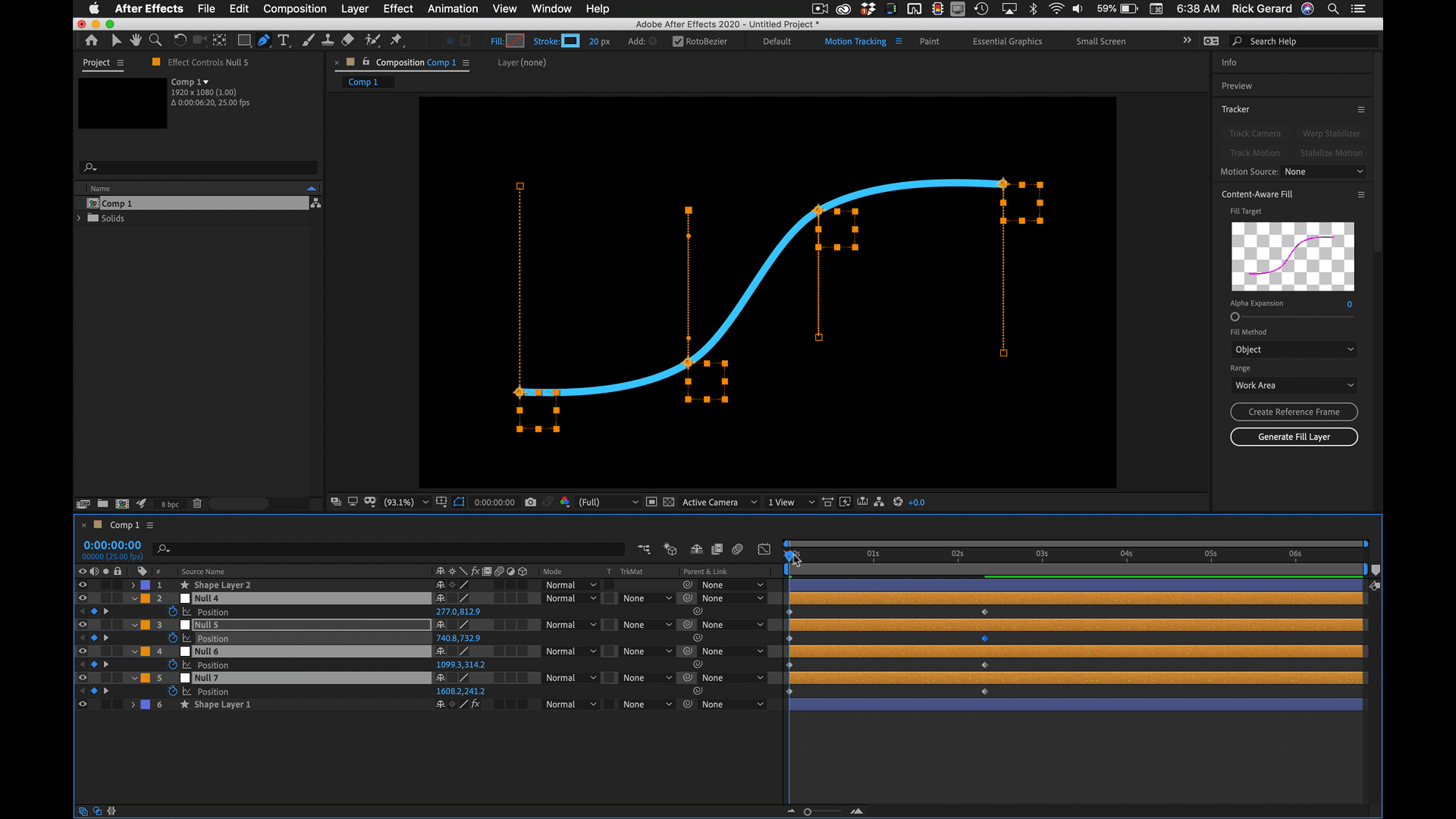

For something like that I would use the Create Nulls from Paths/Points Follow Nulls script, have the path set to rotobezier and then animate the position of the nulls. Just draw a straight line with 4 points, run the script, then animate the Y position of the nulls. It will take about 2 minutes:
