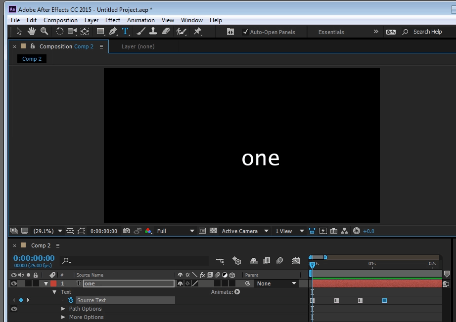

February 1, 2017
how about manually changing the source text with keyframes? is that a problem? if it is, maybe be more specific on how random is it supposed to be because it seems you want full control so might as well do this manually.
