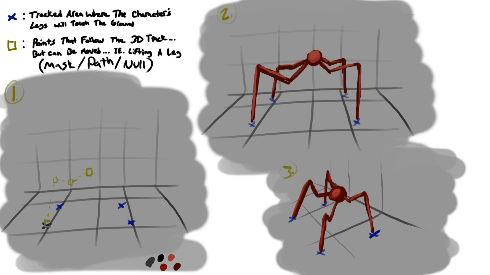

     Hi, I'm working on a project in After effects with Trapcode Tao. I'm basically creating a (kind of abstract looking) creature using Tao on top a video that will have a small amount of camera movement. The character needs to remain tethered to the 3D track... But I also must be able to make some simple adjustments to whatever path Tao is following (i.e. A leg taking a step).
     I guess my big question is ... What is the best method of creating a 3d path, that can be adjusted throughout the scene, and be followed by Tao. I'm pretty new to AE so any help is much appreciated! Thanks for your Time!!!

Thanks for the help and fast reply guys! I dont think i will be able to use paths in the way I planned. I wanted to us a path because TAO can inhabit the path as if it were just a line. The problem is... a path (at least as I understand it) is a point animated with keyframes to move throughout the course of the video. I dont think i can move a point of my line... because its not really a line. Or am i wrong?
I would like to use null objects do define my "joints"... but i still need something that TAO can follow and be connected to the null objects.
